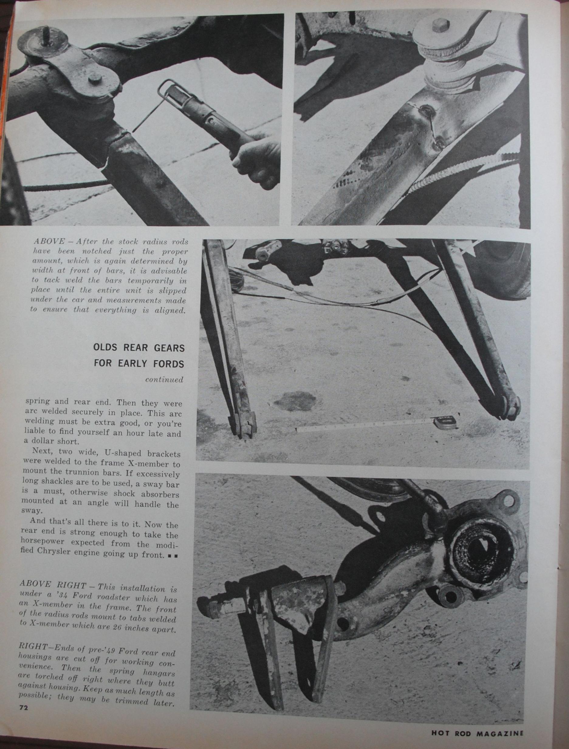

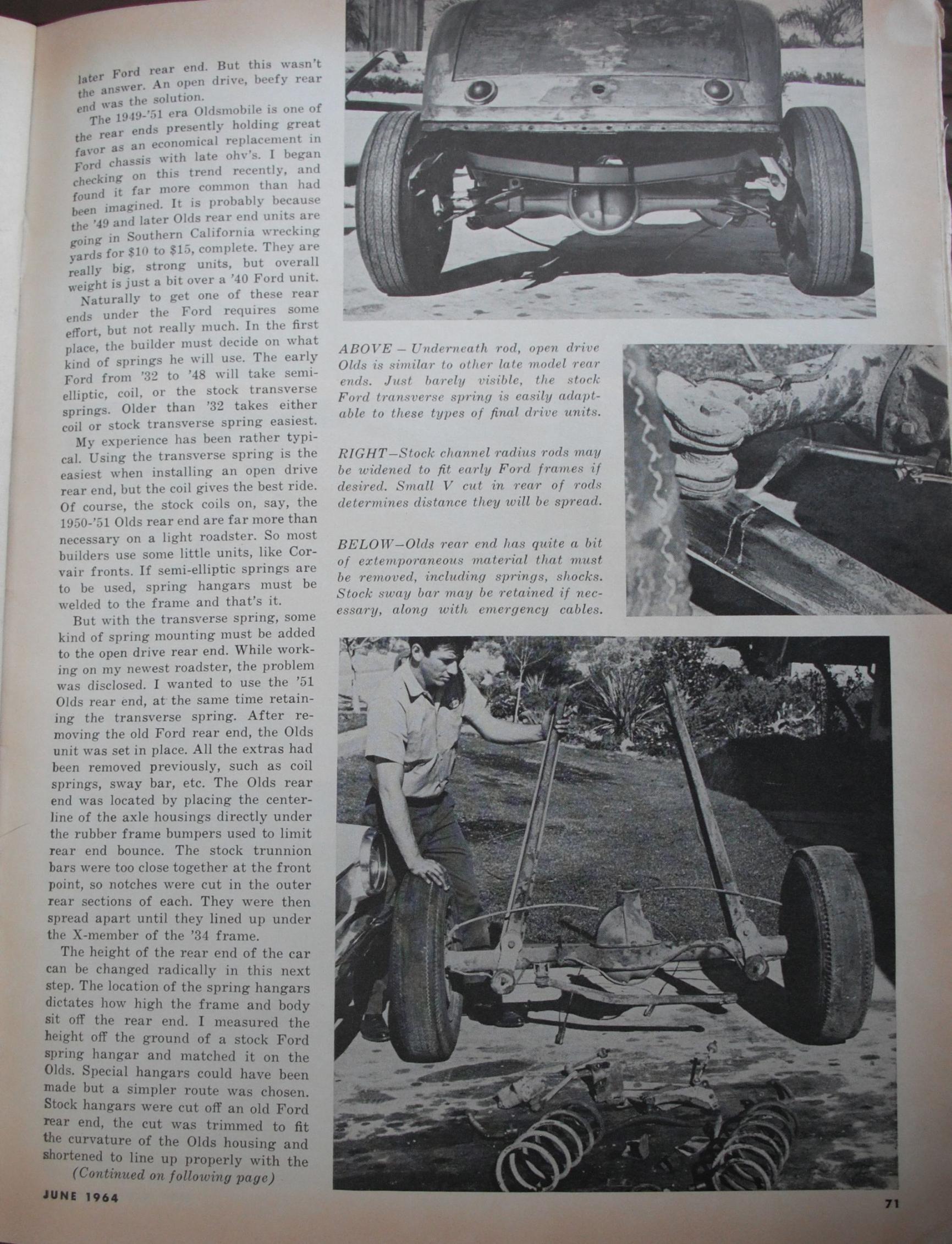

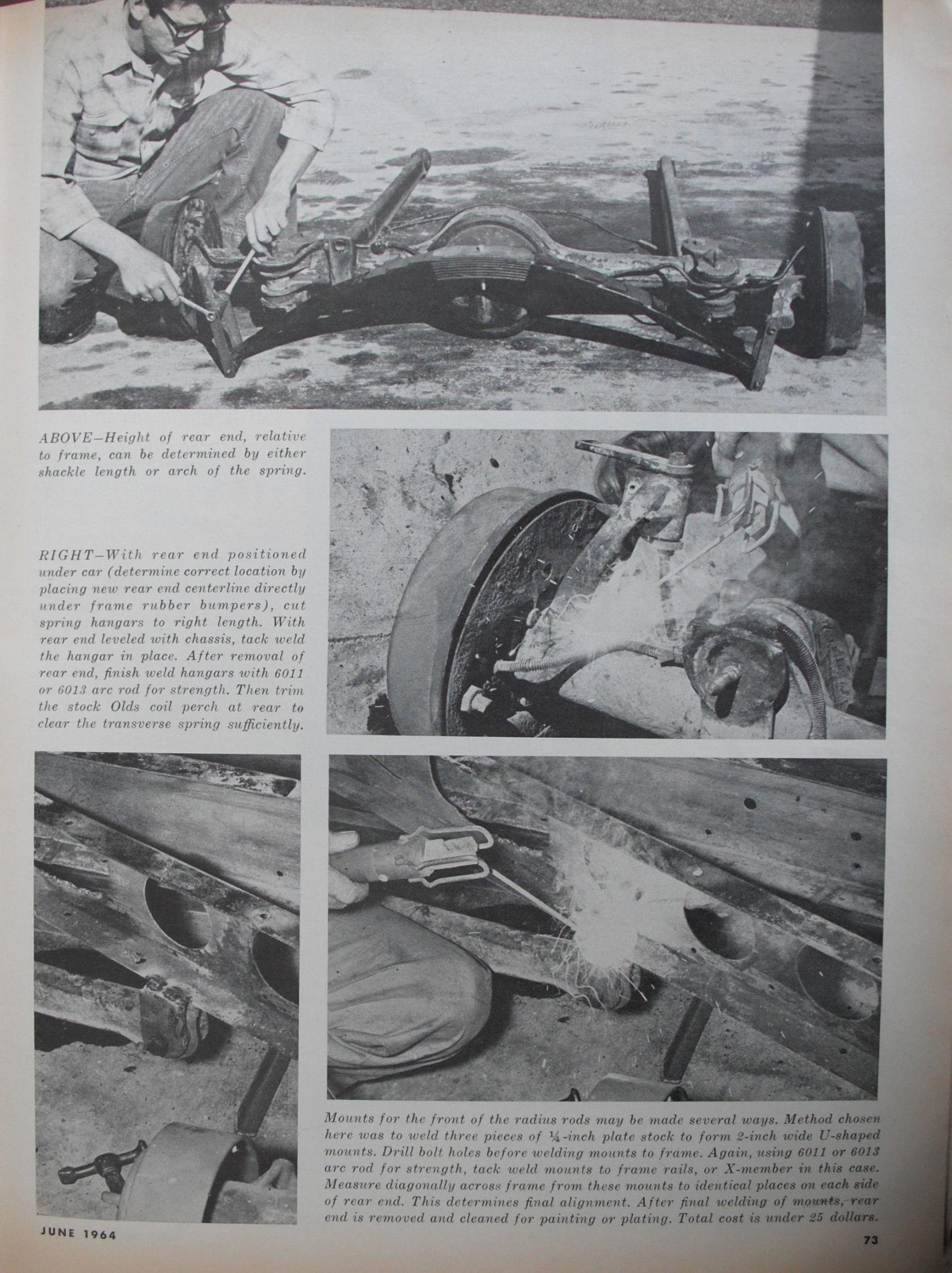

  11. F&J
    Joined: Apr 5, 2007
    Posts: 13,222
    F&J
    Here is page one of the tech article
  12. judgeyoung
    Joined: May 21, 2010
    Posts: 143
    judgeyoung
    What year was that article? I have read it before, but I think it was mid 60's. Do you have the rest of the article? Thanks for your help!
  13. F&J
    Joined: Apr 5, 2007
    Posts: 13,222
    F&J
    I forgot the year, but maybe it shows or maybe the original poster will spot this. Either Falcongeorge or Speedy Canuck.

  14. stuart in mn
    Joined: Nov 22, 2007
    Posts: 2,414
    stuart in mn
    The article is from June 1964, you can see it in the corner of the page. :) Coincidentally enough I just picked up a copy of that issue last week at a swap meet.
