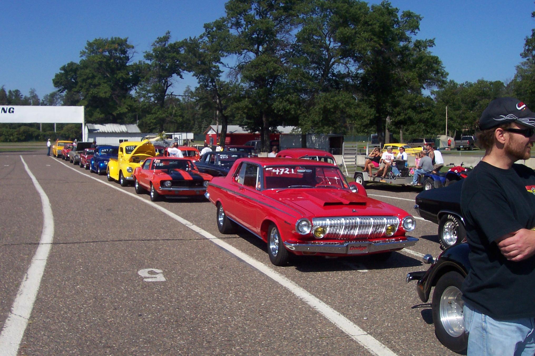

    the last engine is in a 63 dodge with manual trans 4-11 gears ran 12:40 on street tire. thru the muffler and tailpipes..single 4 bbl 700cfm full interior
    the 64 plymouth will be dedicated minimal interor , mini tubs frame connectors wide slicks al set for drags =weight transfer

  5. here is the 63 dodge
    we will be setting up the 64 more nose up ad prolly not as good looking ..
