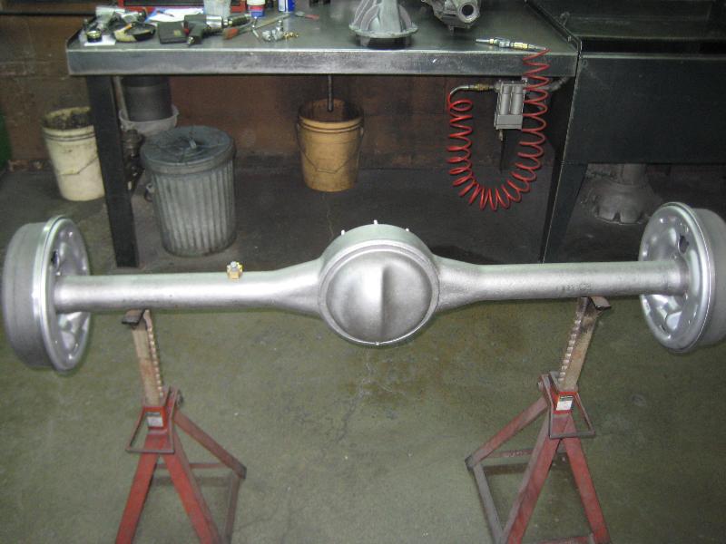

    Im in the process of building a 32 highboy coupe and will use a 1949 Ford passenger car rear end. Its sorta like an early version of a Ford 8". The original ratio is 3.73-1 and the width is 571/8 from axle flange to flange. The brake backing plates are from a 1968 Galaxie 500 11" brakes and the drums were modified slightly to fit. Nice clean looking, out of the norm housing. Heres a few pics of the rear end and in the chassis that Ionia Hot Rod Shop is fabricating for me.
  28. HotRodDrummer
    Joined: Dec 10, 2002
    Posts: 1,827
    HotRodDrummer
    Here are some more shots of "justpassinthru"'s rear suspension set-up.
