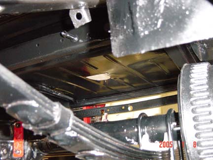

    The 1971-73 Mustang 9 inch rear is the same wheel mounting surface distance to wheel mounting surface distance as the 49-51 Merc. 61 1/4 inches. Here's what it looks like in a 51 Merc. I have 4 extra 71-73 Mustang axles if you need them.

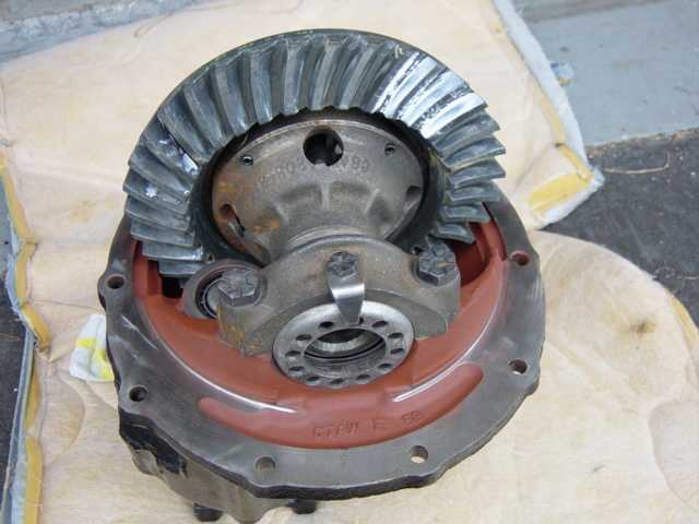

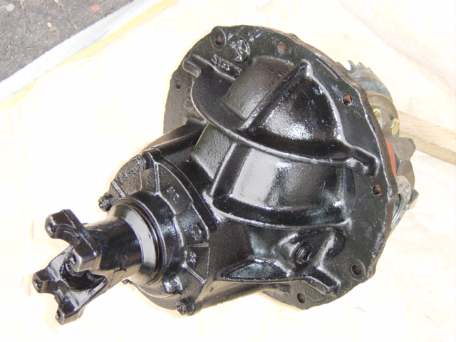

    Here's what the 71-73 Mustang 9 in. center section looks like. Removes from the back.
    This one has Traction-Lok.
    Hnstray likes this.

    @19Fordy I understand what you mean about 'removes from the back', but that would more commonly be referred to as 'removes from the front'.......the reference is to the third member assembly being removed from the housing.
  19. 19Fordy
    Joined: May 17, 2003
    Posts: 7,274
    19Fordy
    OK, Thanks. I didn't realize the terminology is not literal in relation to the front of the car as I assumed.
    In this 3rd member, the ratio was changed from 3:73 to 3:55. The car has overdrive.
