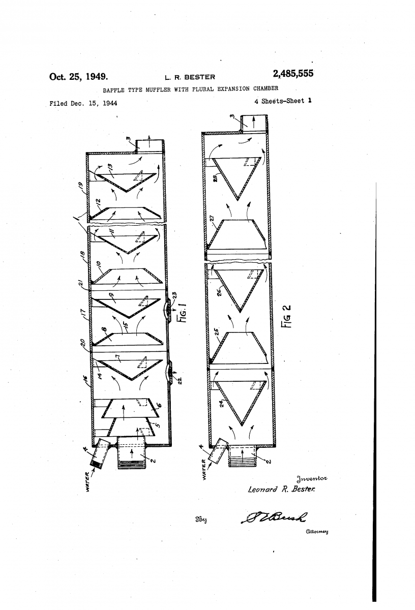

    I put these on a flow bench and they were terrible! I was trying to get under 95db with a minimum CFM rating ! they weren't good at all.
    I also tried dimpled baffles and they stalled the air as well.
    The best type were Vee shaped central baffles with inverted Vee so the sound waves cancelled each other
    seen here on a patent application [on the RH side of the pic]
    It flowed a lot of air and just creeped under the 95 decibel limit on my Road Race Corvette

    I assume these are the oval style muffler. Did you test any round, small diameter muffler's? I am building an under chassis exhaust system in a tight space.

  21. Kerrynzl
    Joined: Jun 20, 2010
    Posts: 2,954
    Kerrynzl
    They were in 5" round side pipes on My Corvette. [pictured below]
    The car is off topic but this thread is focused on the mufflers, not the car.
    I needed to get 1380 CFM per pair [690 each] to not lose any horsepower.
    The spirals were expensive to make , and flowed not enough to meet the target [490 cfm if I remember correctly]
    The Vee baffles flowed 688 CFM each which was close enough and the car was 95.6 Decibels
    I eventually pointed the exhaust tips at the ground and the Decibels dropped to 94.
    The Vee baffles were easy to make. We carefully slotted the outer tube and slid them in , spot welded them and trimmed them up. Then we TIG welded the slots and cleaned it up.
    The mufflers were made in 1996 and are still going strong now.
    You can see on the photo, I used truck Reducers and tips with 5" tubing in between. The went straight onto Hooker side-mount headers
    Stock Racer likes this.

    So, just to clarify, the spiral baffles you tested were baffles you made, not the baffles I posted a link to, correct?

  28. Kerrynzl
    Posts: 2,954
    Kerrynzl
    Yes they were made to fit in 5" tubes. We started cutting out spirals to improve flow, eventually we only had 1 x 360deg spiral and it started improving flow.
    We also changed the angle/pitch of the spirals .
    We couldn't do this with a Corvette frame. The side pipes were raised so the lower edge didn't hang lower than the frame [the car was lowered]
    If I could've done what you suggest, I would've done an 8 into 1 system. I didn't like the sound from side pipes .you can only hear one side, making it sound low revving [in the car was different, I shifted at 7200rpm]
    Asphalt is a good sound deadener.
    In NZ if you got pinged for noise, it was fix it or on the trailer
