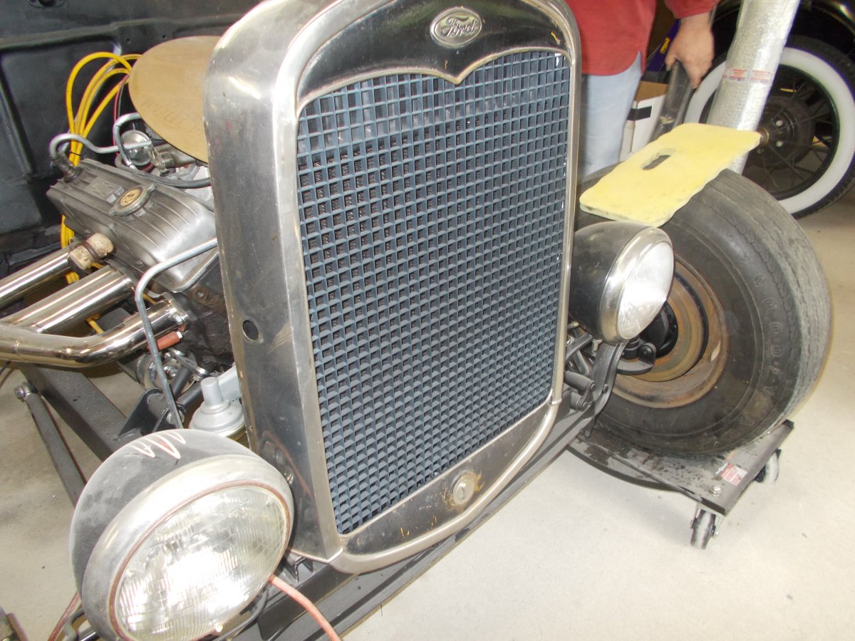

  4. sloppy jalopies
    Joined: Jun 29, 2015
    Posts: 5,256
    sloppy jalopies
    Buddy uses 1962ish ford truck 6 cylinder radiators... cool his sbc's...
    they fit in a '28 or '30 shells...
    they have a trapiziodal upper tank w/ center cap, rectangular lower...
    a 3" mounting flange that must be trimmed...
    …...……. it is a …. Modine 397...
    oh, and they are under $150 new... shop around, he gets them for $126...
    he, and i use a 4' florescent light's defuser, 1/2" square holes, 3/8" thick...
    $13 at lowz… does [2] grills...
    bottom pic is a tudor with the defuser and his '31 shell...
