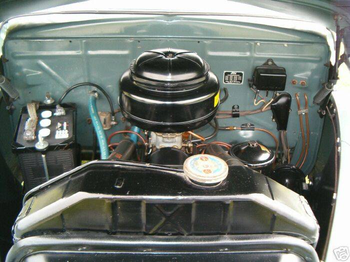

    OK, so I assume the 2 copper lines running through the dash here are the lines connecting the control inside the cab to the motor on the axle?

    I'm not too familiar with them in stock setup. I assume those are the vacum lines that go to the switch and controller. More of a vacum diaphragm that pulls/pushes shifting linkage on the rear than a moter. There is also a mini two speed transmission I guess you would call it that goes on your speedometer cable. Those aren't as hard to find because trucks with underdrive have a similar set up you can just reverse for overdrive.
