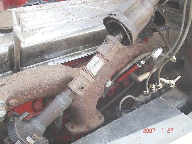

    This one for me is easy, I looked at a 54 Ford truck once that had a Mustang II suspension in it. To get the column and rack joined, the builder (not sure if seller built) welded a Craftsman 1/2" drive swivel at the base of the column an extension with the spline welded to it!!!!!!!!!
    Wish I had a pic of it.
    No, I did not buy it

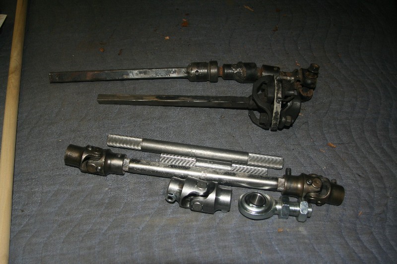

    here's some steering I redid on a 1940 Ford Pickup.... in the second picture I was under the car looking up. the red you see is the firewall. also notice the boxing plate in the frame is no longer welded

    fixed it with the parts below. also check out the axle pads. they are about 1.5" wide. one good burnout would probably twist the rear end out of the u-bolts. I didn't fix that, he wanted the truck back.:confused:

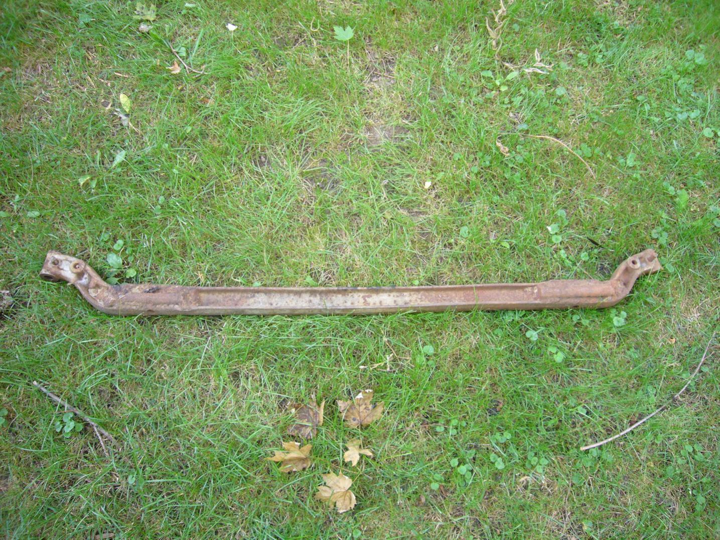

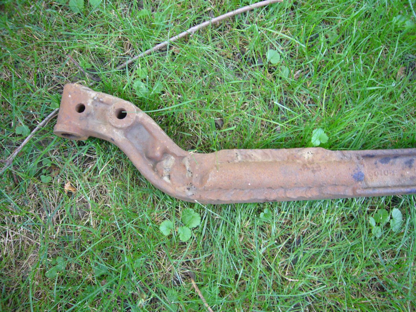

    When I got my Model A mostly in pieces back in 1975, the frame was a hacked roller. This was the front axle, an econoline that they cut the parallel leaf pads off and then welded some round stock in I-beam recess and drilled the spring perch holes for a stock model A spring. I thought this was scrapped years ago, but came across it in the back attic of my Dad's garage.

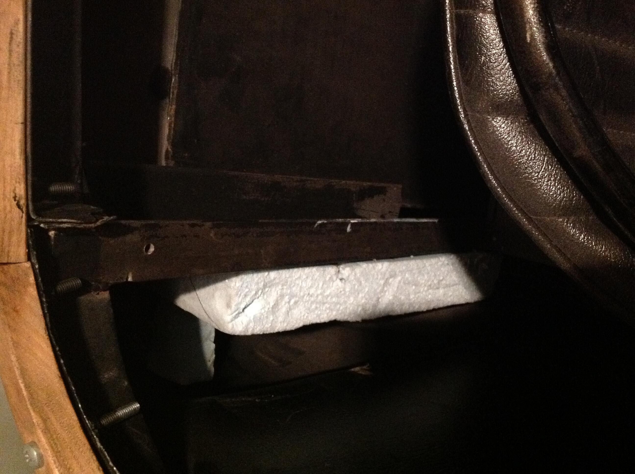

    im sure there's a lot worse but here's two of the many asshat things the previous owner did to my roadster. gradually working through righting the wrongs....and there are MANY!!!
    throttle pedal held into toe board with washers and staples
    Gas tank held in place with blue foam and rubbing up against rough angle iron behind the seat.
    Genius....this guy calls himself a serious builder and sneers at rat rodders. its what you get when you buy sight unseen. I'll never learn.

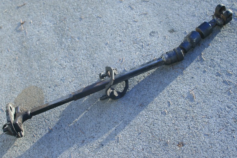

    Steering wise, I believe this came from an earlier thread on the same subject.
