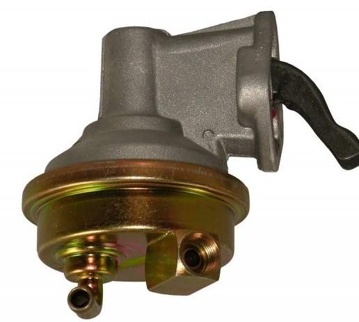

    Beware that there are lots of different orientations of fuel lines on SBC pumps. One that has the lines pointed more towards the engine, than towards the frame, is something like a 72 Impala 350 pump. But I'm assuming the pump fits inside the frame, not over it. No pictures to look at of your car, of course.

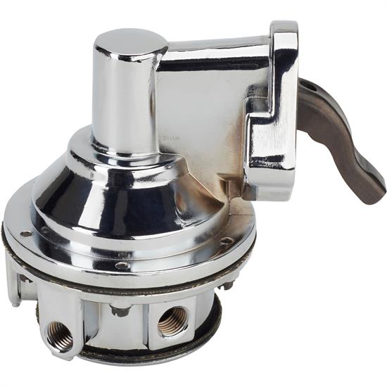

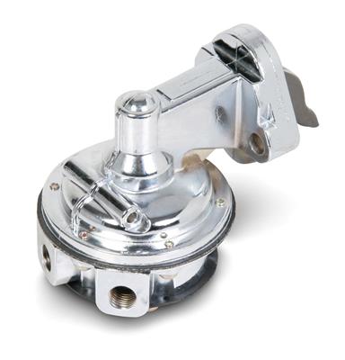

    C75D2EE7-F049-488C-8A6A-B3A2F3282780.jpeg Jim has the same idea as I, here are comparisons between your Holley pump at top and a Speedway
    Motors pump at bottom. Also look at the distance between the mounting flange and the pump body, some will be shorter. I’m not endorsing any particular pump, but surely there is something that will work for you.
    Keep in mind that even if the pump has adequate clearance as installed you might have to raise the engine to be able to install it. 8572E014-7E05-40C1-9F19-17F4F67C5654.jpeg

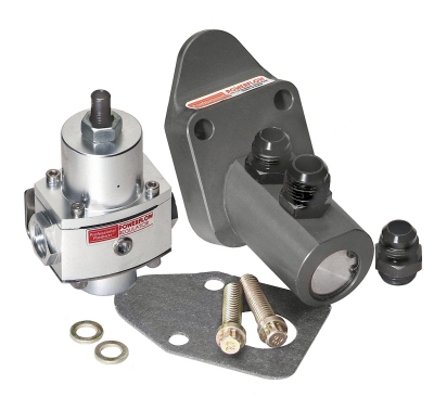

    Look up Power Products piston pump. I used one in my dragster it was the smallest I could find

    It is driven just like a stock pump but I used a aftermarket rod . I had the name wrong it’s Professional Products. This is the one I used 815A3D1E-DB22-4471-8AB8-0A8E8EB21257.jpeg

    FYI, profesional products is the Chinese knockoff place that copies parts, badly.
    MSD 6AL like boxes with generic GM HEI modules epoxied to the cases. They would advertise the 'output voltage over 400 Volts' or something goofy for coils.
    They have 'performer' intakes that require more machining than the cheap price saves you. IIRC ole Vics legal team went after them. IIRC they now have a permanent 'out of stock' label on their website for all there Edelbrock copied bits.
    They also used to sell Honda(I know OT) harmonic dampers that were really shitty ripoffs of ATI dampers. How shitty? They would explode above 5Krpm.

    I use the pump squirrel pictured on every SBC build I've done. Easy to plumb and easy to find at the local auto parts store.
