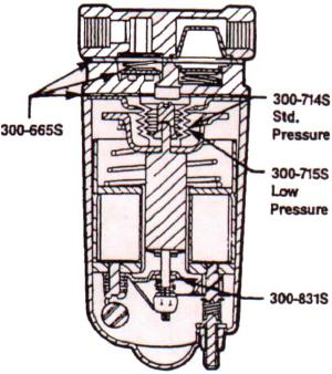

    I decided to disassemble the Walbro just to take a look and found the bellow had deteriorated into black tar and was clogging up the bowl. So to save a few bucks I found a rebuild kit and going to give it a shot.
    I am actually pretty impressed with the quality of these old pumps, very well made other than the plastic bit.
  20. wegortw
    Joined: Nov 17, 2013
    Posts: 21
    wegortw
    from Austin, TX
    So anyone know how to rebuild a bellows fuel pump?
    With mine melting apart and no good detailed parts diagram to go by, my first attempt at rebuild put out very low flow or any pressure. After looking at the old gasket it appeared that the bellow went right up against the gasket (not sure if on purpose or not), so on the 3rd reassembly attempt I put the bellow through the washer into the bowl. Now it doesn't seem like the top-end will mount without some squeeze.

    IIRC on some of the marine ones we rebuilt we used 2 studs to hold everything in alignment then pushed down on the cap and secured the screws as the plunger was relaxed with the power off and pushed up against the cap .
  25. wegortw
    Posts: 21
    wegortw
    from Austin, TX
    So from underneath like in pic 1 or you saying pic 3?
