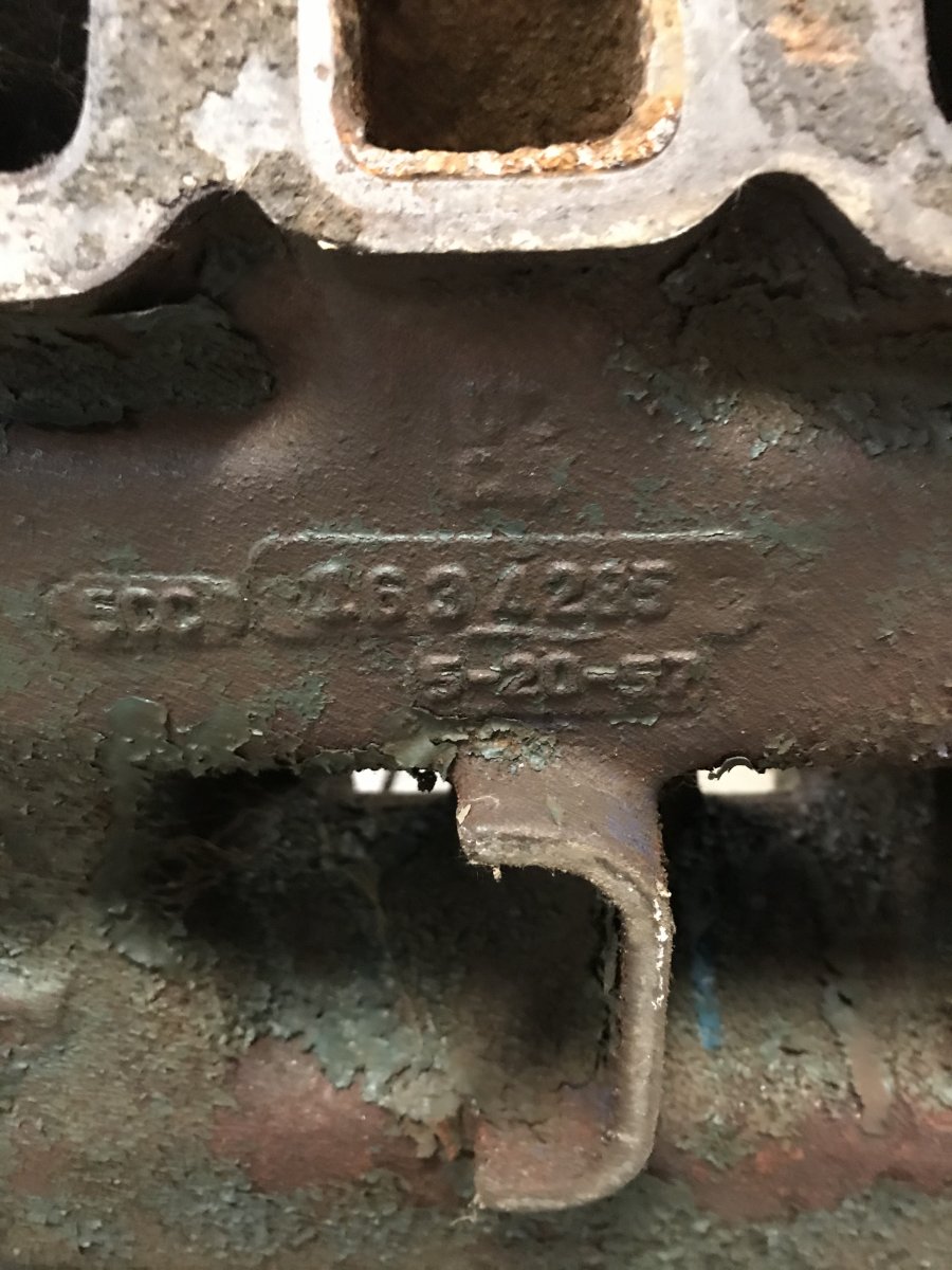

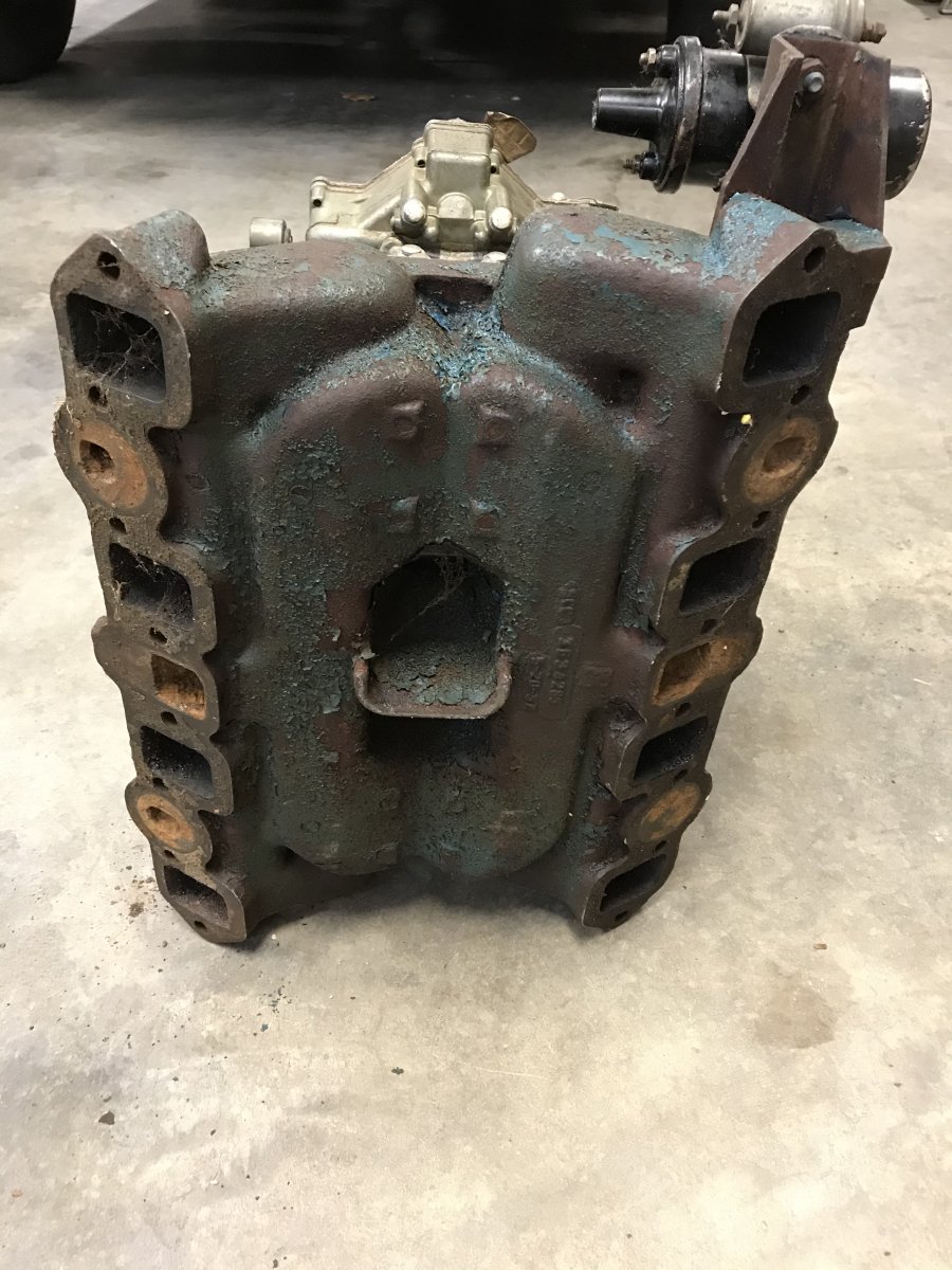

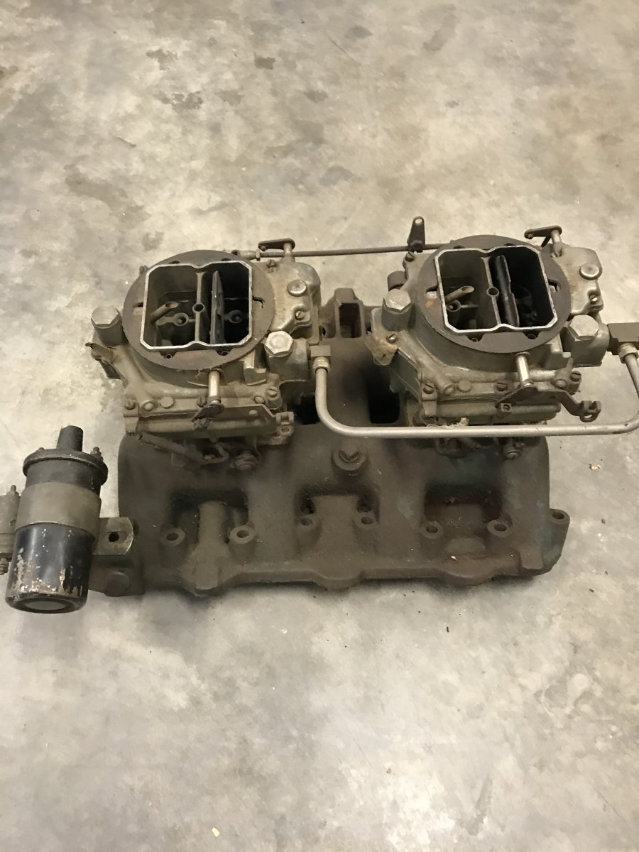

    8328C117-8C25-4FF3-BE99-67061ADBF76F.jpeg AA995918-5618-4974-BC3A-8B862BBC7B2C.jpeg D40E98FA-ABDC-46D1-87AB-43344739CE2D.jpeg I’ve got this intake that I thought was off a 55 or 56 300. I’m not exactly sure by casting number and haven’t been able to find 9194FA0D-D0E2-4B02-9389-3AED78DCB4D4.jpeg

    Cast in May of 1957, so it's probably from a 300C or 300D.

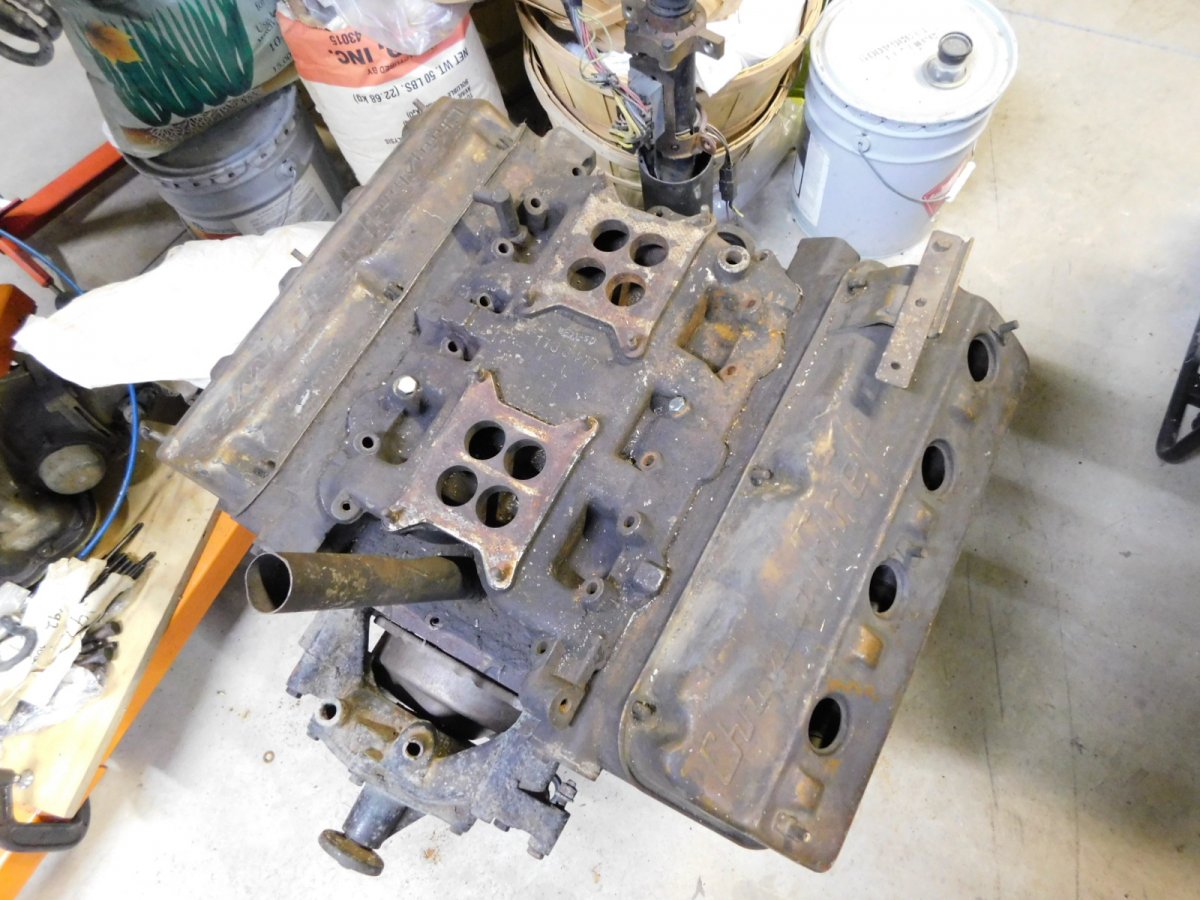

    Ignore the coil bracket. I believe the intake was on a non 300 engine as the 300 engines had a bracket welded to the left valve cover for the coil. The 300's were the only hemi that had a left and right valve cover.

    I have a 55 300 and valves covers have no bracket. I can dig out but would take a bit.

    Were there "non 300" engines that had dual quads? The only ones I am aware of were the Desoto Adventurer, but the thermostat housing was part of the intake manifold. This one doesn't have that.
    And I don't believe there were any polyspheric motors that had dual carbs either.

    Guys........Chrysler Intake manifolds fit '55 thru '58 (331/354/392) passenger car engines. The 392 had a higher block deck height to accommodate the longer stroke, but 392 heads have a modified manifold mating surface to compensate for that....so the effective 392 mounting surface was the same as 331/354.
    Consequently, the product date is consistent with use on a production 392...as well as being the same casting design as a '55/'56 (331/354) 300/300B.
    The Poly and hemi engines have the same mounting surface dimensions, so this manifold can have wide application (301/331/354 poly in addition to the '55/'58 hemis) regardless of it's original intended use.

    I was not clear. The 2x4 manifold was likely on a hemi that was not a 300. The intakes can easily be swapped between these engines. After 64 years all sorts of things could have happened. I was speculating about the coil bracket.

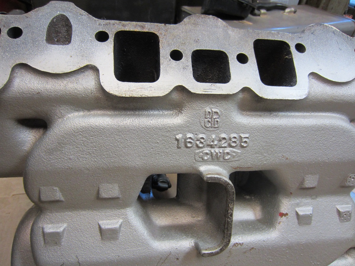

    1955 300 1634285 That '57 casting date has me befuddled, that don't take much!
    1956 300B 1731686
    1957 300C 1733477

    @270dodge don't be so hard on yourself.....:)
    It "doesn't take much" for a part to get a new casting number even though it may retrofit an earlier application. Some times it may not, but in this case, I think any of those manifolds fit any of the engines listed in my post #8 above. I have been wrong before, and will be again....but the info above is, I believe, correct. If not, I'd be glad to know where I went off track.

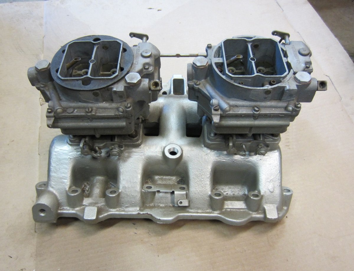

    Here is my 392 intake for comparison 8FD6EF02-D18C-436E-B3B3-BA2E2325557B.jpeg

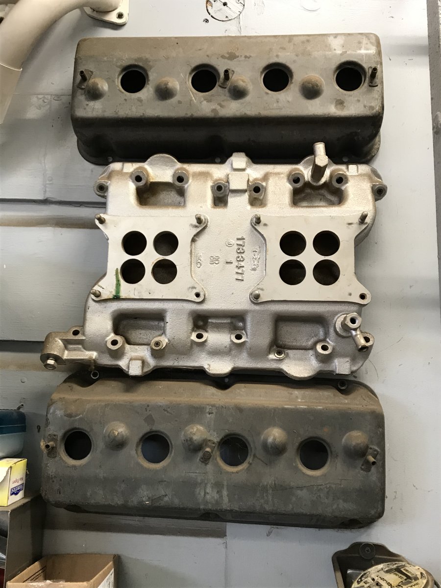

    That is the correct intake for the 392 300 engine. I'm seeing dodge covers (they have round bumps. Here are my 300C covers still showing the gold paint. With that coil bracket. DSCN0008.JPG

    Jon, it appears that none of the manifolds in this thread are listed in your document. @270dodge listed the numbers for the following:
    1955 300 1634285 would be a 331 CI motor
    1956 300B 1731686 would be a 354 CI motor
    1957 300C 1733477 would be a 392 CI motor

    Valve covers are just there as wall art for now.

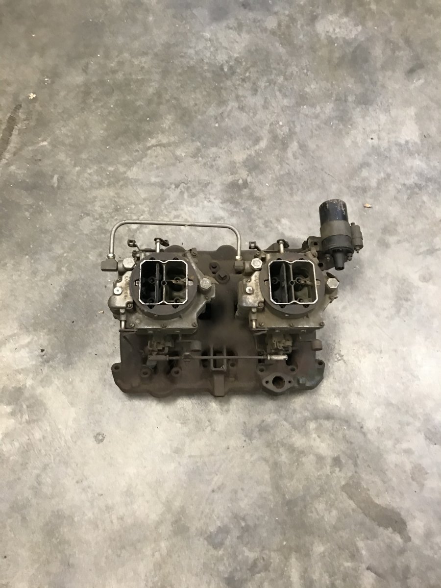

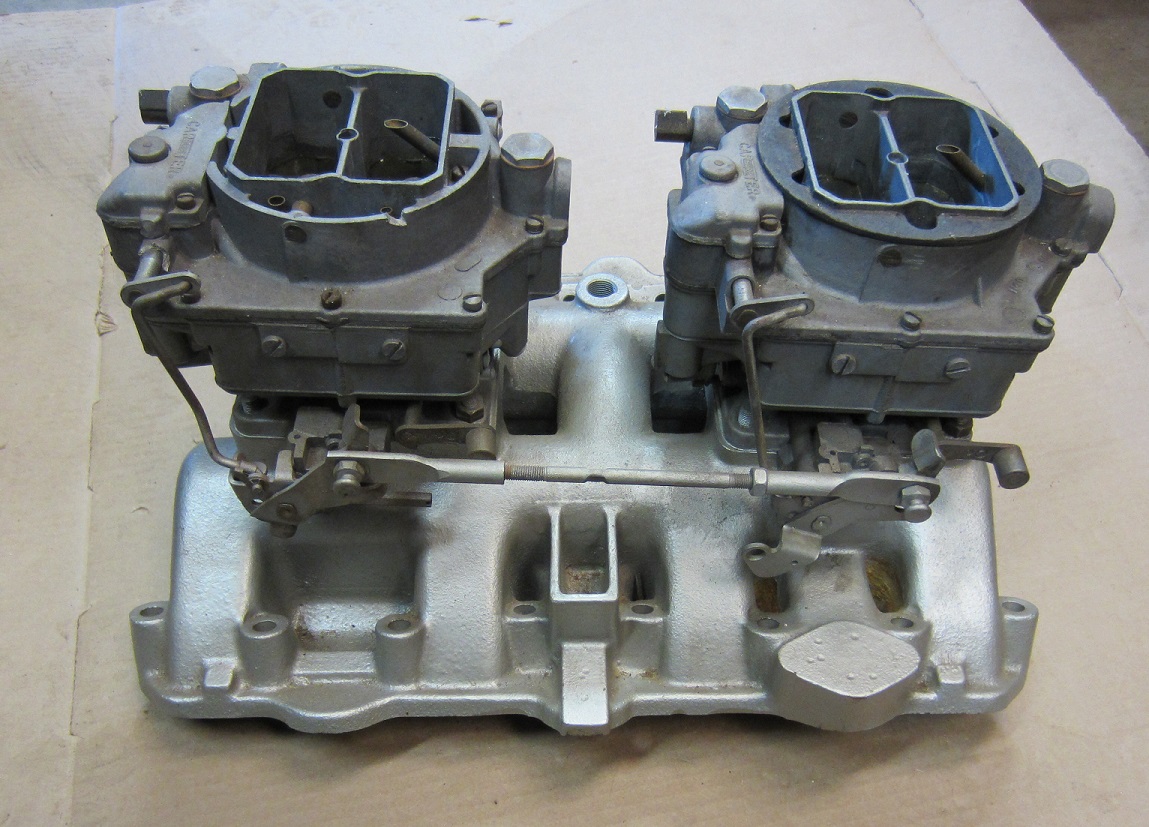

    I have an intake with the same casting #, no date code. No water passages.

    It's a Chrysler marine intake manifold. The lone water outlet flange is where the big brass thermostat housing bolts to.

    Being a marine intake has anybody used this on the street. Other than blocking off water, intake looks exactly like 331-354 300

    Don't see why you couldn't use that manifold in an automotive application.
    One word of caution though, the center port used for carb heat which normally uses exhaust in an auto application uses water on the marine engine, I believe the port is in a slightly different location on that manifold so make sure your gaskets line up right.
