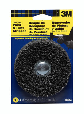

  2. i use the stripping pads in the tool dept. at lowes. 9.99 each, fits a 3 " grinder, took 4 of them to strip my f-1 to where it was shiney. then coated it with osphoe, let it set overnite, wiped off the dry residue and put three coats of slick sand high build primer.

    Stripping pads all the way for me! This is my 60 chev totally cleaned up with them. Gary:D:D

  6. fastcar1953
    Joined: Oct 23, 2009
    Posts: 3,604
    fastcar1953
    about 5 of these to do whole car

  14. Been very successful with the "rice cake" stripping wheels in a 4 1/2" angle grinder.

  18. I stripped both vehicles in my avatar in a weekend using the stipping disks , found using the ones on a drill, lasted longer
    and left the metal nicer, than the ones made for the grinder

    I agree, the sandblaster disks on a 4 inch angle grinder work like a charm. I did the cab on my Stude truck.

    hello. I am a lurker. I bought a 3m clean strip disc (5", hook and loop, 2500rpm max) and a GV-5010 sander, based on this suggestion.
    My question is though, how do I use the disc with that sander? It seems to only take 5" sandpaper with a small hole. The clean strip disc shows it to use with a drill.

  23. metlmunchr
    Joined: Jan 16, 2010
    Posts: 862
    metlmunchr
    You need a hook and loop pad for your sander to replace the plastic backing disc that's on it now.
