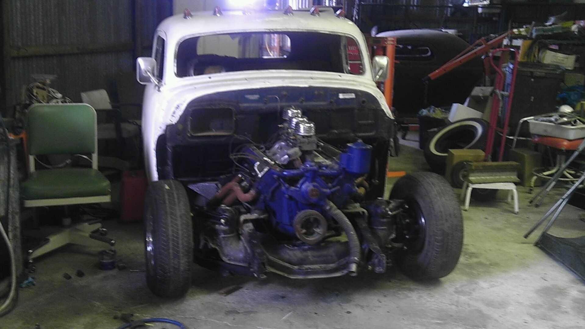

  2. all you're going to find is Mustang ll, S10 frame swap orr Camaro clip
    I went a different route and it fit perfect. but I don't have it on the road yet, So I'm reluctant to hype it. 49-54 chev passenger car/ 53-62 Corvette

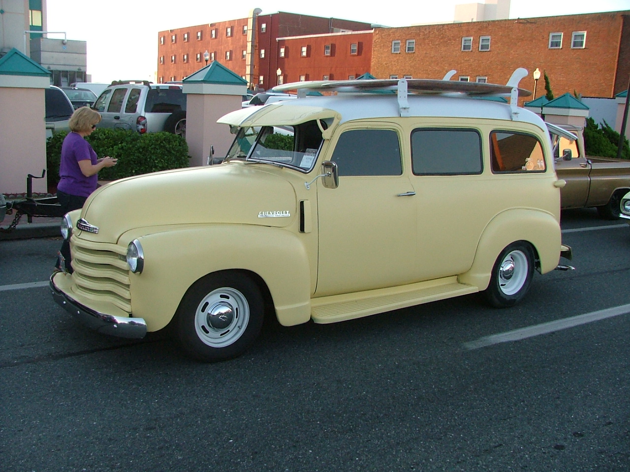

  15. 1950ChevySuburban
    Joined: Dec 20, 2006
    Posts: 6,188
    1950ChevySuburban
    from Tucson AZ
    I've got a Industrial Chassis Dakota kit in mine. Steve (El Polacko here) used to make these. Check with him. HIGHLY RECOMMENDED KIT!
    Got 5,000 miles on mine, aligned easy, tire wear's minimal. Easy to steer and strong enough to carry a Suburban loaded with family.

    Interesting swap, never thought of that one! I have a '62 Vette front clip and a '53 Chevy Panel, I see a possible marriage! If you want to share any info and possible pic's shoot me a PM with your E-Mail addy.............. Thanks
