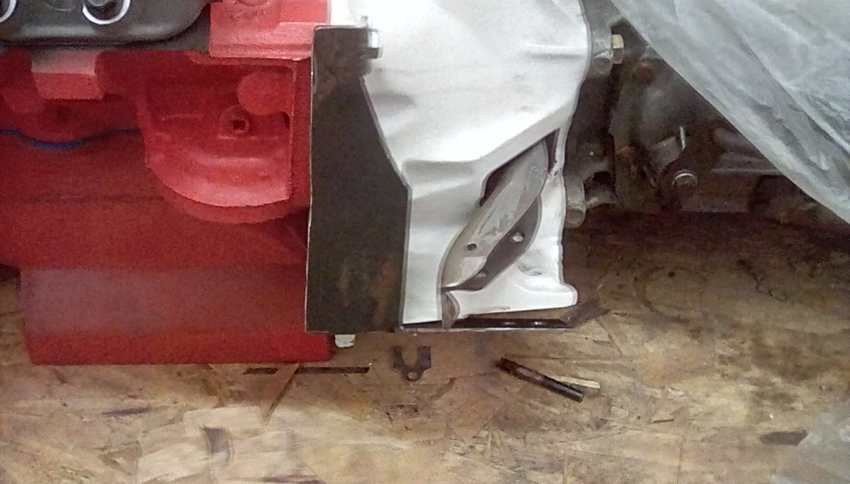

    I am a horrible insomniac, and I tend to do small projects like this in the middle of the night.
    Hopefully my methods will help the first time builder with some of the frustrations of building your own parts.
    Tonight I am building a bracket for the hydraulic clutch slave cylinder on a SBC.
    Rule 1. Safety first. Eye protection and gloves necessary. IMG_20160709_024000.jpg
    Start with a few basic tools. Cardboard or poster board for templates, marker, ruler, tape, and a square. IMG_20160709_023933.jpg IMG_20160709_031349.jpg
    Determine the approximate size of the desired part and rough cut your desired shape, fitting and trimming until you have the fit you want. Transfer to your material, in this case 4 inch flat stock ,1/8 thick.
    I used a cutoff wheel to this, as this would be the most readily available to the diy guy. Plasma cutters are nice, you could even torch it if you like to grind.
    I also try to drill my holes before I cut the part off, its easier to drill and hold a large piece. If you cut first, then use a vise to secure the part when you drill. Cuts hurt... IMG_20160709_041544_hdr.jpg
    Roughcut, ready to start fitting IMG_20160709_041725_hdr.jpg IMG_20160709_043457_hdr.jpg
    And a little eye candy.

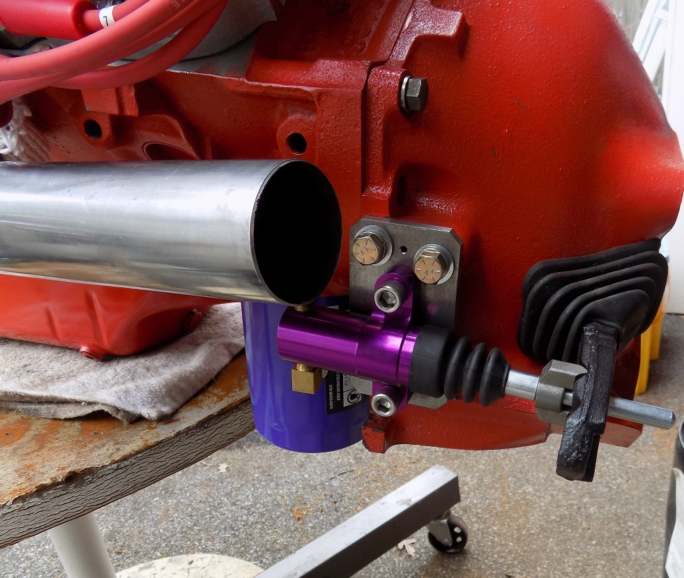

  12. This is my slave bracket, made from 1/4" stainless.
    Aside from that, crawled out of the sack at 7... fed the big cat & kitten. By 9:30 I had fixed my shifter issue (flipped arm @ the transmission) and checked the car over after last night's maiden voyage. Bled the brakes and improved the pedal.
