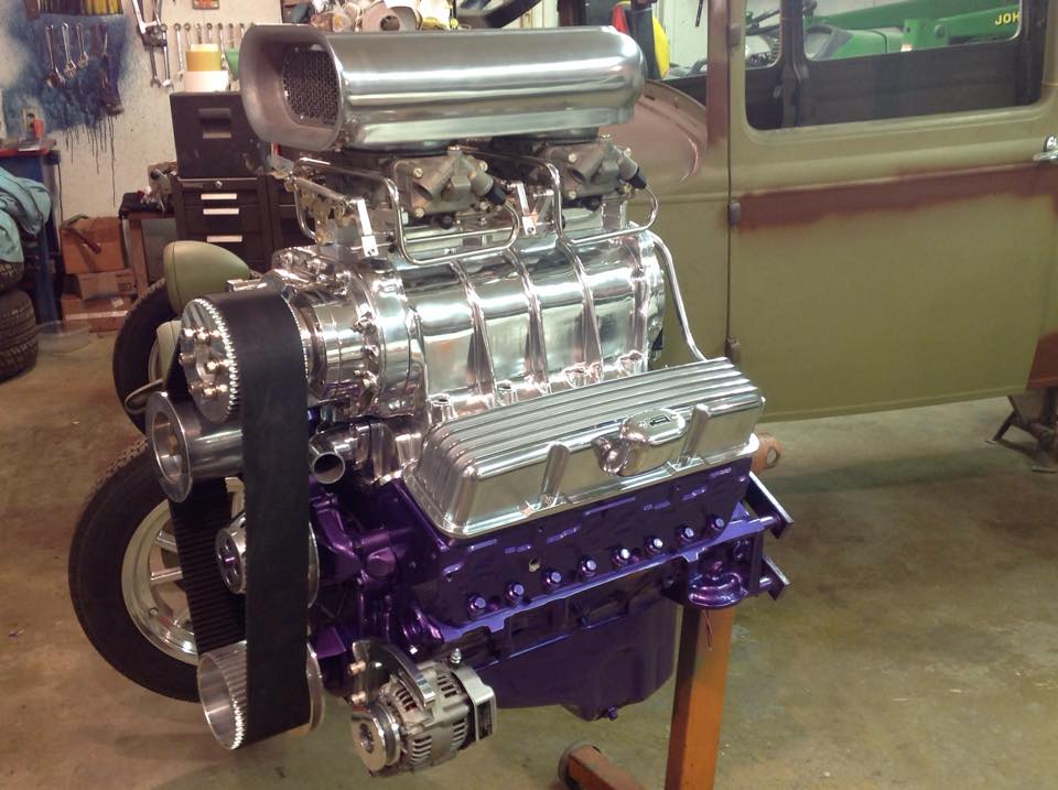

    You guys will have to let me know the Dino date, If I can get my crap together and get it started I may bring it down. If not and you don't mind I may just drive down for the day and try to learn something. If nothing else at least it looks pretty good.

    looks good to me !! looks like you're ready !!
    do ya have boost reference power valves in there? if not we can do it when you're here, no biggie. oh, if you come, you gotta bring your junk.. : )
    stay tuned on the date... have a couple of nibbles...
  4. 2 things I see. Flip the valve covers so the breathers are on the top (if they'll clear to blower), less oil up there, & go back and get the bigger oil pan! :)

  5. rawcjw19
    Joined: Oct 8, 2012
    Posts: 581
    rawcjw19
    They are old carbs I boost referenced, from reading on the net. I had them replated and put them back together. They probably wont run at least at first . The breathers wont fit the other way ( I did block one off and have that cover running to a pcv valve) I did a lot of things I have never done before so I am expecting the worse

    cool, boost ref. and i have notes of other engines similar to that, we can get the jets close on start -up.
    then there is the transition circuit.. no biggie, takes about 14 beers to get em' right.,maybe 15.
