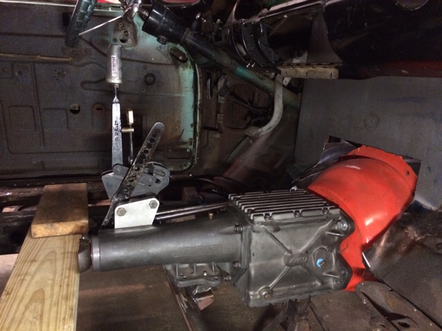

    Just got this bad boy for my 56. Cage is next.

  11. Wide gear, or narrow, what ratios did ya get/

    It's a wide ratio 2.93 1.84 1.33 1.0
    Has road race sliders so it can see some street time.
    I bought it as a package trans bell housing twin disk clutch aluminum flywheel and shifter.
    I'm thinking a 4.30 rear gear because I have 28" tires out back
    I'm looking forward to banging gears. I had a close ratio muncie but saw that as a weak link.
  14. Nice package. I would dyno the engine before I picked a gear, may want a 4.56. We had a 4.30 in ours at the Meltdown, with nearly the same trans ratios, & 29.5 regular (not a W tire like Quains guys run), and it wasn't enough. We are currently 3200 lbs. though and the engine tune wasn't right, had it been, it would've ran thru the gear box quicker & been turning more rpm and speed at the stripe. You'll be real close I think with the 4.30, but just might need the 4.56 for those SEG 1/8 mile drags.

    Thanks for the info. I was thinking about doing that. I have ruled myself out of the SEG drags because the blower. I'm hoping to be around 3200 but not sure if I will be. I'm planning on getting a fiberglass trunk lid. But I'm going to use real glass in the car.

    what kind of tranny and shifter is that? I have a Richmond T-10 and Hurst shifter in my avatar Falcon, and it doesn't shift worth a ****. I have tried adjusting clutch, linkage, you name it, still from 1st to 2nd, seems like it just wont go smooth. I thought the Richmond would be good, but I am very disappointed. I probably lose a second or so in the quarter just trying to find second gear.

  28. That's a Jerico trans & a Long shifter (Leonard Long). One of your shifting issues may be too much clamping pressure from your pressure plate. If you're using a "rag" clutch disc as in the usual street/performance kit, these discs have smooth release, but slip more easily, with aggressive driving, especially with the inertial of steel/heavy flywheels. To combat this tendency, discs with that material are typically paired with pressure plates in the 2800-3500 lb. range, and that along with heavy flywheel inertial makes it harder to shift in the upper rpm ranges. McLeod & Ram both offer ceramic discs that work nicely in dual purpose cars. The ceramic discs offer improved grip with less base pressure un the pressure plate, usually 1500-2500 lbs. depending on the application & flywheel weight. Twin discs in both disc materials work similarly, because you have twice the disc surface area, you don't need high pressure plate loads.

    Leadsled51 I would pull the cover and look at the gears real close for me if the small teeth that engage with the shift collar don't look perfect it would never speed shift.

    What Rick described sounds exactly like my set up. It has a Ram clutch and pressure plate, with the what you would call "rag" clutch, not the ceramic or metallic clutch, along with the 2800-3500 range which you were talking about. This car is not driven on the street, strip only, so maybe I should go with the more racing clutch either the metallic or ceramic with less pressure plate pressure. I think someone on here said you never buy or spend the money the first two times you get stuff. Sounds about right
