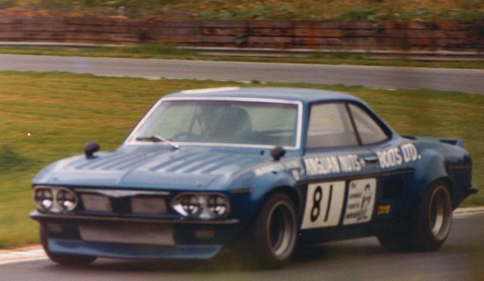

    I saw a nice one with a mid engine SBC at a Swapmeet a couple of weeks ago.
    Good thing I'm broke.
    I could see that thing with Webers, 180 exhaust, and big wheels & Flares like this one.

    Fuckin' A, brother!!!!!
