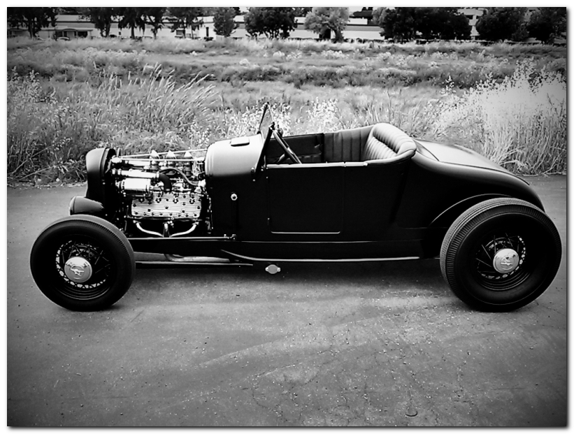

    Here is a sketch of the rear subframe i had to build for mine
  9. i accidentally came acrost this and really like it, thought you might benifit from acouple pictures. here is the link to retreive more pictures for your personal stash http://cgi.ebay.com/ebaymotors/Ford...4772820?pt=US_Cars_Trucks&hash=item45fb0e77d4
    alittle from the ebay write up
    "Sinister early style traditional hot rod. Finished in satin black with a dark red interior. All steel 1927 Ford Roadster that sits on top of a set of original 1932 Ford rails with an original 32 Ford grill shell and insert. The engine is a 59AB flathead with a 1939 Ford transmission. This car was built by Keith Tardel in Vern Tardel's shop and truly is a traditional hot rod in every sense of the word while still remaining very streetable. This car has been driven by the owner on many long trips including a run to the Bonneville Salt Flats in Utah. "

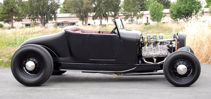

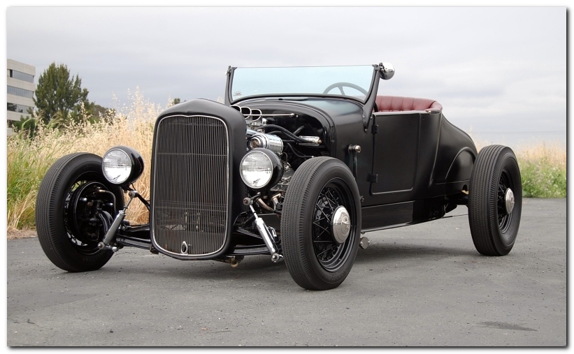

    Wow! I'm super surprised! I would think they would be a hit. Wonder what it would cost to ship one of those bodies to the US... Hmmmm... :rolleyes:
    Here's those pictures.... This car belongs to Dennis, from the Pasadena Roadster Club. He's also a HAMBer.
    redoxide and Shadow Creek like this.

    Thats a dropped model axle on Dennis's car right? like I said I have a model a axle and I intend to use it instead of the axle on the modified. I will be dropping it myself.
    David
  18. scootermcrad
    Joined: Sep 20, 2005
    Posts: 12,368
    scootermcrad
    The axle is a 33 to 36, I think he said. The bones are 33/34.

    He said he pinched the frame quite a bit. I presume the body is stock, for the most part, with the exception of the obvious mods for later parts, and what not.

    That is correct. The body is stock and was only modified on the insides of the rear subrails to fit with the frame. The frame was pinched 3.5" to fit under the body. Unlike most 27/32 combos I made the frame a little narrower than the body so that there is 1/2" of overhang on either side. I also removed the rear portion of the frame rails at a couple of inches behind the side reveal and hand-made new Z'd rear frame rails from 1/8" plate so that chassis could not only sit low, but also funtion good.
    And, the front axle is, like Scooter said, a '33-'36 and was dropped by Industrial Chassis in Arizona.
    29EHV8 and Shadow Creek like this.
