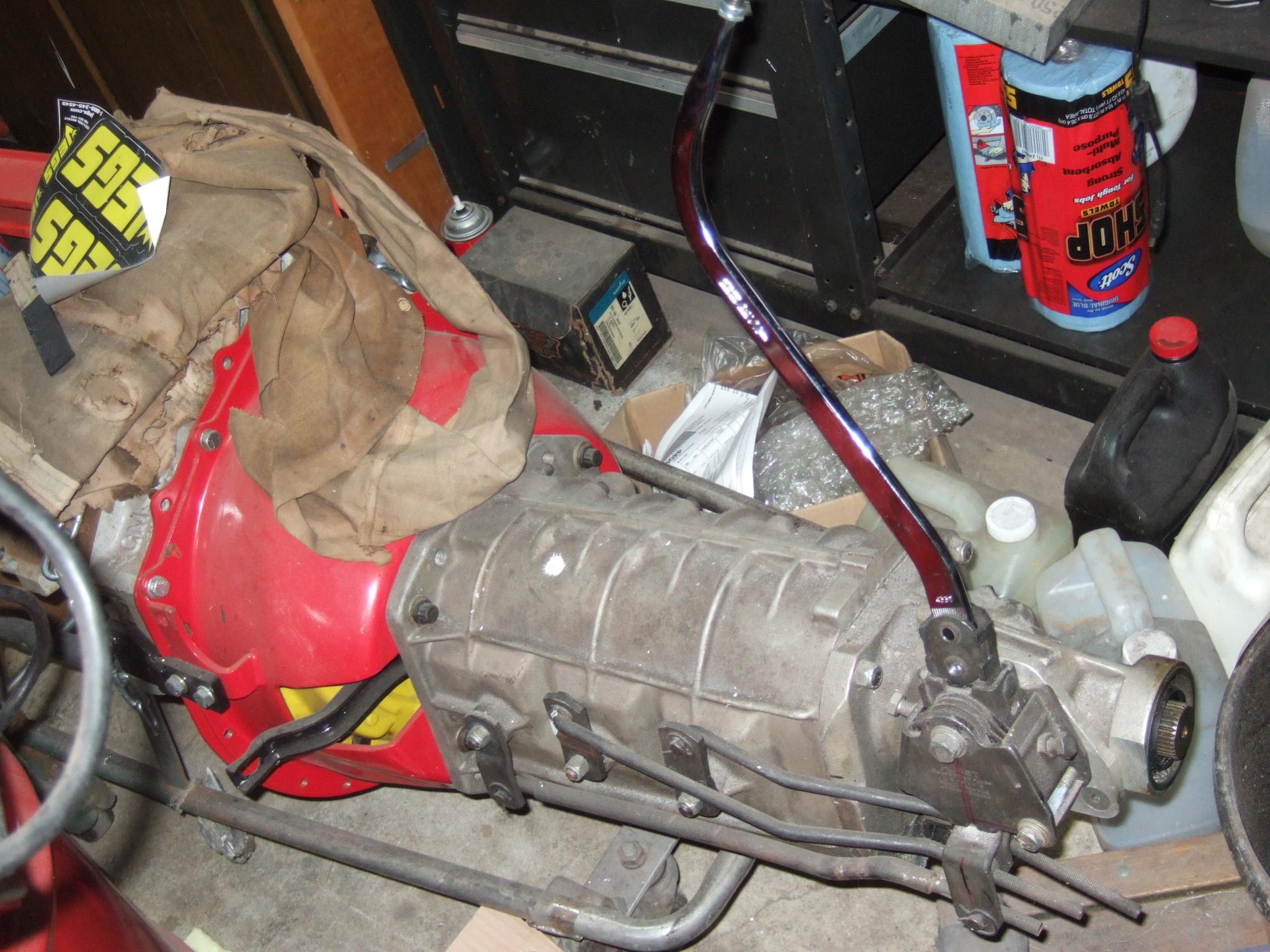

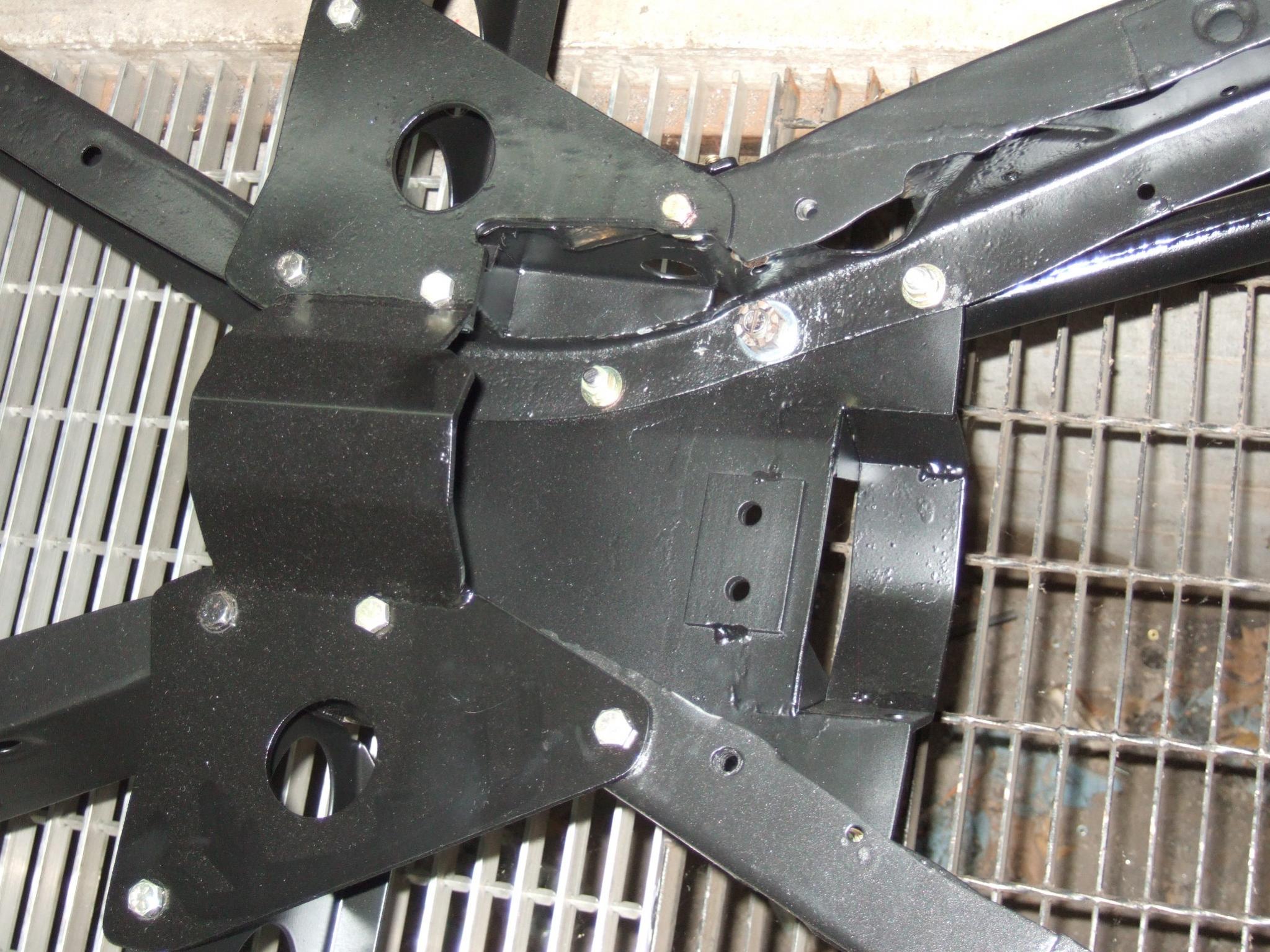

    Here are some pics of Richmond 4+1 ( 5 speed) with a Hurst shifter and the frame mods I made using reworked Chassis Eng. torque box replacement plates. I had it set up for a T 10 with a Hurst Comp Plus and had to move everything to the rear about 2 1/8 in. The 5 speed requires more side clearance for the shifter (about 1/2 in.) With the 4 speed you don't have to add much reinforcement to the left side of the X. I used the Hurst lever 4331 and it is not against my right leg and easily misses the stock seat even when fully forward.

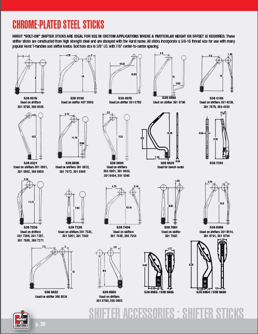

    The Hurst website has information regarding everything currently available....The attachment came from their website........
