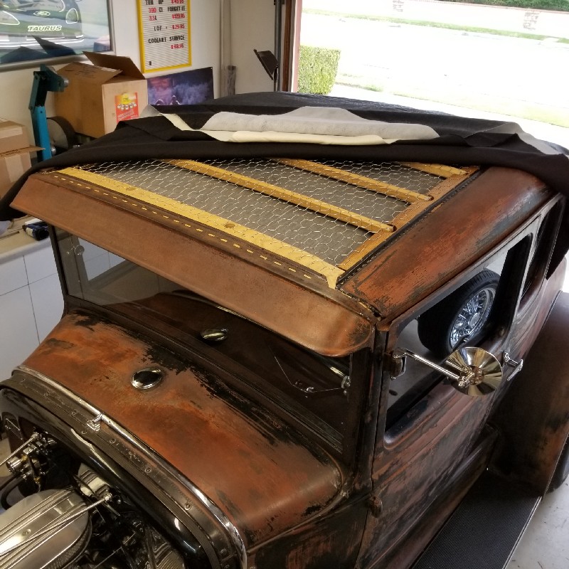

    Here's a pic of the top replacement on my '31 that shows the bows. As you can see, if you weld in an insert first you won't be able to put the bows in from the top and secure them as the factory did.

  10. If it is a solid roof, why do you need the wood bows, they were there to hold up the chicken wire? You can make some sort of headliner bows that bolt in the sides if you need it for upholstery.

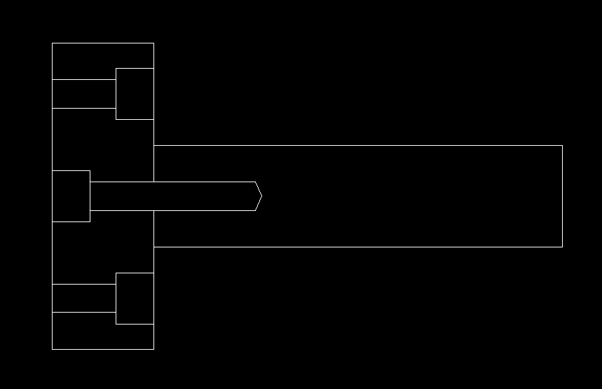

    @flt-blk is right. You really shouldn't need any of the top braces, but if you want to add one or two, for something to attach a head liner to, then cut them short and add an end that bolts to the side rails.
    Like this;

    I hope you are not thinking you can get rid of all the top wood just because you are welding in an insert. The header is what the visor is attached to and the the door fit is determined by the side wood attachment to the header. Nailing the side panels to the side wood also adds rigidity. If you get rid of the wood, SOMETHING will have to retain the door fit (at a minimum). There's really good reasons all that wood is there (and not just because tooling was not very advanced back then).

    Really can’t see how you could install the bows after welding. There should be enough of a gap around the edge to put a welding blanket to protect the wood.
