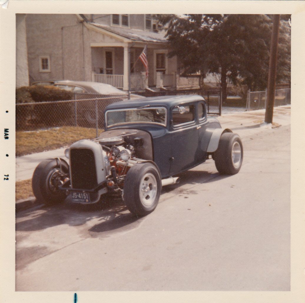

    i really don't give a shit if anyone likes this. on this car the body was channeled and all the floors were gone. so i welded the body to the frame, iv'e been over 100 mph with it and i did it MY WAY.
    see my avatar.
