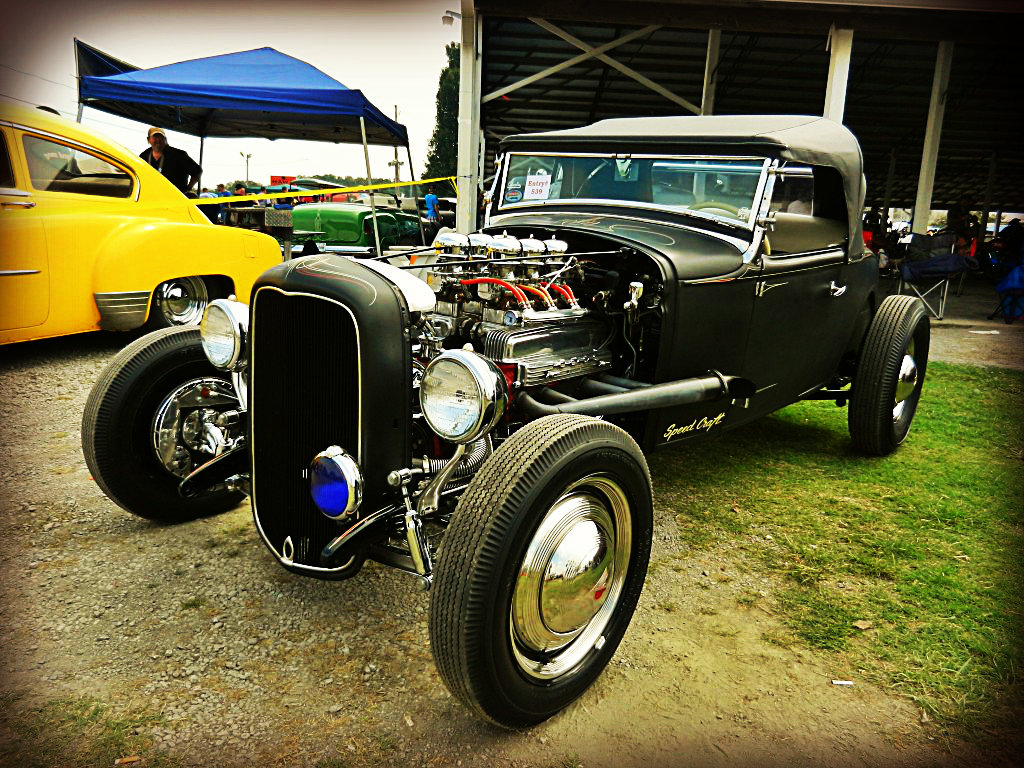

    Agree with strengthining the frame with an x member. Building a steel cage inthe body as well. Thats what I am going to do to my roadster when i do it over again. It flexes too much on these crappy New England goat paths!

    So, you can easily remove the body? Cool lookin' roadster, btw.
