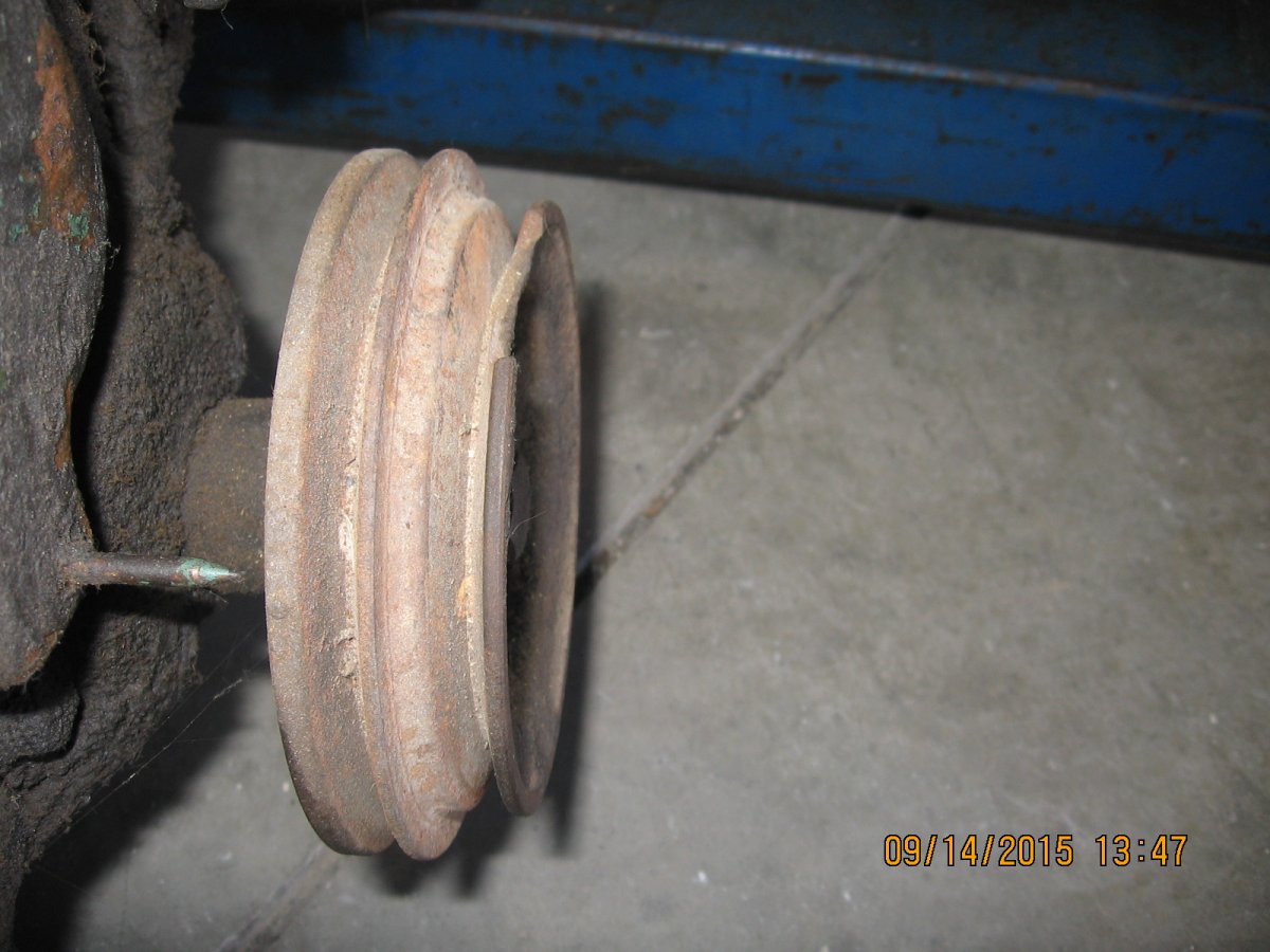

    I pulled my '51 Mercury engine out of storage last week in preparation to putting it on my test stand to see if it runs as good as I remember. When I pulled it out, I saw that the crank pulley had a chunk broken out of it. I just missed one on e?ay, so I am wondering ; "Can this be fixed?" Are these cast steel or cast Iron? Could I cut and grind a chunk of metal and weld or braze it in? (I don't have the broken chunk.) Has anyone ever done this? I'm retired, so I have the time, and I kind of like fiddling with stuff like this. Any suggestions or opinions are welcome. I think I may have another one like this in a box somewhere as well. More garage stuff 001.JPG More garage stuff 002.JPG

    Probably fixable (anything is) but not worth the effort. Keep in mind that once you weld it, the pulley will no longer be balanced which will be bad when the engine is at speed. Easier to replace and put your labor into other places on the engine.
    It's an unusual form of damage. I'd be concerned that the chip was a result of the engine being dropped at one point and possible harm to the crank.

    Your pulley is the cast version and would take pre-heating and a special welding rod to repair..

    After its welded, what are you going to do for the balancing? Last time I checked, the nickel rod was about $10 a stick, they came 3 sticks to a pack, and your probably going to need several sticks if you plan on building that area up with welding rod. There will be a lot of time used up to make that missing section with rod. Then don't forget the grind time to dress it back into shape and its still probably going to be out of balance. I run a welding shop, I'd buy the e bay pulley. Gene

    I used Ni-99 rod to repair one. Tig welded it withNo issues at all with a light pre heat-post heat. Any machine shop could spin it on their balancer for a few bucks but with the operation range of a flat head and the factory balancing what it is,why bother.

  16. Cast iron or steel you can still cut and weld or braze a piece of mild steel in there. I am going to guess it is cast iron, a simple test take a small drill bit and drill a hole in it, cast iron will come out in charcoal gray dust and your bit will stay cool dry, cast steel is harder and your chips will come out as chips and you'll need to oil it to keep the bit cool.
    if it turns out to be cast iron there is some really neat rod for welding it. let me know and I'll get you the numbers on it. it is way easier than nirod. It is a little pricey and many welding supply houses will sell it by the rod if you can't find it that way I'll try and snipe you a couple of sticks from a friend.

    Before you waste any time repairing the pulley, clean it up and check for cracking along the crank snout, as a couple of mine were. These pulleys were on all '50-'53 Ford and Mercury V8 cars, so they are not rare or expensive.

    Then just shape and braze a piece in there(of mild steel) and have a machinist true it up. I would not be worried about the balance issue as this engine is apparently not a 6 or 7000 rpm application.
