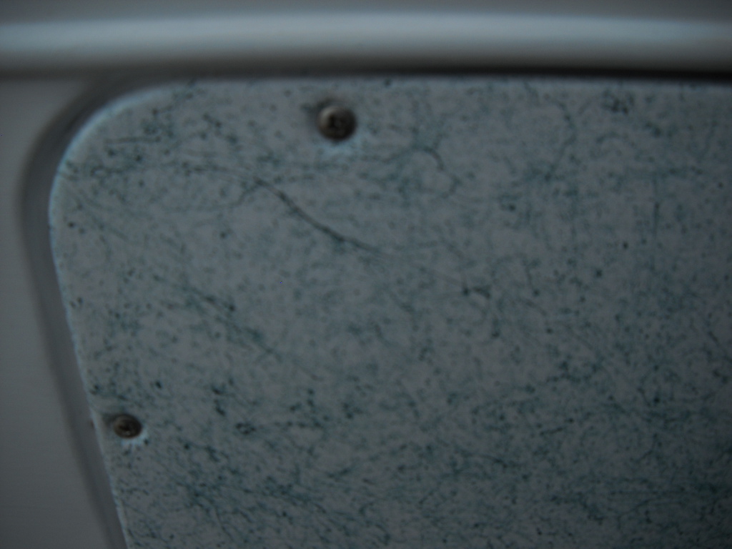

  24. I still do cob webbing for accent pieces, always liked the effect. Getting harder to find lacquer paint though.....

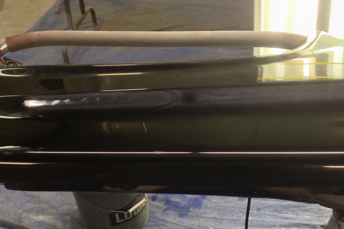

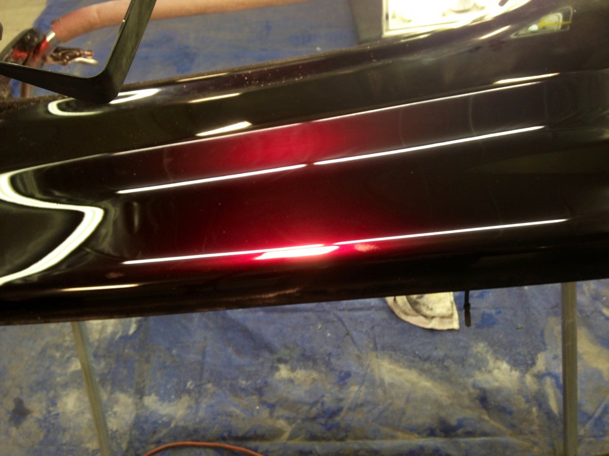

  29. Highly unorthodox methods
    just shop lights
    500 watt halogen ^
    Outside in the morning.
