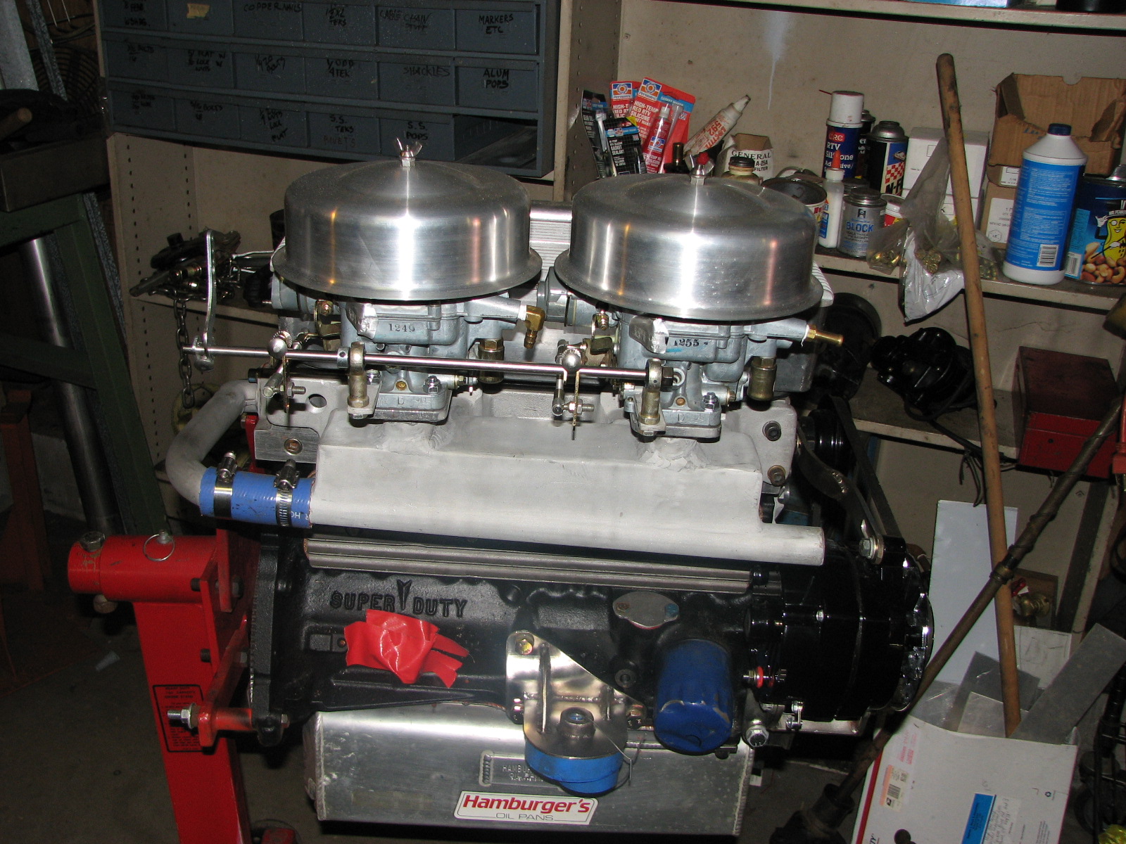

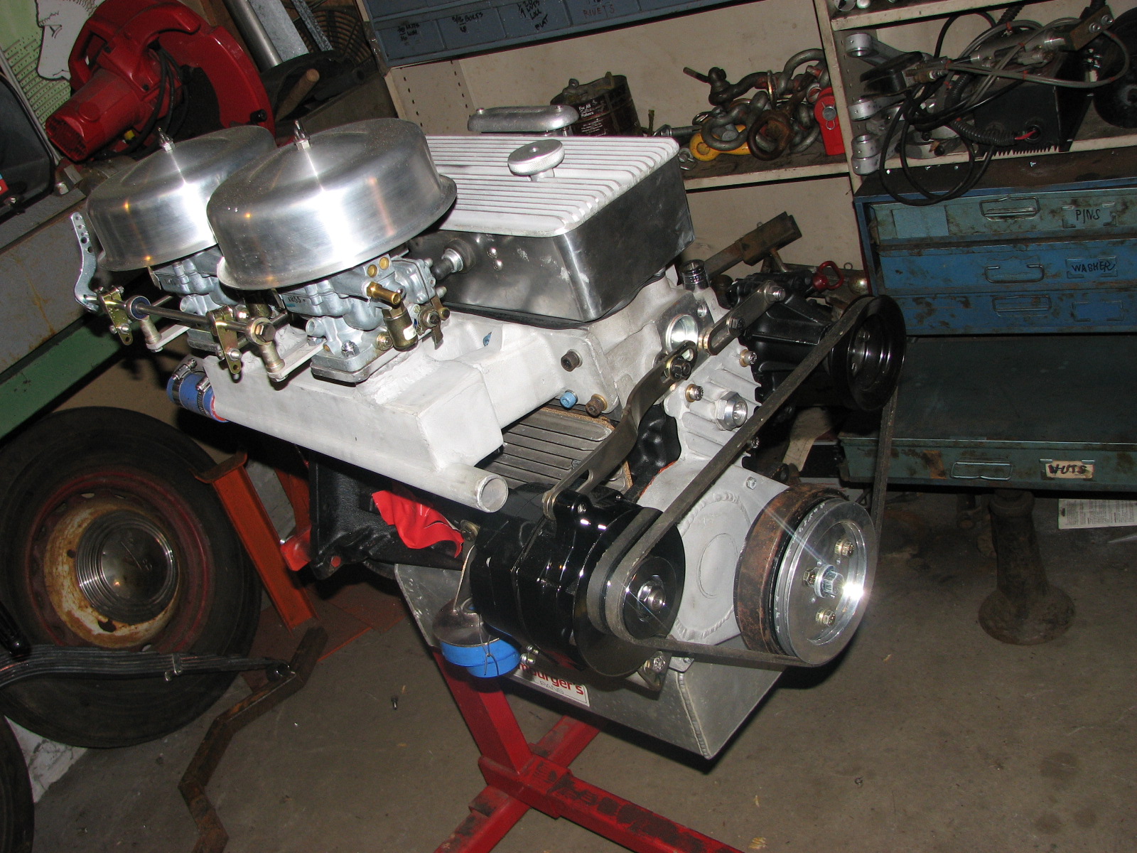

  8. wideglidejoe
    Joined: Oct 28, 2007
    Posts: 58
    wideglidejoe
    Mine isn't a SBC, but here's my pic anyway.
    It's a 428 FE stroked to 462 cu in w/four 48 IDA's.

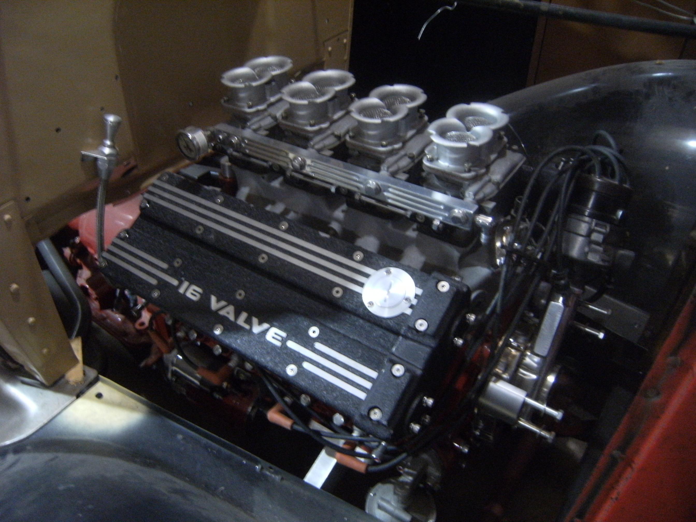

    Inglese webers and front drive dist.

  16. Duntov1967
    Joined: Oct 25, 2013
    Posts: 49
    Duntov1967
    Paul may be messing with us. Although they look similar to Moser heads, the plug wires are coming out the side, not the top. Not a Hemi head. And it says 16 valve, not 32 valve. And why twin cam for only 8 valves? Maybe a 4 cyl. head sat on top of the SBC? LOL

    Joined: Dec 1, 2010
    Posts: 3,490
    paul55
    from michigan
    65' 327 with inglese "maserati setup" and Summer's Bros. front dist. drive. Valve covers are the ones Gennie Shifter had about 30 yrs. ago. "Fake" dual overhead cam covers, but I thought they would look good with the webers, so have been looking for a few years for a set and finally found these. Makes the sbc look exotic, I think. Thanks for the nice comments all!

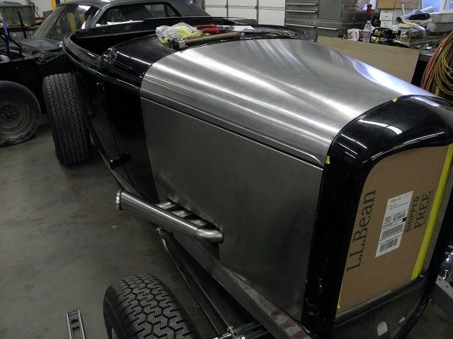

  27. Another Ford system converted to dare I say EFI.
    70 boss 302 going in our 32 Roadster

  28. big duece
    Joined: Jul 28, 2008
    Posts: 6,830
    big duece
    from kansas
    Nice! Like to see the '32 they are going in.
  29. Got a ways to go.
    daddio211 likes this.

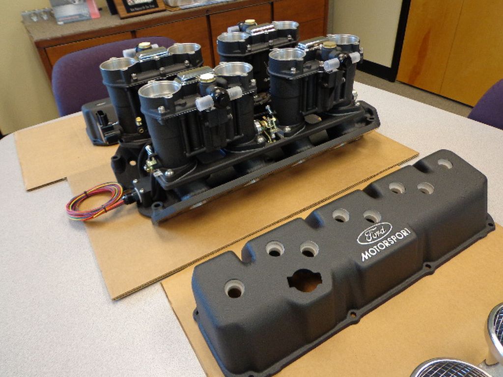

  30. Yep you can buy trhe complete setup from Jim Inglese. Part number 4x48IDA
    jiminglese.com or 203 623 0659 it is $4.650.00
