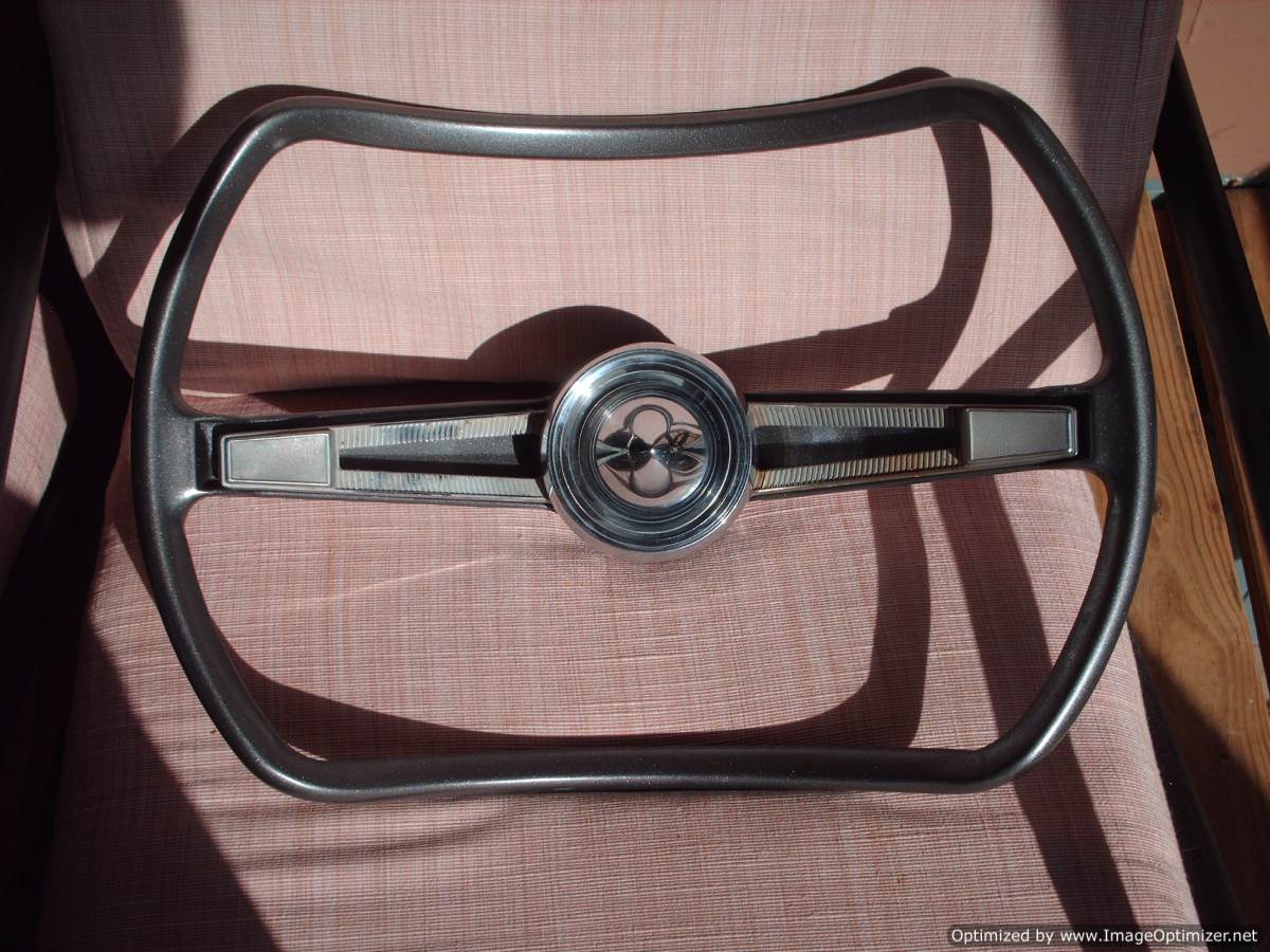

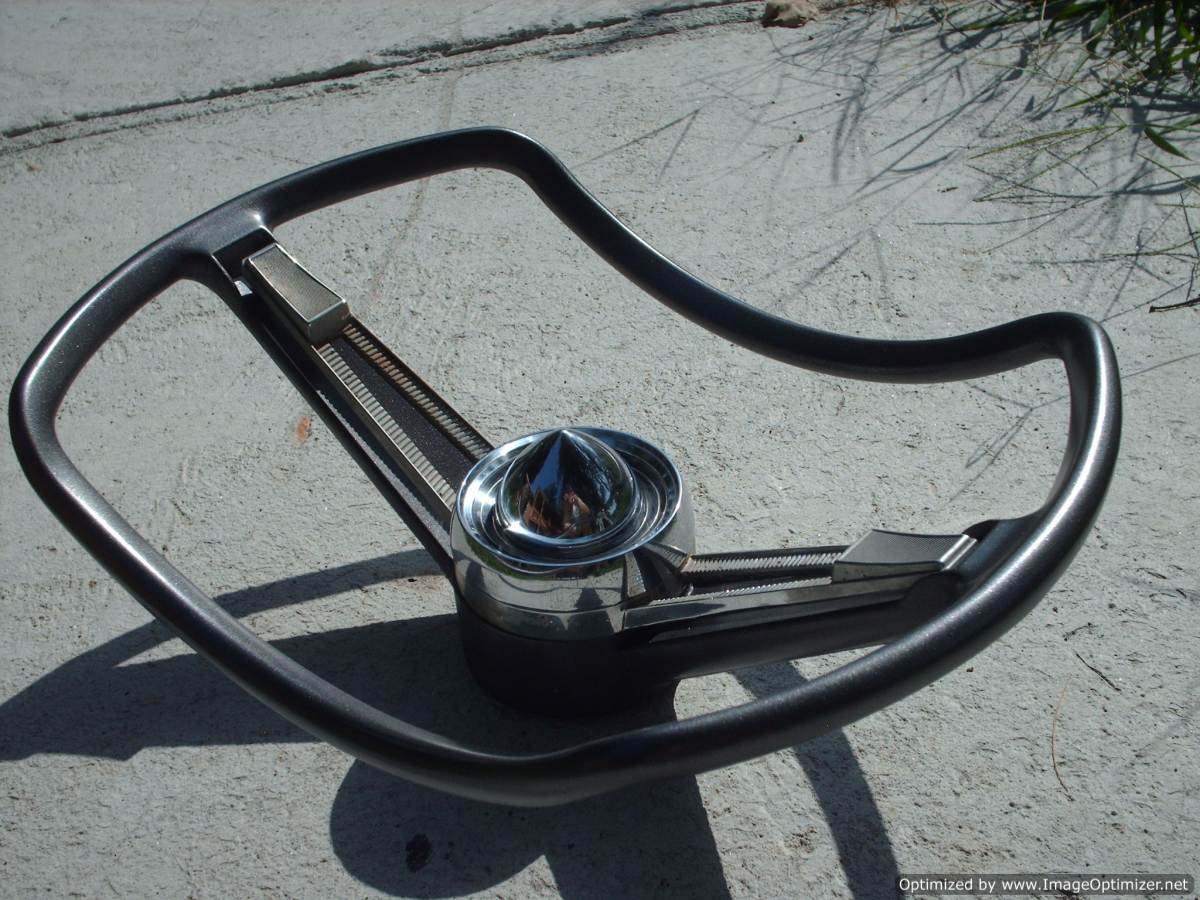

    Still need to clean up the chrome on this one but it's done otherwise. No finger grips on this one, it's smooth. Thats the way I like it.:cool:

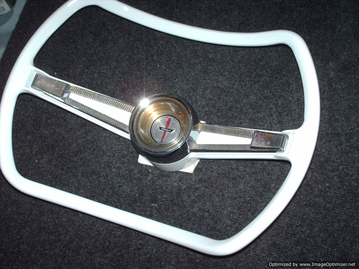

    Heres Triamp's wheel with some paint on it.

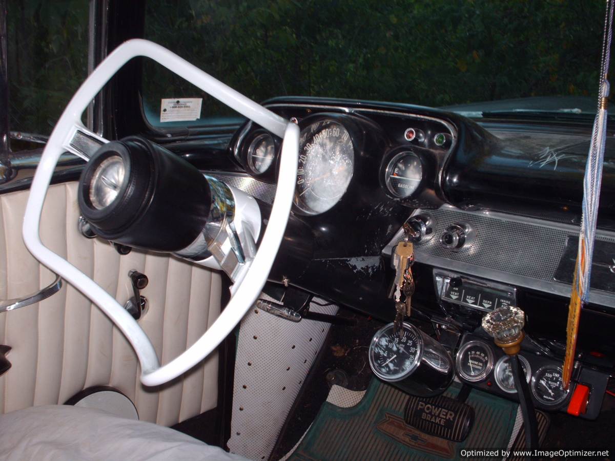

    I painted the grey wheel white, put on a '62 horn cap and polished the chrome up. Looks pretty snazzy now I think. And it's for sale. :D

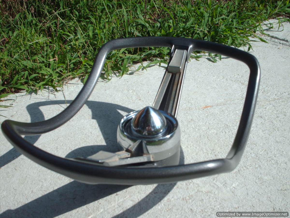

    Heres a shot of my new reterded wheel that everybody hates, which makes it awesome to me. The first pic is with a regular horn button (Lame) the second is with this recockulous thing I got off of a Galaxie. I'm going to use it to cruise up to the swap meet tomorrow and see who I can piss off.

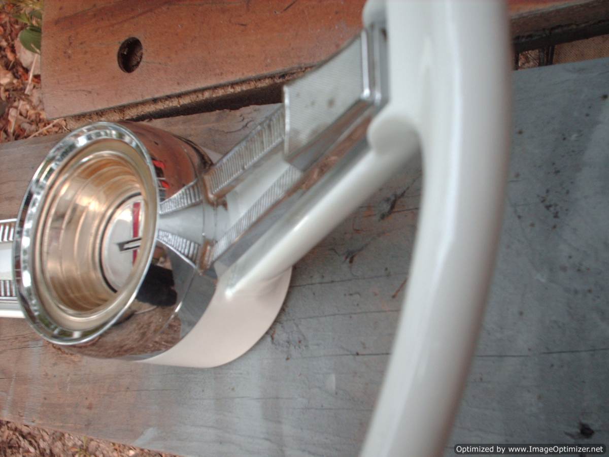

  15. Had DOGDISHDELUXE send me another one of his badass square wheels for my Tall T. I chased down the last of the cracks by grooving them with a file, cross-drilling both faces of the grooves and filling it with JB Weld two-part putty-style epoxy. I then sanded it with 100-, 200- 320- 400 and 600-grit paper, with primer passes in between. Final imperfections were filled with JB Weld two stage goo, the kind that comes in two squeeze tubes. The horn cap was a 40's Buick Ebay find and after a round of naval jelly and polish, this sucker is looking good enough for my lil' driver. The paint color will be determined later, either metallic red, eggplant, or pearl white. CLICK ON PIC TO ENLARGE.
