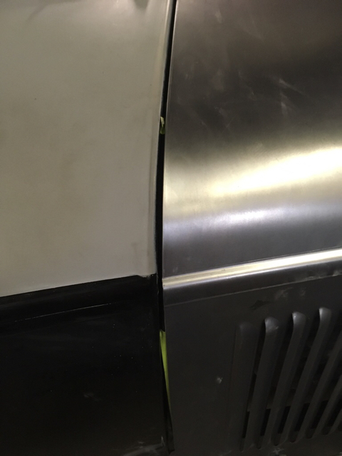

    Just got my hood doesn't fit terrible. It will take some fitting

    I love your optimism! I spent the equivalent of probably a day going from "not terrible" to, "not bad but not really good either". 17523718_10213176088859450_3466695362694935998_n.jpg Another day got me to "I guess I can live with this..." Cool car!

    I think 34 hoods are harder to fit more curves. I think I got my fitting pretty good or good for me I just have to put the hold downs now. [​IMG][​IMG][​IMG][​IMG]

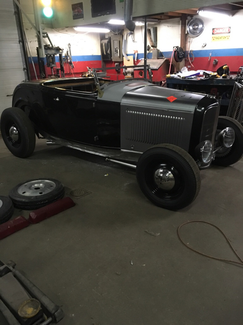

    That '32 looks good just sitting there...All the proportions are excellent. Pipes exit in a 'cool' place, frame rails fit the body like factory.
    Little more 'adjusting and massaging' on that hood, gaps will line up nicely.

    Looks great.

    thanks I'm trying. hoods sill i little tight at 2 comers. i think 27s are just as cool as a 32. heres a pic of one I'm building at the shop
