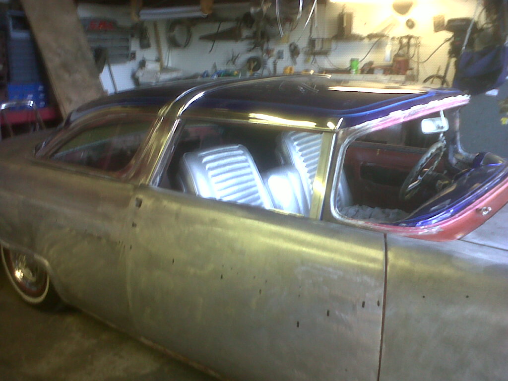

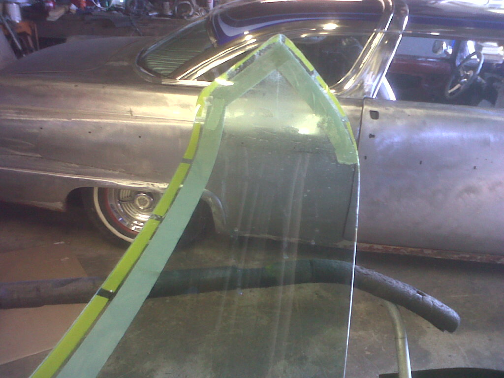

    I cut my own glass with a rotozip and diamond coated router bit. Check it out. I leave the glass about an 1/8" large all around then take it to a glass shop and have them sand and polish the edges to finish the glass. Check it out. Its towards the bottom of the page.
    http://www.jalopyjournal.com/forum/showthread.php?t=713213&page=5

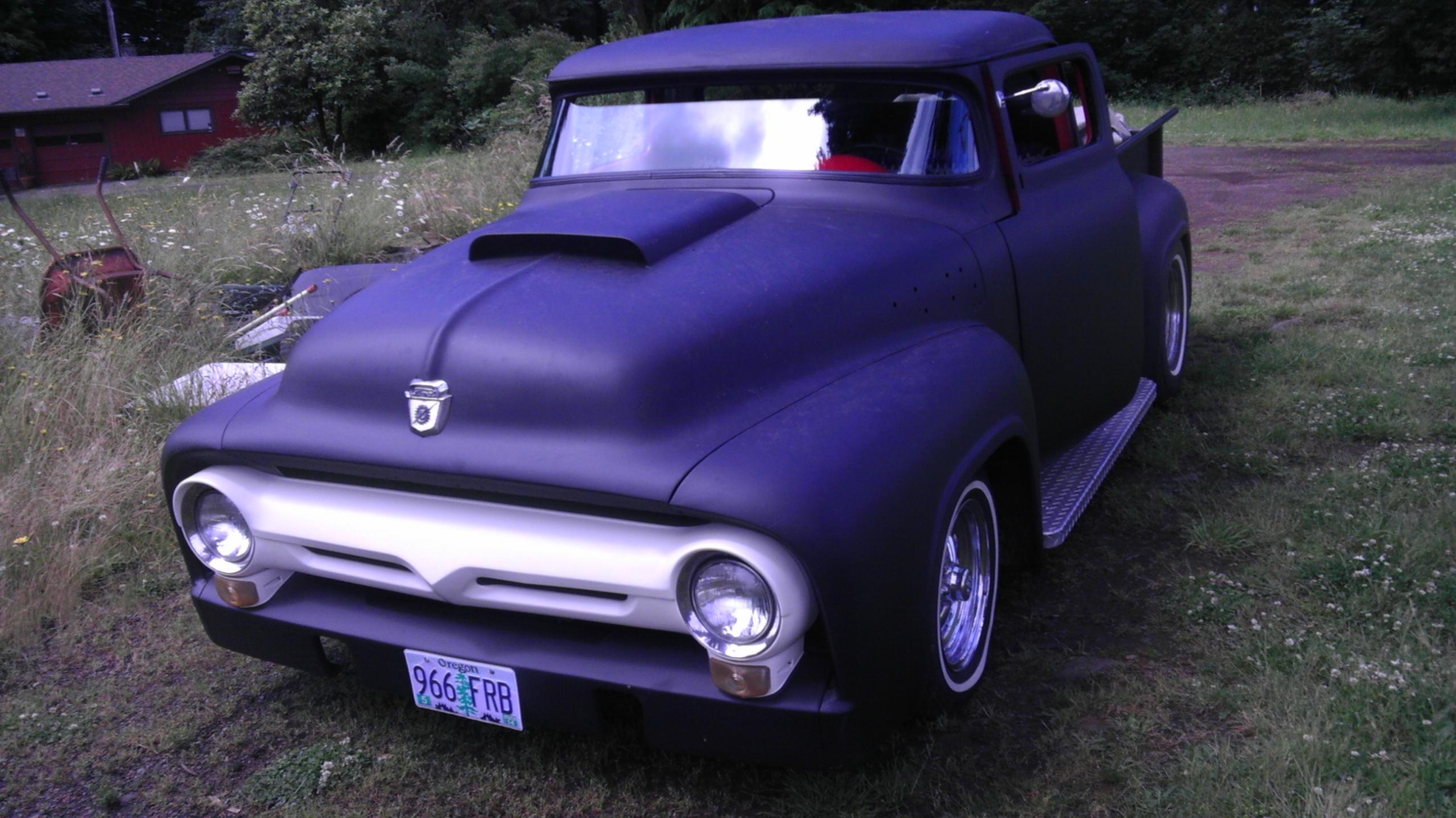

    I am an old gray hair myself and I have cut many windshields some went good and some went bad. The last one was a 54 Ford F100 that I sand blasted and it came out perfect, it sat on a table for a week then was transported to the guys shop to be installed, everything was fine till I walked away from it after setting it on a blanket on a table and it just snapped in half all by itself. So I have kinda been there done that and I am very interested in seeing if the water jet works any better than all the other tricks everyone has tried. Always willing to lean a new way.
    Thank you for the info with the light seeing the distortions and I have to admit I never thought of cutting 1" off the top and 2 from the bottom, see ya learn something every day even an old bastard like me.
    Just want to try the water jet, hey it might be a waste of time but I will know for sure.
