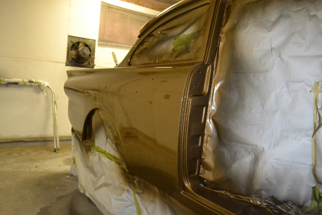

  22. sierra rod shop
    Joined: Feb 16, 2011
    Posts: 381
    sierra rod shop
