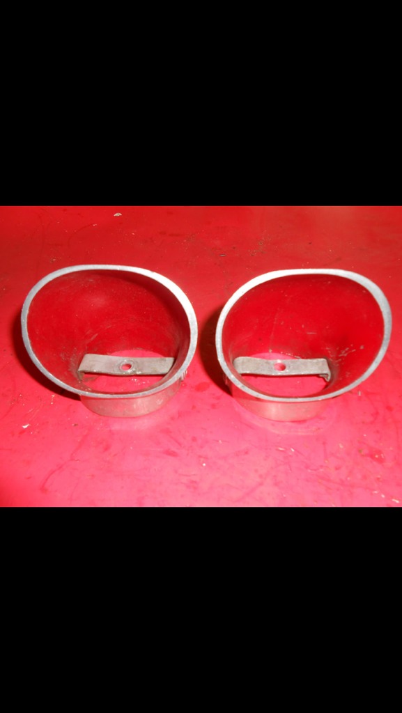

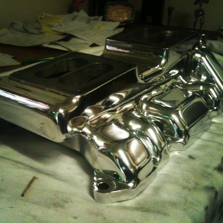

    So time of a few updates. Got my intake back from polish and I'm stoked. Came out killer. Here it is and a pic of it and my valve covers on the motor. Still gotta paint the block/heads and finish assembly. Also I found an original set of frog mouths for my 97's.

    They did a great job on that intake and that motor is going to be gnarly in that sedan!

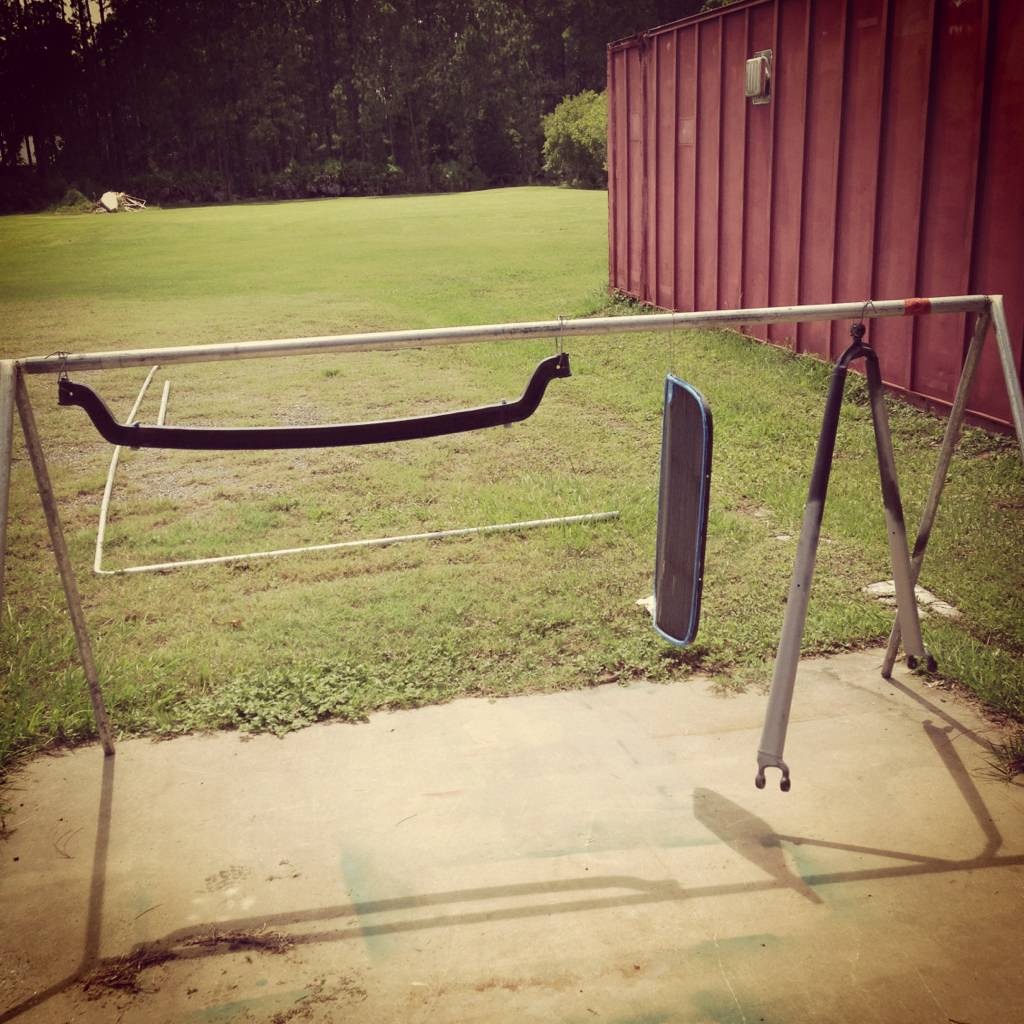

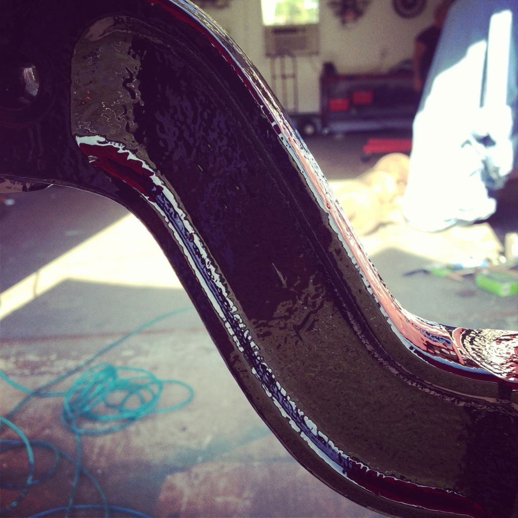

    So got some stuff sprayed today. Axle,wishbone, and insert. Shiny black and it looks good. ImageUploadedByH.A.M.B.1369435988.806595.jpg ImageUploadedByH.A.M.B.1369435999.451434.jpg ImageUploadedByH.A.M.B.1369436009.301221.jpg ImageUploadedByH.A.M.B.1369436021.601112.jpg

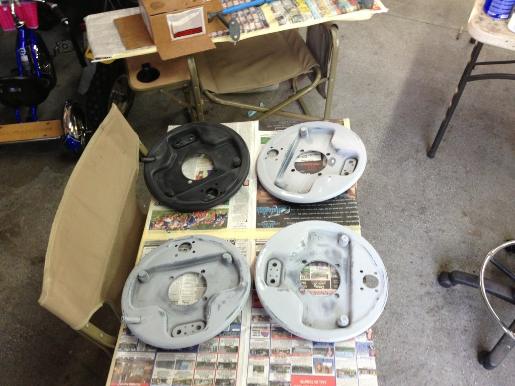

    So making a lot more progress now. Got all my backing plates broke down blasted and primed. Now they are all prepped for some shinny black. Got a lot of smalls prepped too. ImageUploadedByH.A.M.B.1369706261.265890.jpg ImageUploadedByH.A.M.B.1369706274.048373.jpg

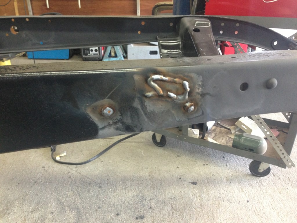

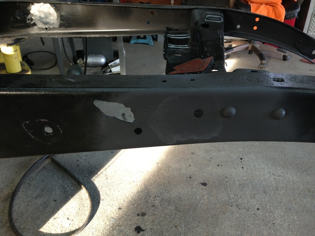

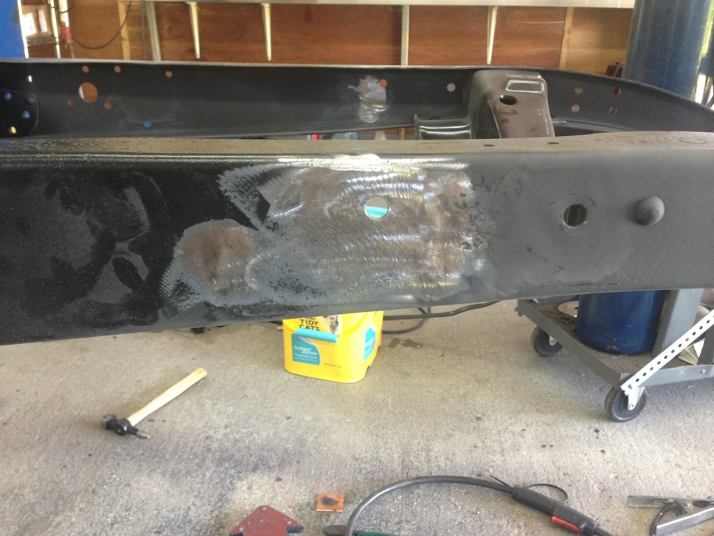

    Got the welder out too and put the frame on my lift. There was a ton of extra holes a few hair line cracks and someone had blew a big hole in the driver side for a different steering box. Also I'm running Original 32 front shocks and only had one good hole so I had to weld patches in where the back bolt was ripped out on both sides at one time.
    Also some one had bobbed the rear frame horn and gas welded them back on. Had to clean them up and sure up the welds. Now all I gotta do is weld in the motor mounts and figure out trans mounts and frame is done. ImageUploadedByH.A.M.B.1369706679.914871.jpg ImageUploadedByH.A.M.B.1369706692.981488.jpg ImageUploadedByH.A.M.B.1369706715.648113.jpg ImageUploadedByH.A.M.B.1369706773.148598.jpg ImageUploadedByH.A.M.B.1369706799.081880.jpg

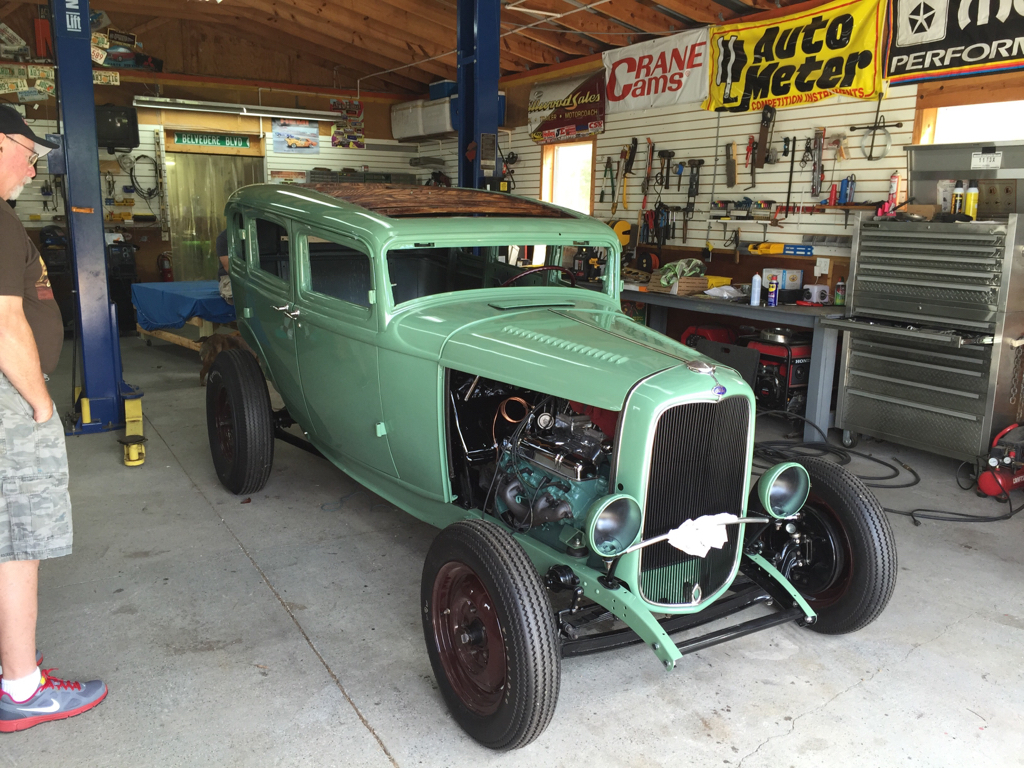

  23. satans angel
    Joined: Feb 16, 2008
    Posts: 128
    satans angel
    Been a minute since I posted any thing but been plugging. It's close grew more things and she's done. Here is one teaser pic till its 100%. Last time body meets frame.
