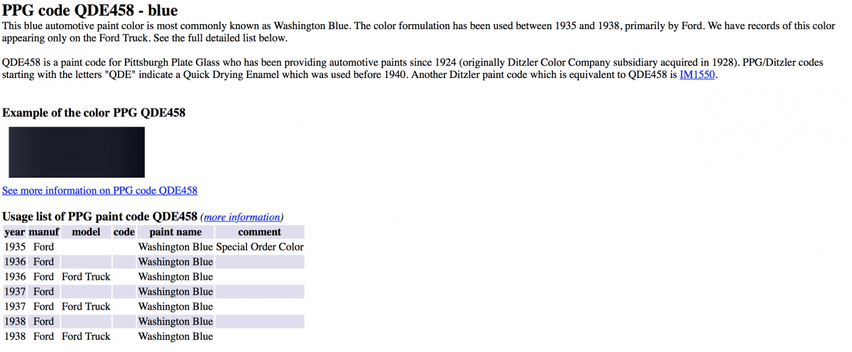

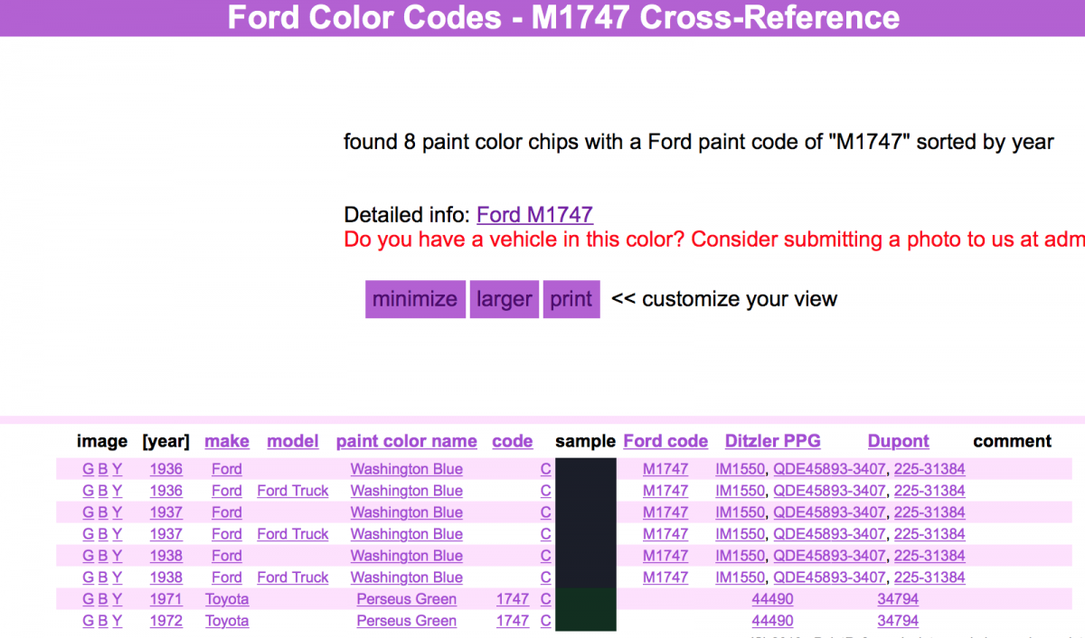

    I need some Washington blue M1747 or the slightly darker Dearborn blue M1723, both mid 30' Ford colors, for a project I'm doing. Single stage DCC acrylic urethane.
    I'm trying to find the new/updated paint codes for PPG.
    The old PPG codes (QDE 458 and QDE57) codes I have, seem to no longer work according to my local paint supplier in Austin TX (Tasco Paint supply).
    Can anybody help? I'm also looking for some paint chips so I can actually compare the two colors side by side, since my only reference right now, is pictures from the internet.
    Also, is there anybody out there who would be willing to mix and ship approx. 2 gallons once I make up my mind.
    Thanks
    PS: Codes below do not work anymore??????

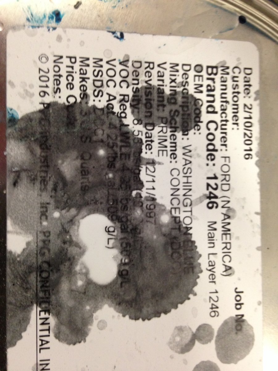

    The DCC code for Washington blue is 1246

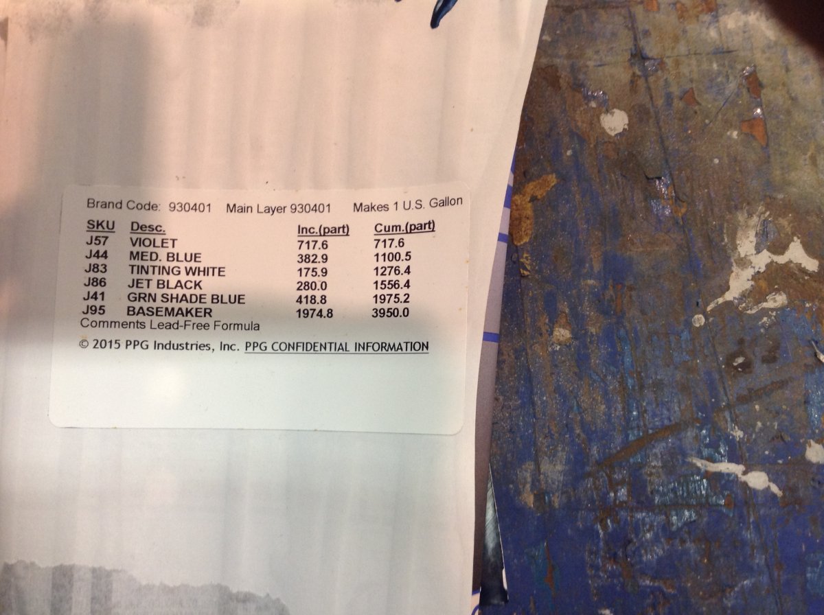

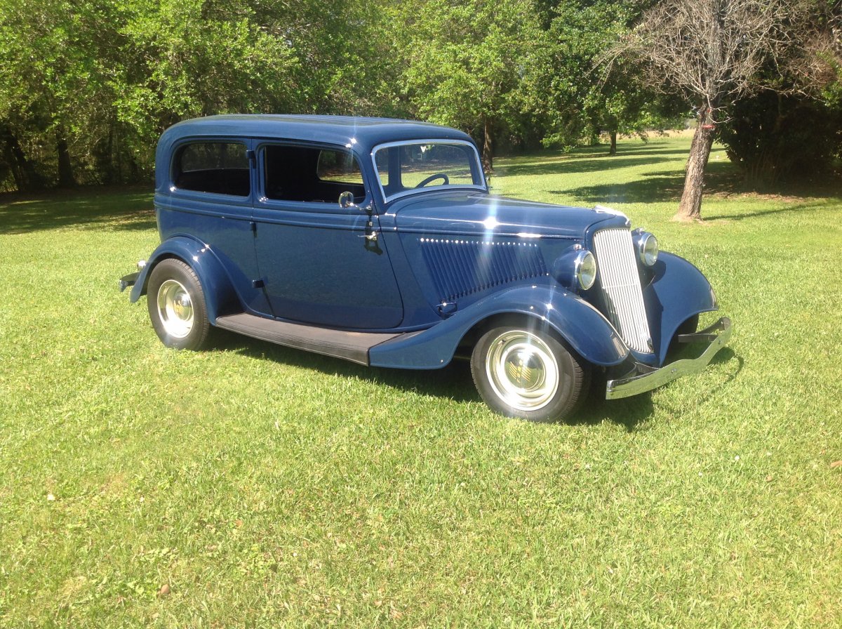

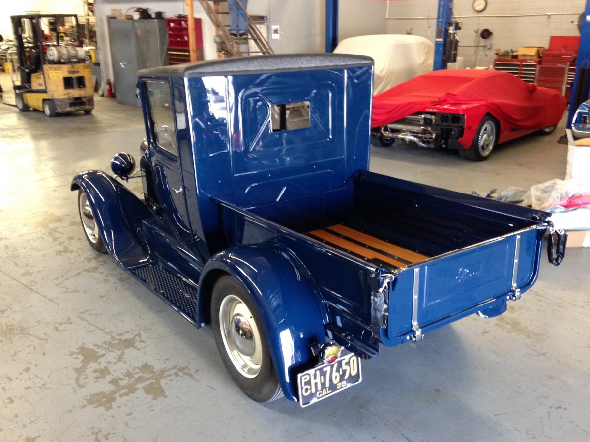

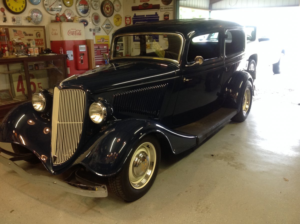

  11. Chris here is the paint code PPG for what was listed as Washington Blue 1935. Also a few pictures of it on my car. Looks different depending on the light. image.jpeg image.jpeg image.jpeg
