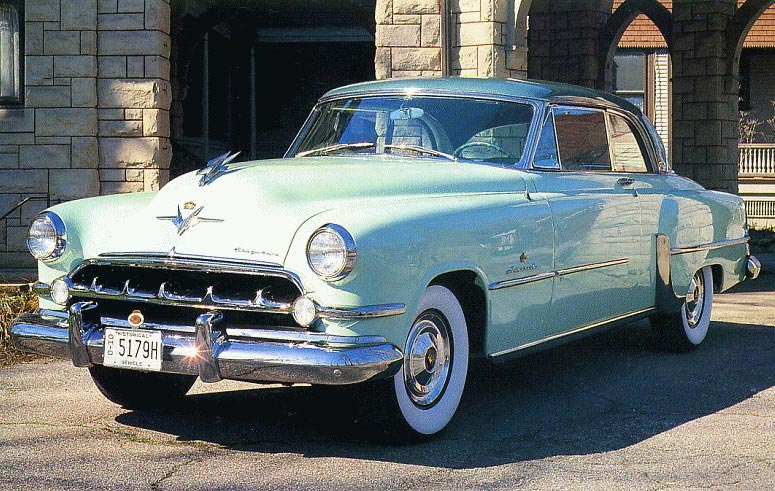

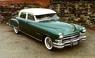

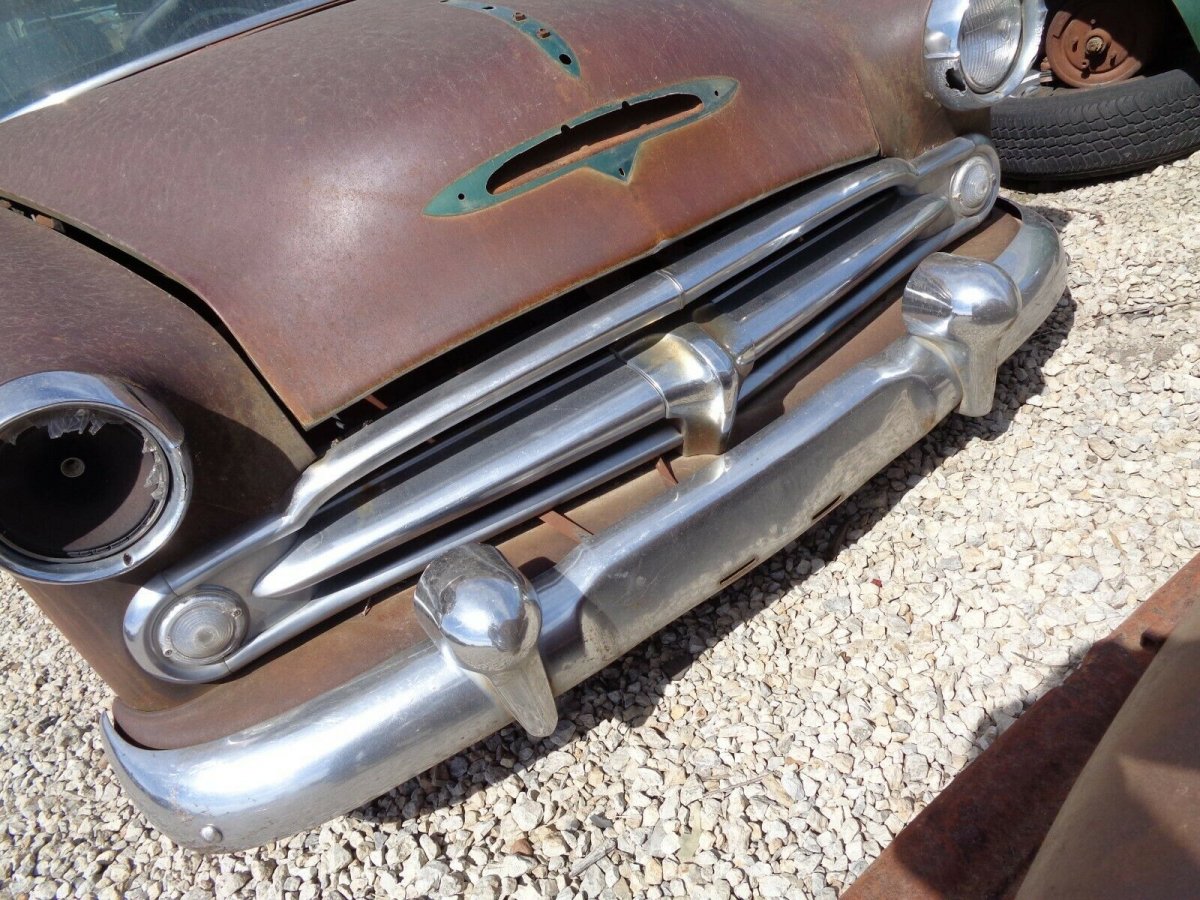

    What has two thumbs and buys parts for a car that's not even in their garage yet? Maybe this guy... I'm not now, and never have been, crazy about the toothy DeSoto grill. Several of my pals have kidded me about the car coming with a Mercury grill, and a couple of guys WITH chopped Mercs have already asked if I'd sell the grill! It's tempting. This one, a Dodge, is on eBay, and a FB friend sent me a link to a CL ad in ND for an Imperial grill with the park lamp bezels. Best of all, they'd deliver it to the town in MN where the wagon is! This is fun already, and I don't even have it here yet! :p s-l1600-2.jpg CustomNewport.jpg

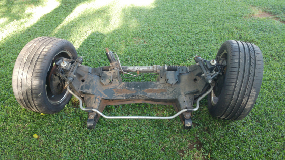

    If you update the trans, you will loose the e brake. So you will want to change the rear end. Mopar B body donors are good, so are early Dakota, Jeep, and explorer if you are contemplating 4 wheel discs. Early Daks can also be a good front clip for rack and pinion and front discs and just about any Mopar engine .If you stay stock frame up front you will find it boxed. Ford aerostar front springs and moving the lower spring mount to the bottom of the a arm will give you about a 2 inch drop. Early 50s Ford F1 shock mounts can be used to improve front end ride. Also early Cherokee front sway bar will work to update the front end. If you change the wheels mind the back space on the rears. max depending on aspect ratio is 4 inches. A few folks have used rwd Mopar police spec wheels and 225 75 15 rear tires to good purpose. I believe they are 7 inch wide.

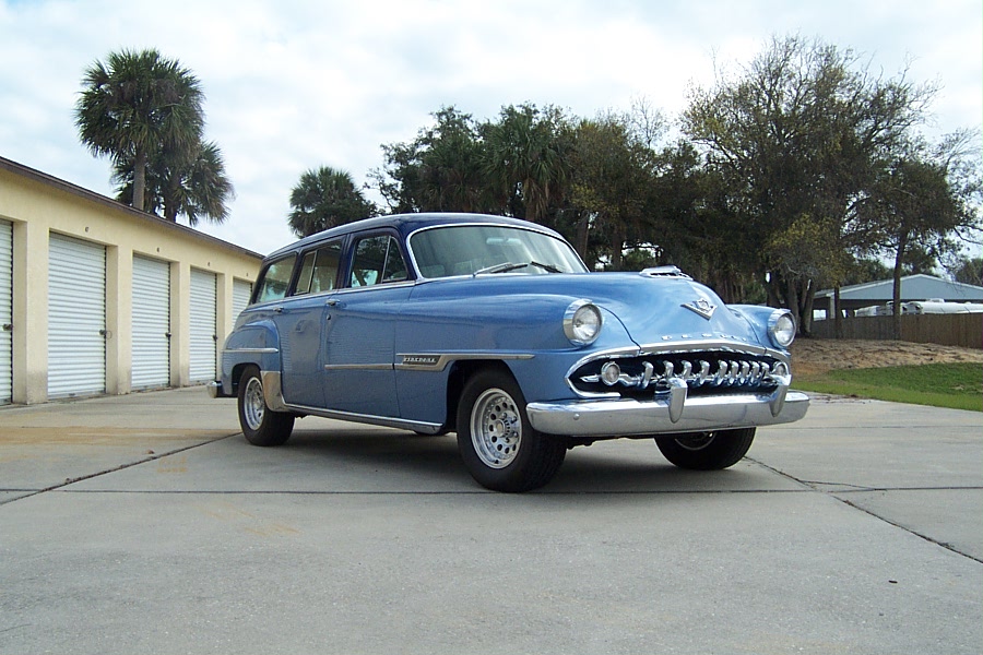

    B bodies are the mid 60 coronets, chargers, belevederes, satellites, I've got a chart some where I can dig up but 5 boltb Daks and 80s Cherokees (not grand) are proper bolt pattern, if you can find a mid 80s 2wd drive 4.0 Cherokee they have a 355 to 1 limited slip Dana rear unit. The explorer, ranger are correct lug pattern. All the above are one half to 1 inch difference backing plate to backing plate. Spring perch surgery required.
    I did see on line some one is now doing a narrowed crown Vic front cross member down to 61 inches if I remember correctly. Not traditional but the bolt in members carries all steering and front suspension assemblies. If staying stock up front the alternative shock mount fixes most of the boulevard float associated with the 40s and 50s Mopars.

    I’m the same way! Never cared for the toothy grilles! I like that top one on the rusty front end.

    I'm going to hit our local Light Truck U-pick yard for an Explorer or Jeep axle, limited slip would be the ticket, if I can find the 2WD square Cherokee that'd be ideal. Thanks for the tip! I've found a roof rack too. I had thought the first gen Dakota's were 6 lug, I had one (new), but that's a LONG time ago, I can't remember what it was! Good tip on the narrowed Crown Vic front, I narrowed a Chevy pickup crossmember for my Diamond T pickup, so I think that job would be in my wheelhouse...
    EDIT: OOPS! I didn't realize the Crown Vic crossmember was aluminum. Back to plan A, Keep it Simple Stupid, and use Scarebird front disks and leave the thing alone! :p
