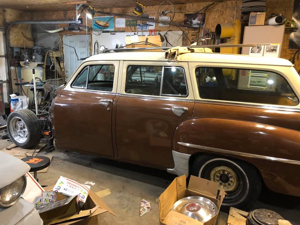

    83987391_10222190574855966_2978607893344944128_n.jpg This project is all up in the air. Borrowed a second old Blackhawk bumper lift jack from my buddy and got 'er up off the ground to start deconstructing. It's super solid underneath, body has been off, all new body insulators, frame painted, new brake lines, fuel lines, wagon only tank looks great, brake booster looks like brand new. Somebody out there wants and needs all this restored MOPAR stuff, where should I look to try to make sure it gets a good home? Any ideas?
  3. Hey Brian you sure don't waste any time! If this thing turns out 1/2 as nice as your Pontiac it'll be a show stopper. H.a.m.b. Classifieds or Hemmings the unwanted Moparts will find the right home. I think in 2005? Ford 8.8 went from 28 spline to 31 spline...might keep that in mind when getting a TX axle. Can't wait to see the progress!

  4. Hnstray
    Joined: Aug 23, 2009
    Posts: 12,355
    Hnstray
    from Quincy, IL
    Explorer axles are 31 spline from at least the mid '90s and possibly a few years earlier.

  5. Hnstray
    Posts: 12,355
    Hnstray
    from Quincy, IL
    @FlynBrian ......looking at the photo the front wheel bolt pattern looks like the 5.5" bolt pattern vs the more common 4.5" pattern. That 5.5" pattern was used on Imperials, New Yorkers, Suburbans and the wagons. Those wheels could/would be useful for early Ford applications.
    Love your repowering plan.....
    Ray
  6. flynbrian48
    Joined: Mar 10, 2008
    Posts: 8,240
    flynbrian48
    Thanks Ray! I'm really excited about it, and my wife is 100% with everything, which makes it easy to justify big packages arriving every day, and piles of receipts! Hmmm, I'd better check that bolt pattern out. I didn't even really look , did not know wagons used a larger bolt pattern! I'm doing the front end too (Morrison), so I can make both ends match no matter what, but I was going to use the original wheels, but that shoots that plan. I'm definitely using the DeSoto wheel covers, so a little wider wheel wouldn't be a problem at all. I have 3 15" Ford rims, just need a 4th, extras from our son's Galaxie wagon. I assumed 4 on 4.5, but you know what happens when we assume...

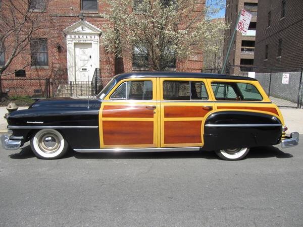

  26. [​IMG]
    Brian,
    While I've never been a big fan of the early 50's Dodge/Chrysler/DeSoto wagon's body style,
    the Woody treatment changes ALL of that... don't know exactly why, but it REALLY makes those lines flow!!!
    GO FOR IT!,
    Bill (aka, Mac the Yankee)
    john W., Hemi Joel, i.rant and 4 others like this.
  27. flynbrian48
    Posts: 8,240
    flynbrian48
    Bill, I showed that picture to my wife, all excited about it, she was not just cool to the idea, but frozen. "Nope. I don't like that, and, it's my car." LOL, so, no woodgrain for us on this one. I have to admit that studying it, I kinda agree that it makes it sort of chopped up looking. I tried though...
