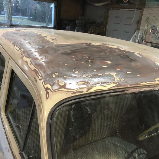

    131172592_10225444770328819_3299386654611070521_o.jpg Well, sure enough, the roof was used as a trampoline, and had 1/2" of Bondo, on top of the original paint of course. LOTS of pressure ridges where somebody pushed up the caved in sections, and LOTS of little divots, seen here as paint spots. It's a mess. Shrinking disk? I don't have one but always thought I needed one. Now I'm pretty sure I do.
  2. Johnboy34
    Joined: Jul 12, 2011
    Posts: 1,589
    Johnboy34
    from Seattle,Wa
    A stud welder also, pull up those little divits first then hit them with a shrinking disk.

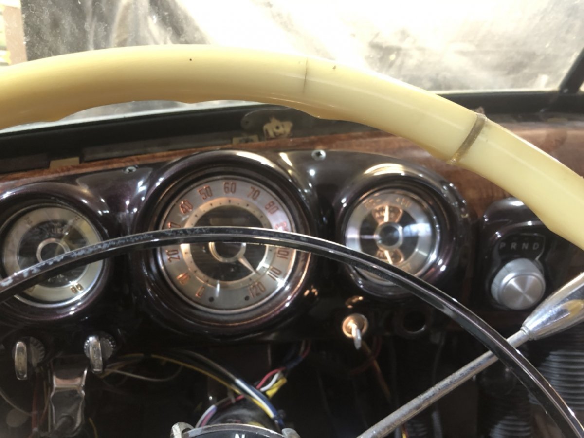

    My 49 Buick is very similar. Just got my,gauges back from the instrument shop.

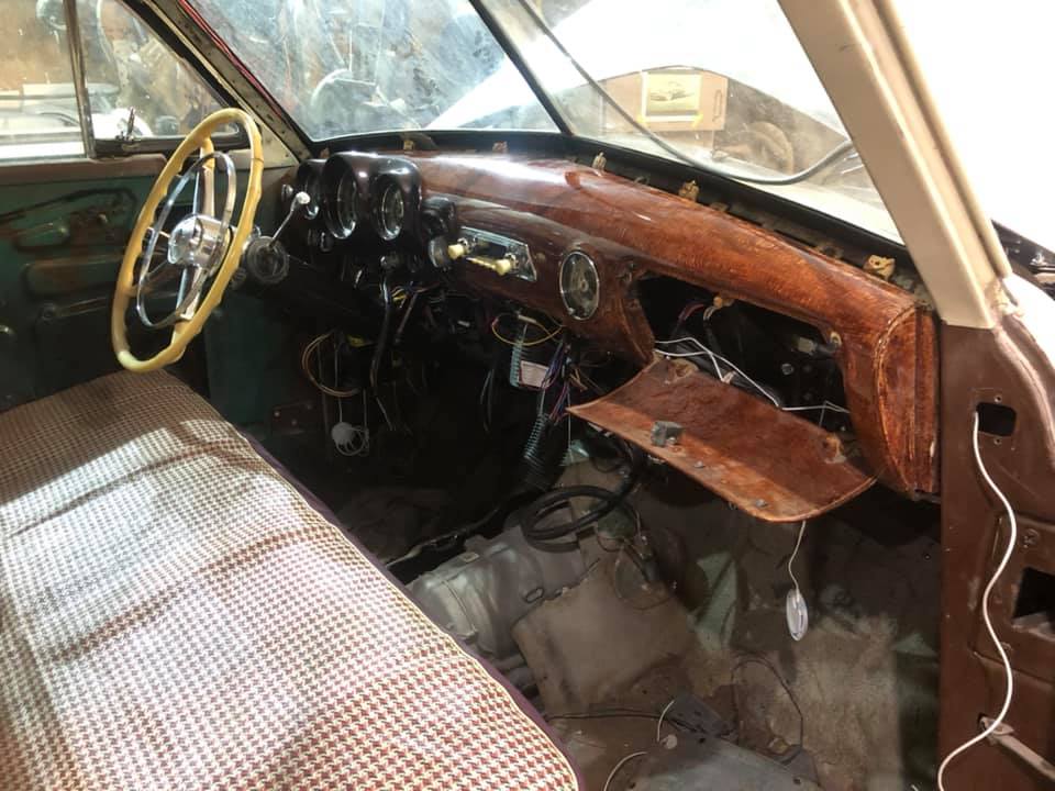

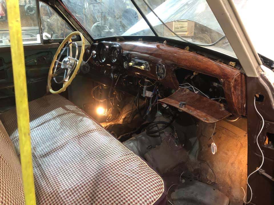

    Never mind the dangling wiring and general mess, but I finally got something done today. The courtesy and dome lights in the DeSoto are wired, and, even better, all the magic smoke stayed in the wiring and the little lights come on with every door opening. I'll put cargo lights in the rear, and ran wires for those too. This, and getting the actual year of the rear axle, and the CORRECT brake parts ordered, I feel good.
    Oh, and the shrinking disks I was waiting for to get the trampoline dents out of the roof came too, so tomorrow we're gonna rock.

    I know it’s hard to see, but I put the new shrinking disks to work on the VERY stretched out and “oil canning” roof of the wagon. In just a few minutes it’s reasonably flatter, NO More oil canning with even heavy pressure. I’m kind of torn right now between a bit more work and raising the couple of very minor low spots or calling it good and skimming it. It’d be a little more than FeatherFill will take care of, just enough to feel. I’m very happy with this addition to my tool kit!

    An almost ripple free roof!
