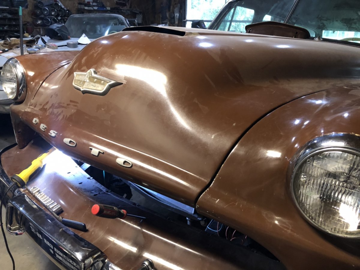

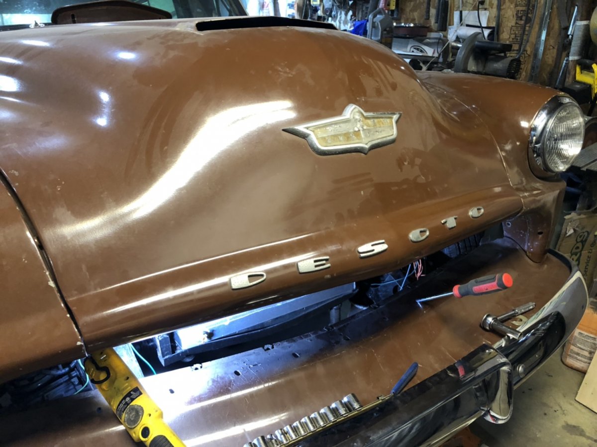

    Got the hood aligned. Sort of. Gaps are pretty even at the corners, the right side pulls away from the fender in the center. It’s even on the left all the way down, so I don't see how any fiddling with the adjustment of hood and/or fenders would help. Looking at photos when it came home, it’s MUCH better than when I got it here. Short of welding 1/4” round bar to the hood edge to make it fit, it ain’t gonna git no better...

    Welding 1/8" filler rod and then grinding it to the contour will do it. It's a lot of work. I've been screwing with my Buic is hood for days to try to get the gaps right and not have edges rubbing. Those damned side latch hoods are diabolical!
