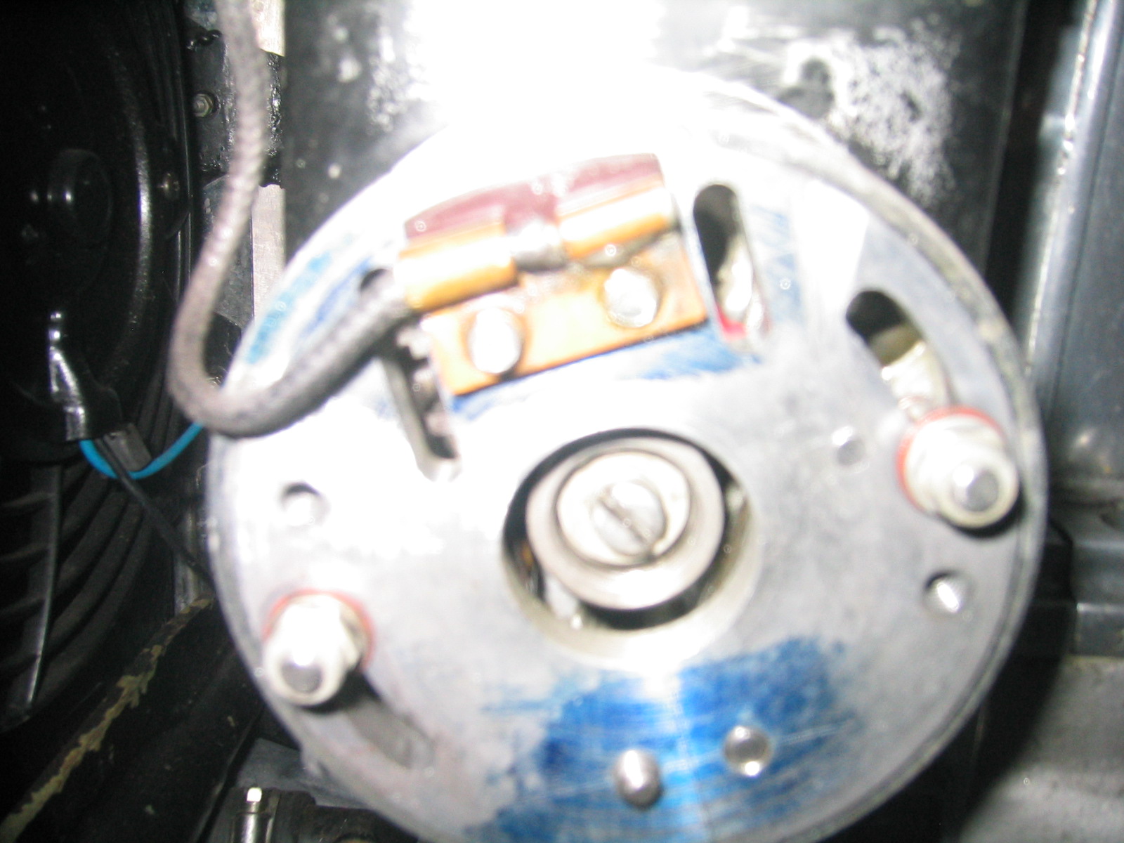

    Finally made some progress on my chevy II midget. I Re did the injectors with larger nozzles, reset barrel valve etc. It started right up with the on board starter and ran Ok. It is a brand new motor that has not been broken in yet. The problem is now it started to over heat with a head temp of around 280 within a minute or two from starting it at 50 degrees out side. Plugs are brown to black so I don't think it is very lean and the mag is set at 16 degrees for easy starting. Water pump is pumping. Car was not moving so no air going over the radiator but it still seems like it should not get that hot that quick.
    Any suggestions?
    Thanks,
    Neil

    Black plugs? what fuel are you burning?

    BZNEIL
    Gas not alcohol.

    from Colorado
    Yeah, you're going to need alky. I doubt a lil' ol' midget radiator is going to keep it cool on gas.

    BZNEIL
    I knew alcohol ran cooler I didn't know it was that dramatic of a difference. I picked gas to make maintenance easier. If I have to go to alc at least the change over is not that big of deal.

    from Colorado
    It all comes down to BTUs and the amount of coolant/area to extract them. You might try a high volume squirrel cage fan blowing through the radiator for static testing but I think you're gonna need to run alky under load regardless.

    gninc
    BZNEIL, everybody's advise is correct, but before you change over maybe try to bump the timing up to a more normal level, now you know that it starts and runs. Timing that retarded can make it run hot. But first I'm assuming there is no advance in the mag, and so be sure how much advance is in the mag if any. Try it, Glenn

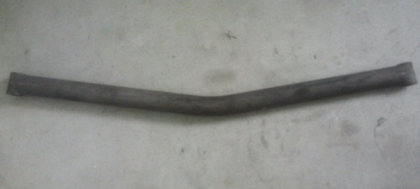

    Hi all,
    Can anyone help me identify this axle?
    Thanks!
    UPDATE!
    It's 45 1/2" end-to-end at the top of the king pin boss - 47" at the bottom of the boss.
    The king pin boss inside diameter is 5/8" - Top of the boss to the lowest part of the V is 5".
    Tube diameter is 2"

    from Colorado
    Looks more like a drag car axle than a typical oval track axle. Width, KP diam. and tube diam. would go a long way to help identifying what it was intended for.

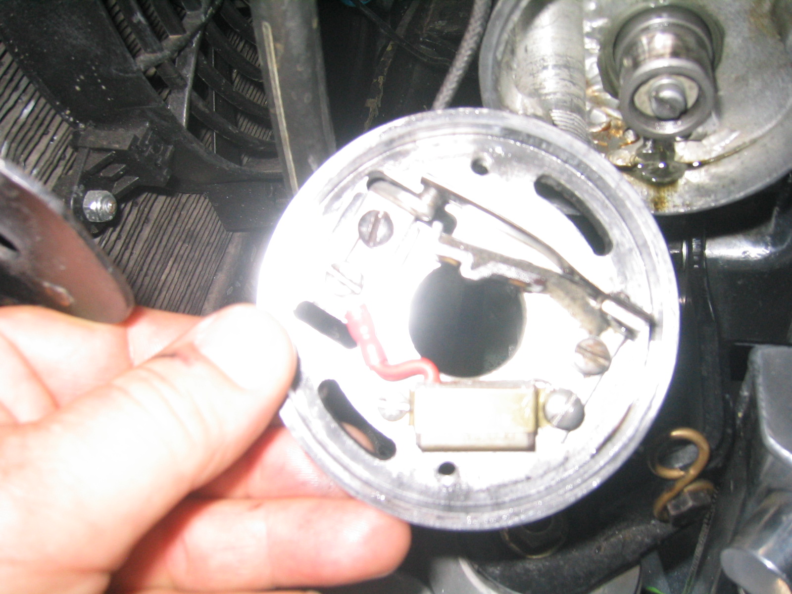

    Thanks to everybody for all the help, suggestions and information! I could not have got this far without this thread!
    As far as my cooling issue I have lots of things to look into. I am going to probably switch to alky, and if I want to use the on board starter I am going to have to add a mechanical advance unit to my Mag. I will get to those but I am going to tackle some coolant plumbing issues first.
    With some advice from many of you I believe I am getting an air bubble in the head, my fill location is just about even with the top of the head and that is to close. I also have a single 3/8" hose from the head to the radiator. This is how the existing radiator was set up but I think That might be to small.
    Here is my new plan:
    Here is my new cooling plan. I have an aluminum overflow with a 1/4 pipe fitting towards the top and a 3/8 fitting towards the bottom. I am going to mount this with the cap even with the top of the valve cover. That is as high as I can get it and still fit under the hood. Going to run a 1/2" pipe 4 way cross out of the head and add a 1/2" pipe bung to the radiator. Out of the cross I will have a 1/2" hose straight through to the radiator, I will have a 3/8" hose from the top of the cross to the top of the overflow can to carry air bubbles up and out, and the temp tube in the bottom cross. Then it will have a 3/8" hose from the bottom of the can to the radiator to fill the system.
    Does this sound reasonable?
    Thanks
    Neil
    Jack up the front of the car so the cap is the highest point when you bleed it, OR make an aluminum or stainless solid top hose and at the highest point weld a -3 fitting in it to bleed it, when all the air is out cap the fitting. OR you could get serious about it and build a swirl pot.

    Hi from Down Under, I dont know what mag you are using on your project , but this is how we put in a mechanical "retard to start" on our Offy with an on board starter.
    If it might help , you can PM me for the drawings
    Cheers Greg

    Thanks for the advice. I am running a standard vertex mag. I was already toying with the idea of a lever to move the whole mag after start up. Seeing yours makes sense to only move the points plate. I am a little nervous about moving the whole mag and the mag coming loose out of the block. If it comes to that it would probably be better to add the centrifugal advance inside the mag.
    My plan for an overflow hit a big snag, hood hugs the motor to tight and I can not put it where it needs to be. I have run out of over the counter solutions so I am going to have to make a custom filler neck/expansion tank/thermostat housing thing. I am not the best aluminum tig welder but the whole point of this project was to sharpen my fabricating skills and do absolutely as much as possible so it may take a couple of tries but that is the new plan. Going to solder a new larger bung into the radiator also.
    I googled images of radiator swirl pots. Those things are pretty cool. I'll have to see how my welding goes!

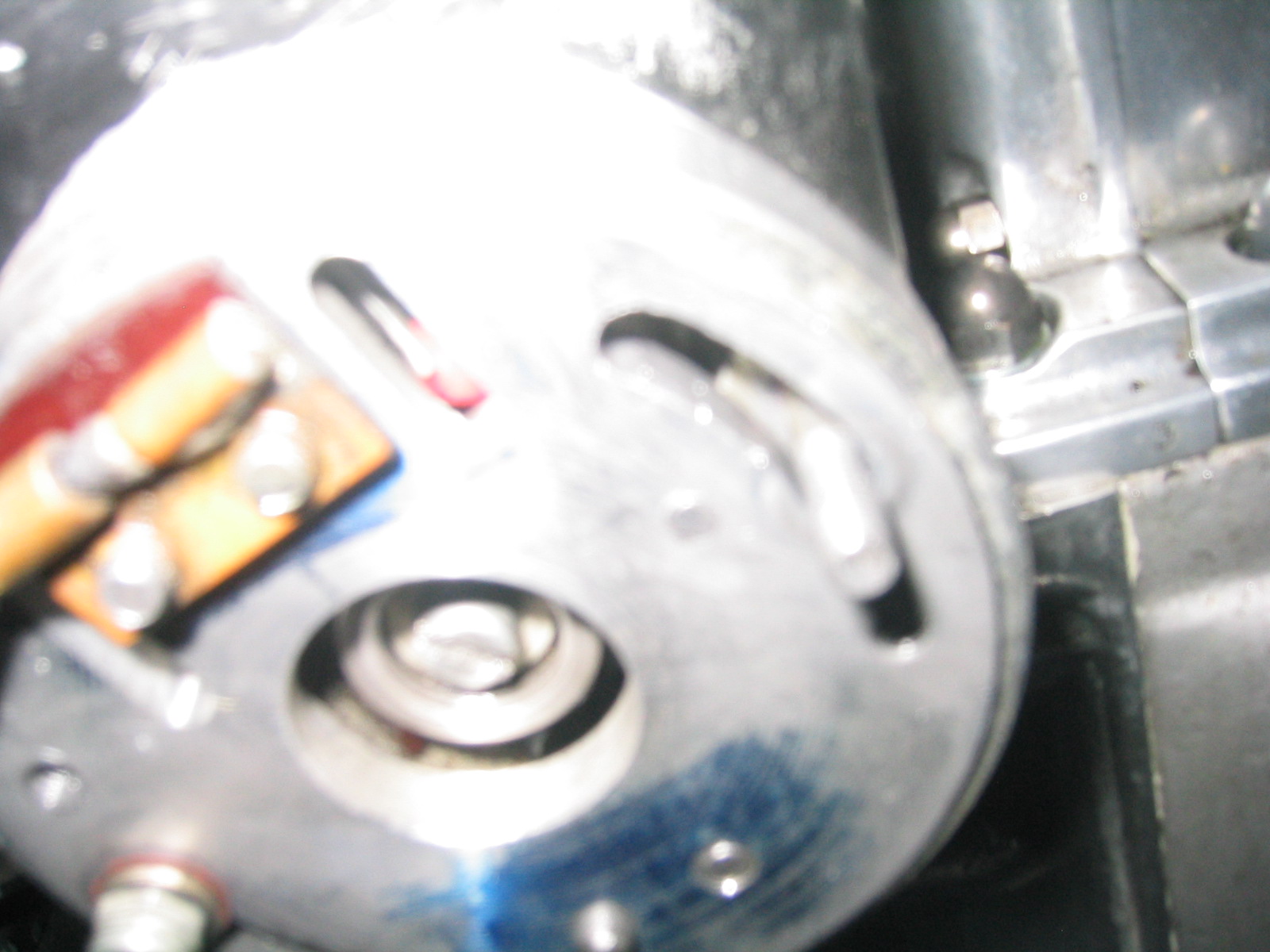

    I assume that when you fire it, you're leaving the spark off until the starter winds up the engine as much as it can. Then flipping the ignition switch to light the plugs. As if you were getting push started. That can overcome the need to run fixed advance.

    BZNEIL
    I am starting the car that way, the starter is just not strong enough with the advance set past 20 degrees.
