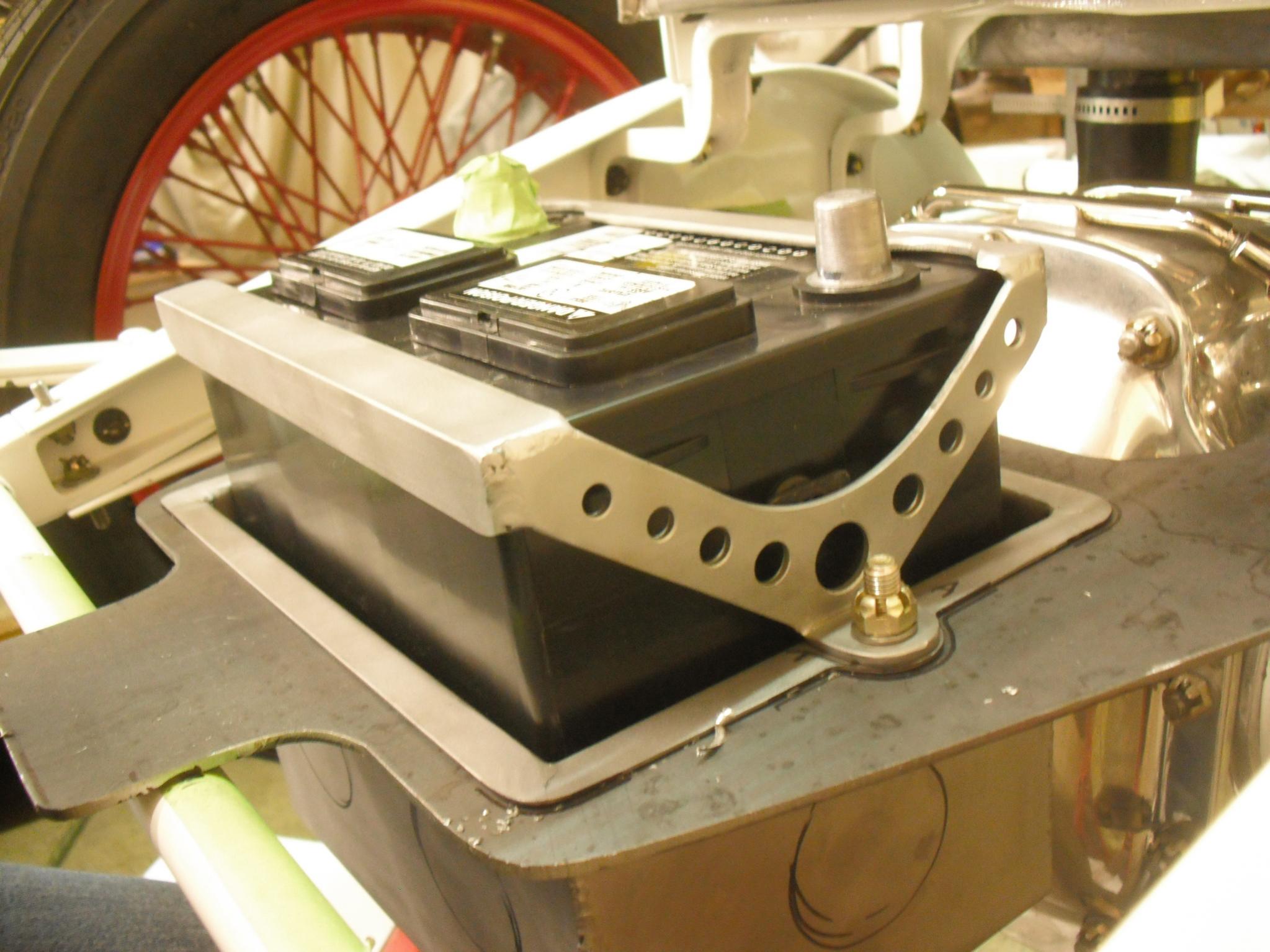

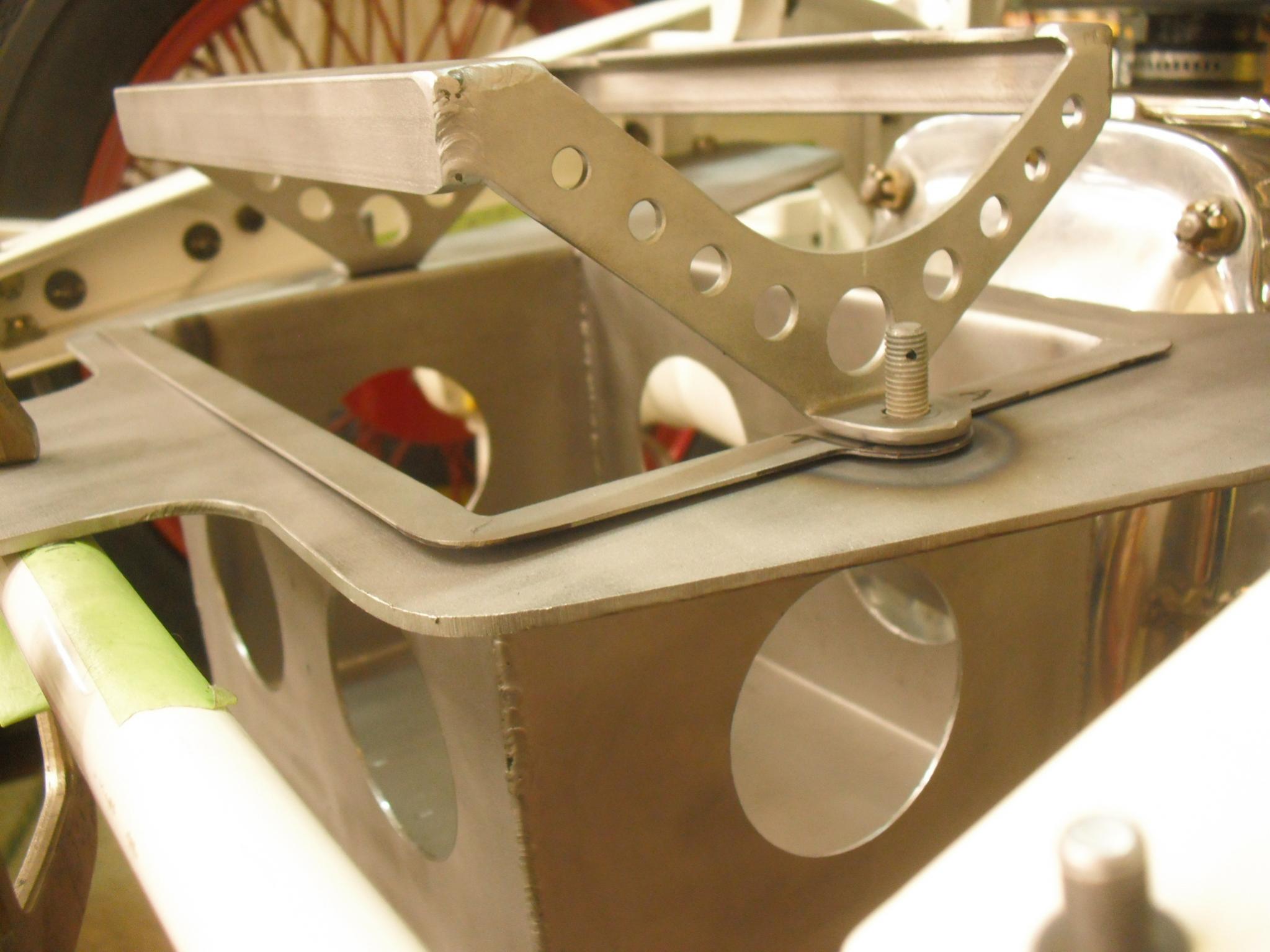

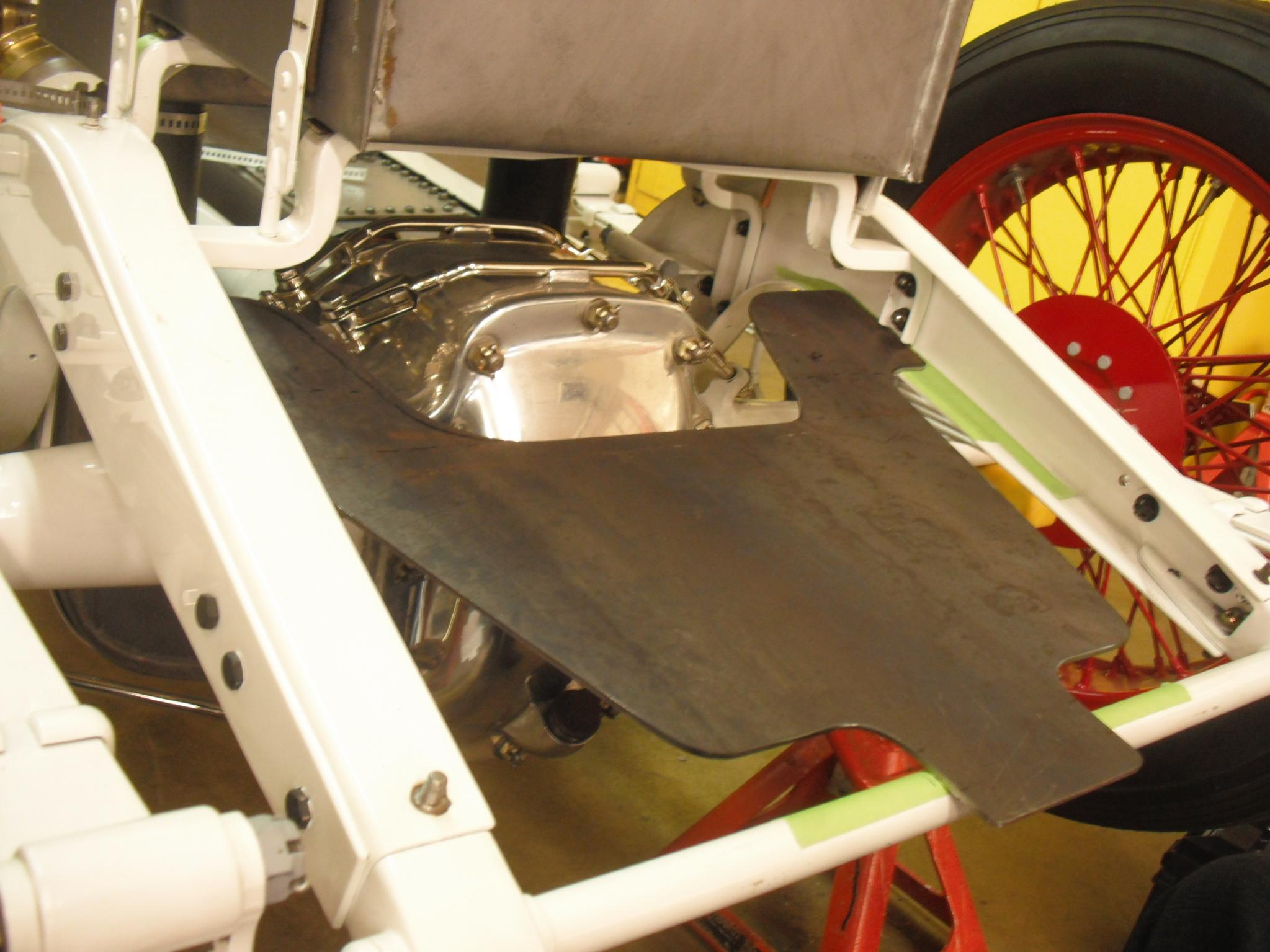

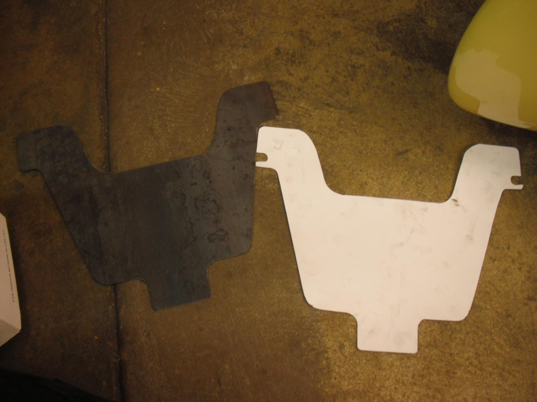

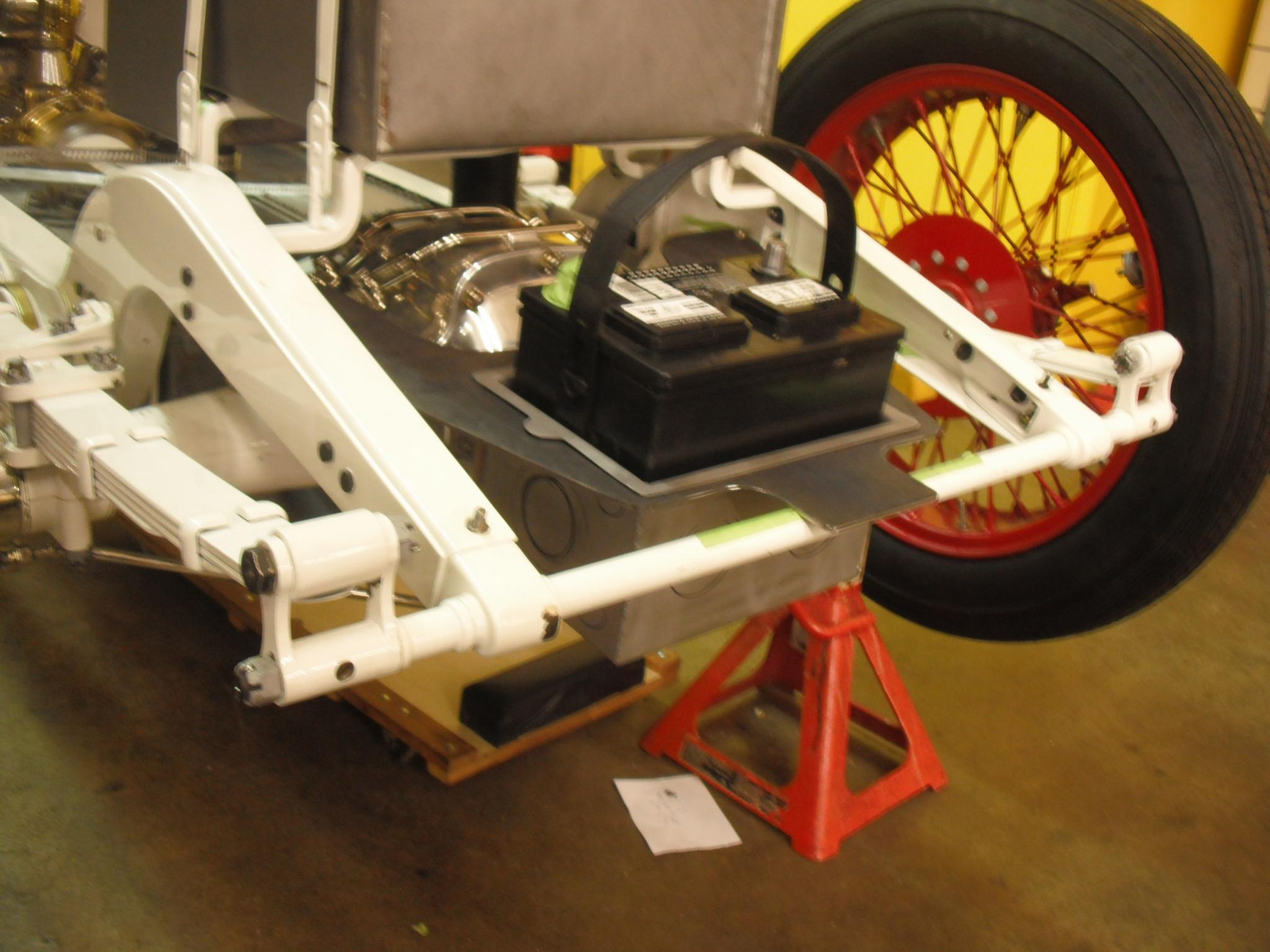

    Here is the latest update of where I am at on the build:

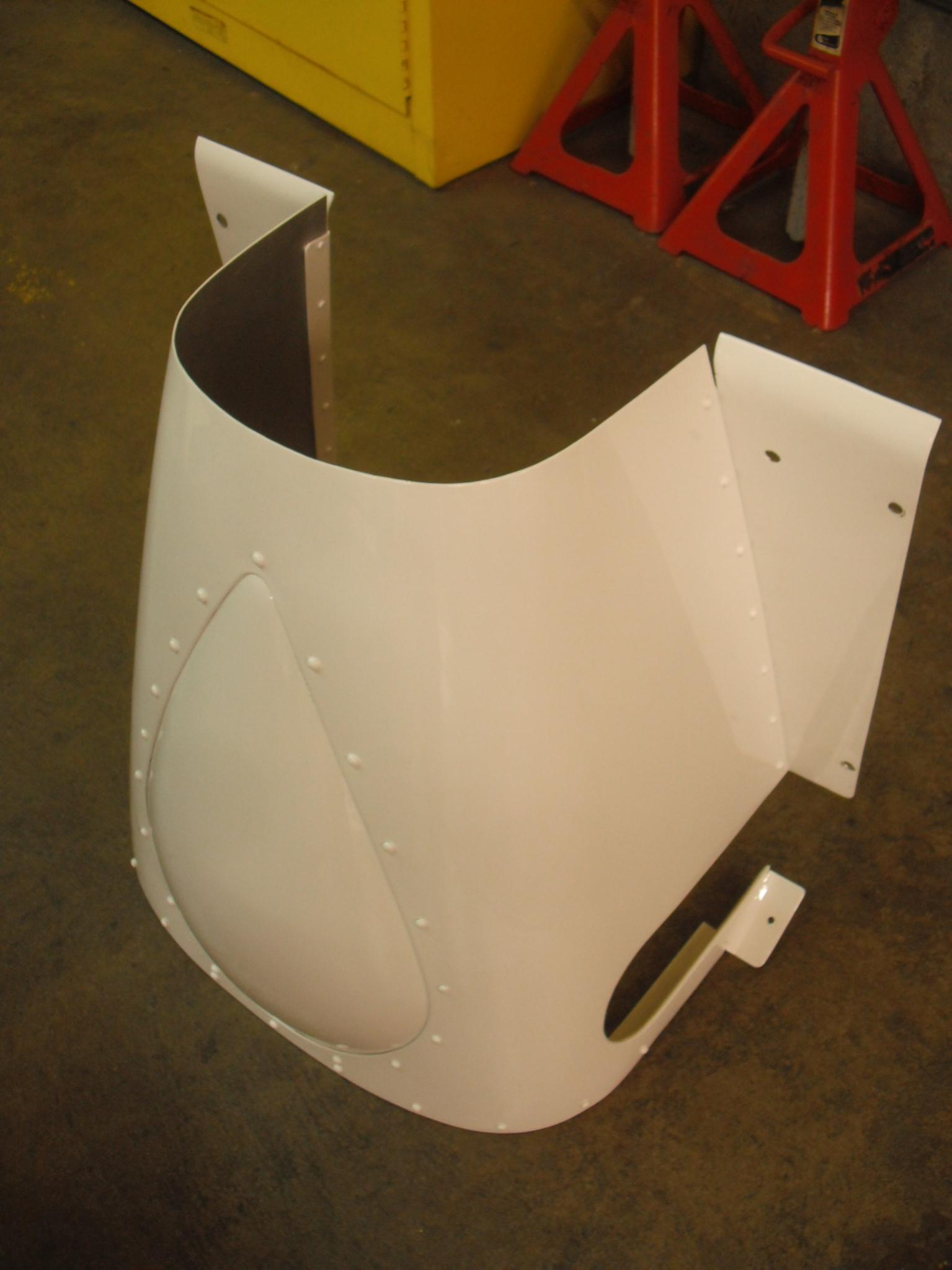

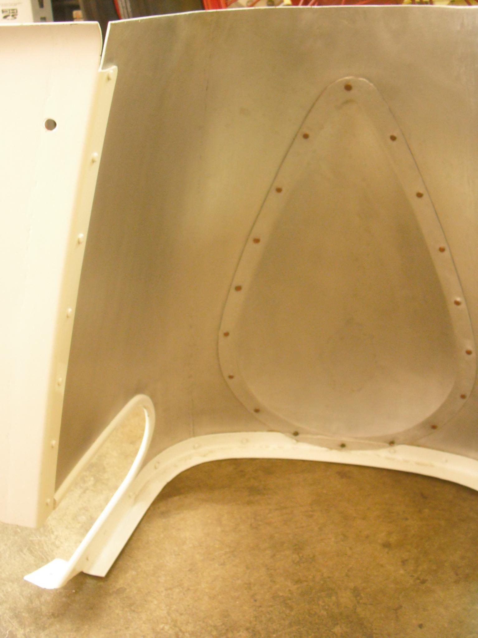

    Fit rear-belly pan (Diaper) and check for clearance for Battery.
    Mount the Battery in a steel plate behind the Rear-end in a Half sunken box. (We have a picture showing this on an original car)

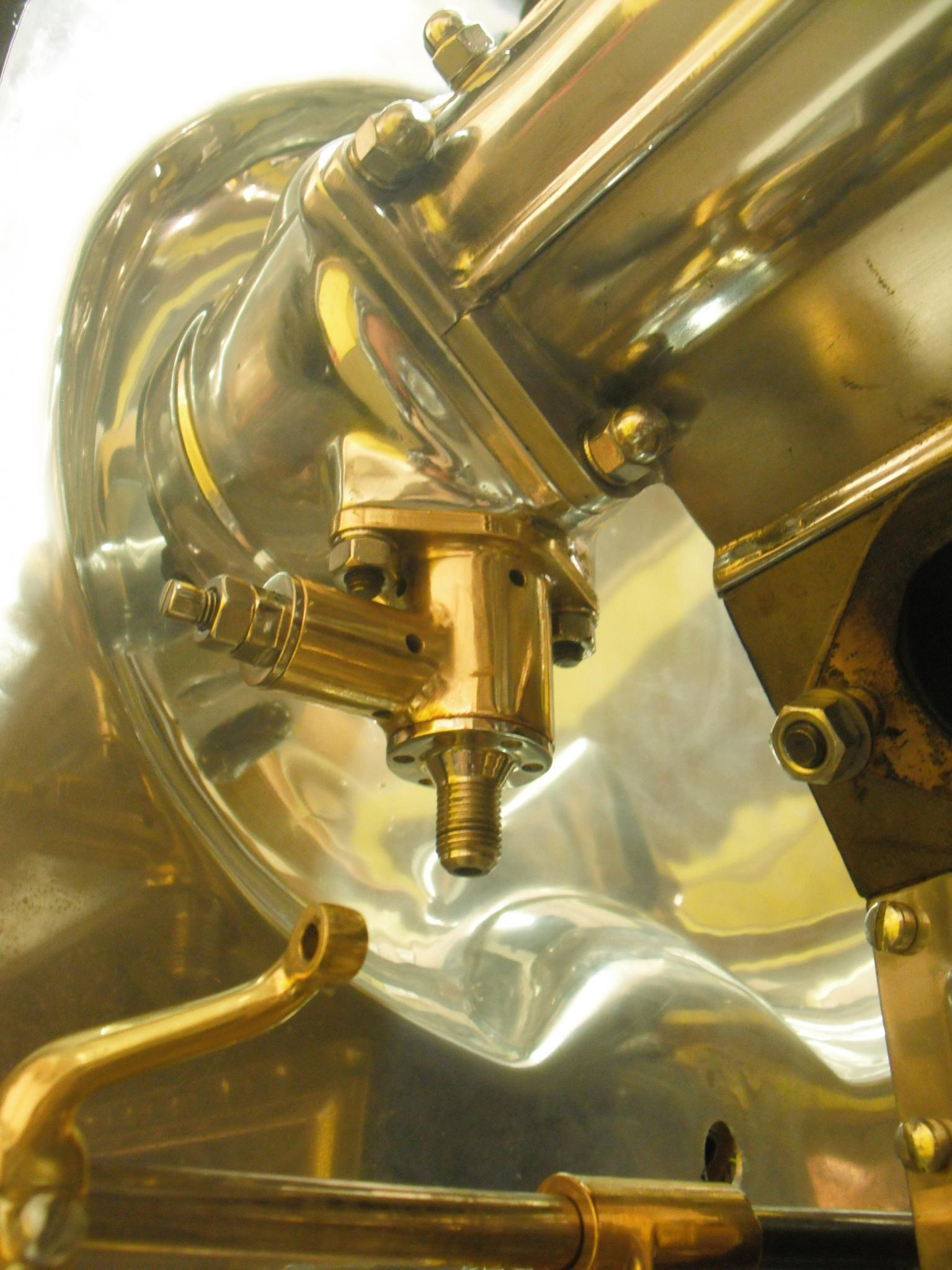

    Finish assembly of the Engine mounted Air pump, and set Check valves.

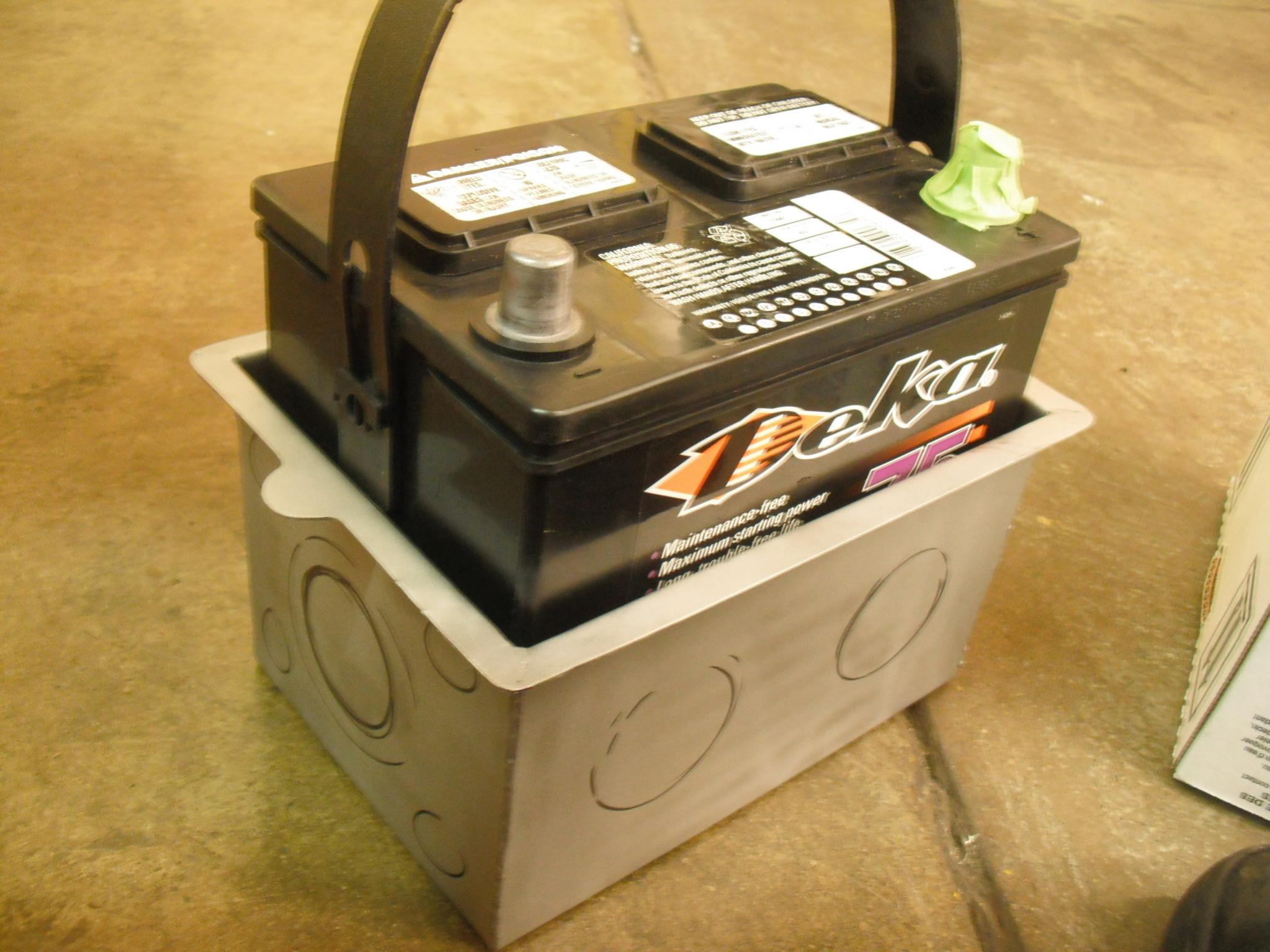

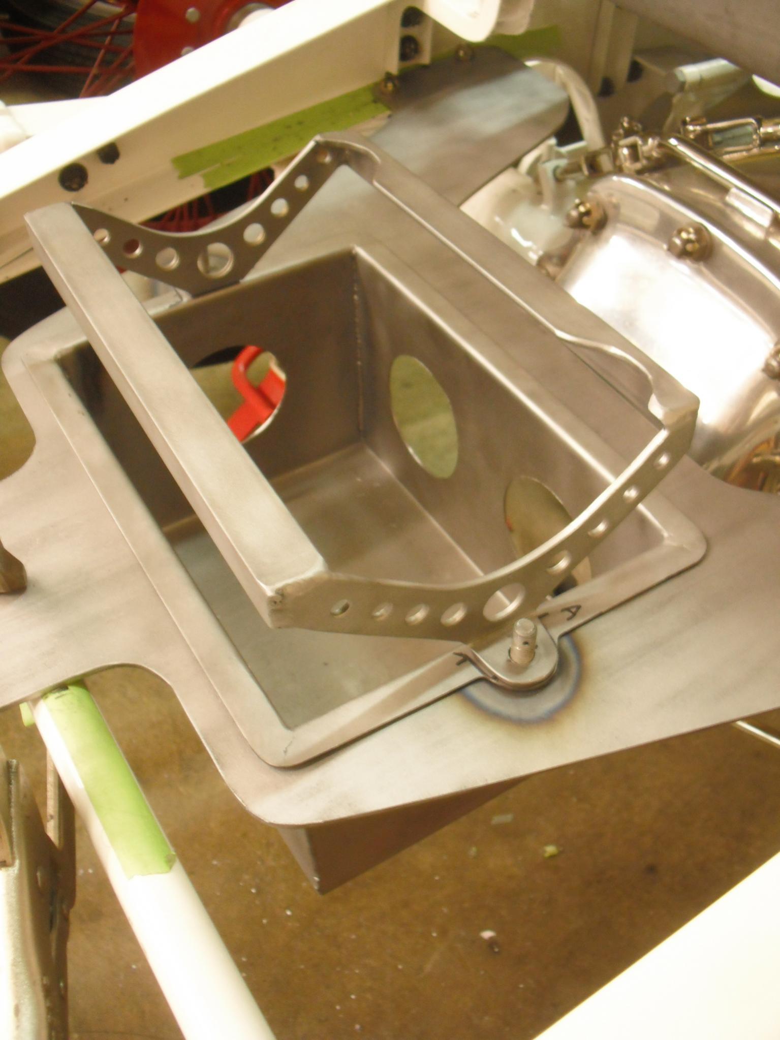

    Build Battery box.
    Build cool looking Battery Hold-down.
    Put Holes in Battery Box.

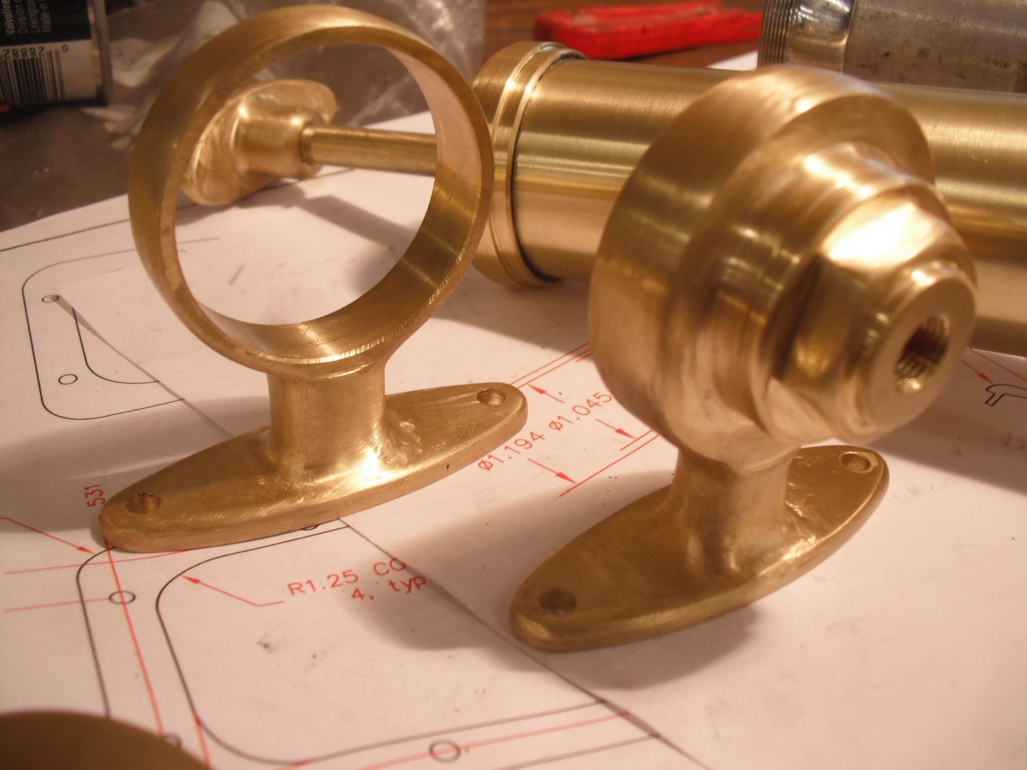

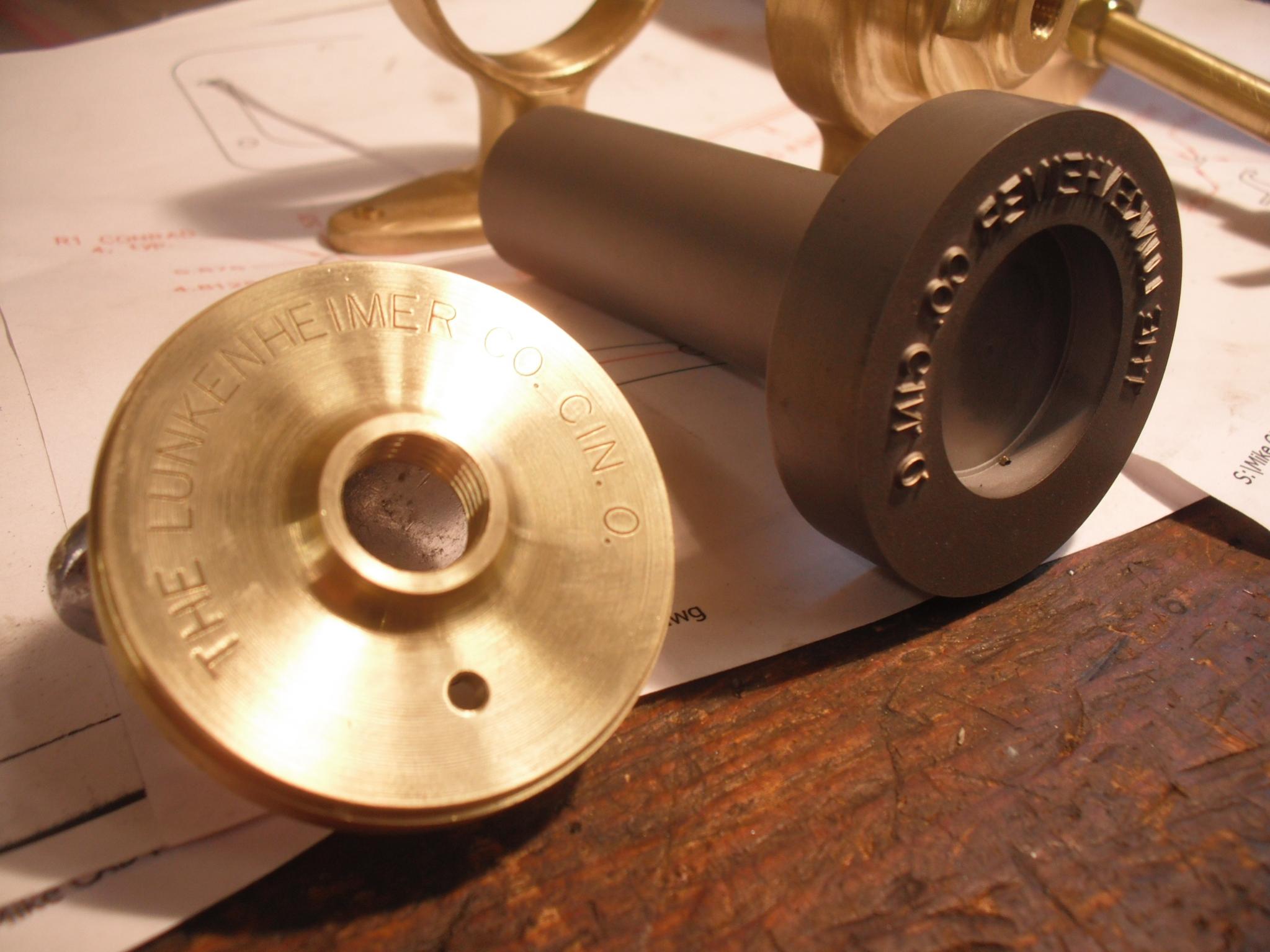

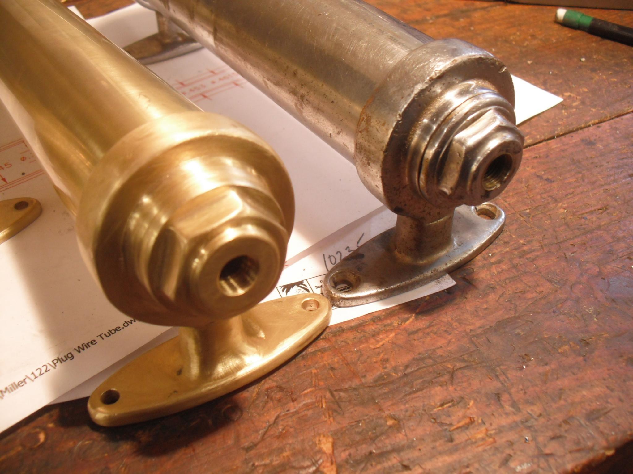

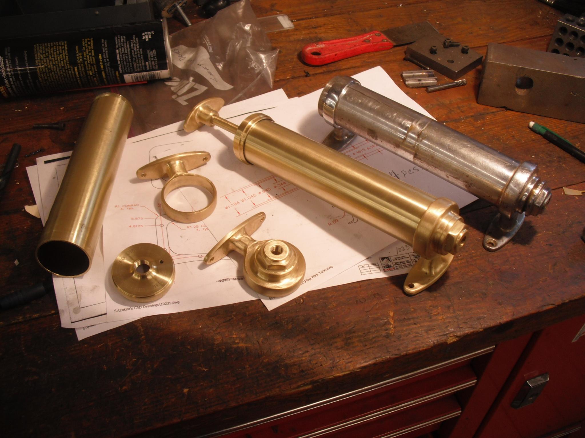

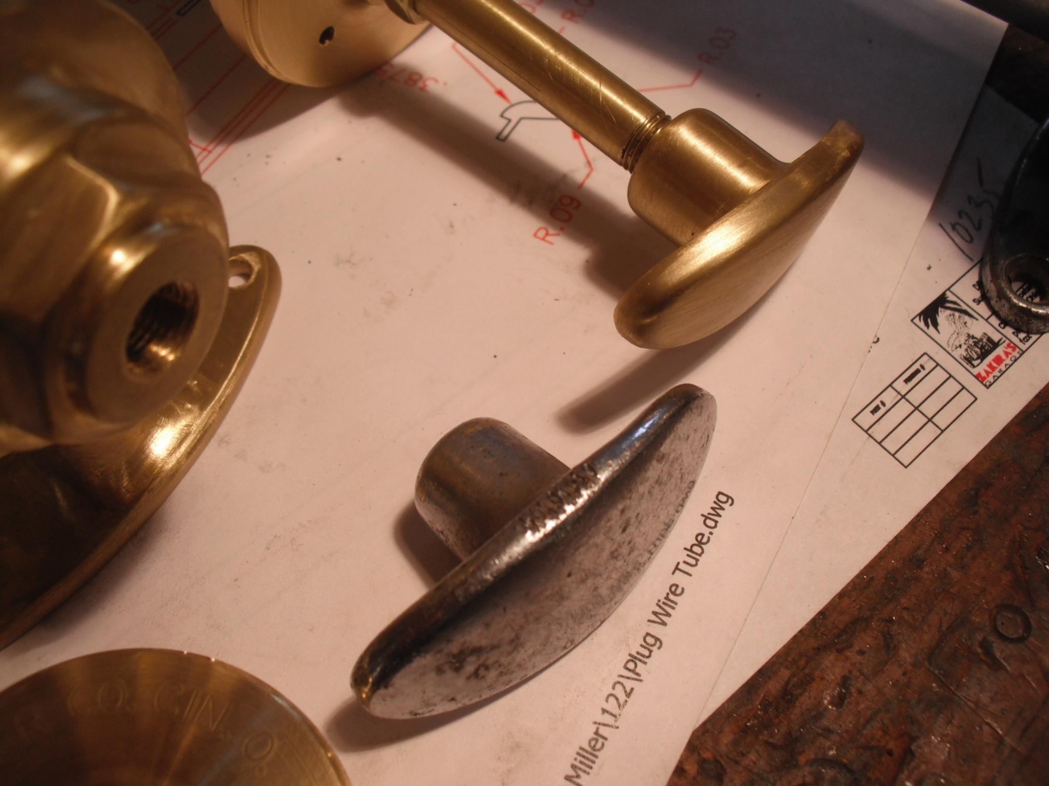

    Then came Re-making an Original LUNKENHEIMER CO. Hand pressure pump. We had a good original to go by so Don (Shop Machinest) made one up.. He roughed it in, then I had to "Round" the mounting stands, rings, and Base nut by hand.. Meanwhile a "Logo Stamp" was made to reproduce the LUNKENHEIMER CO. CIN. OH logo...
    and.. while your at it, make two! ;)

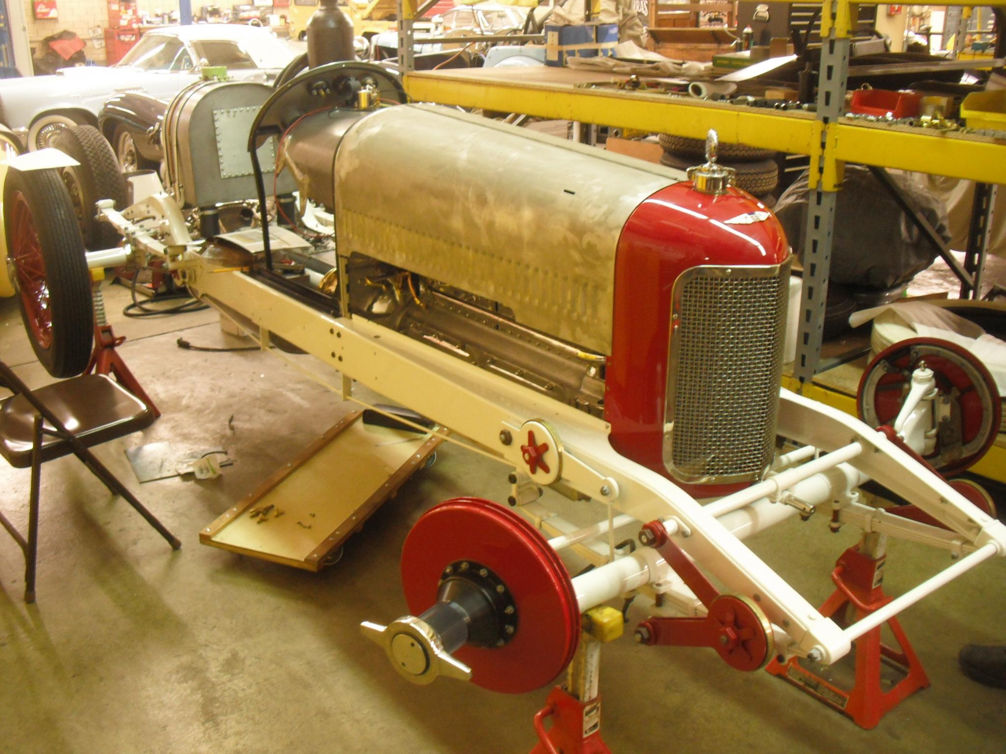

    Continued..

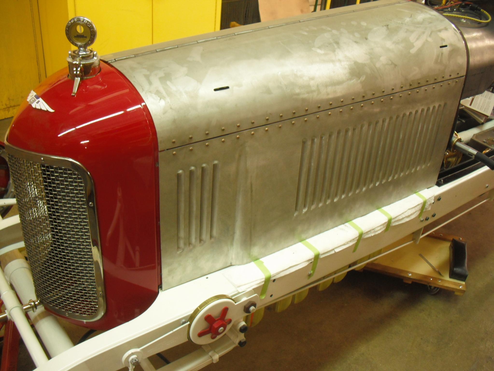

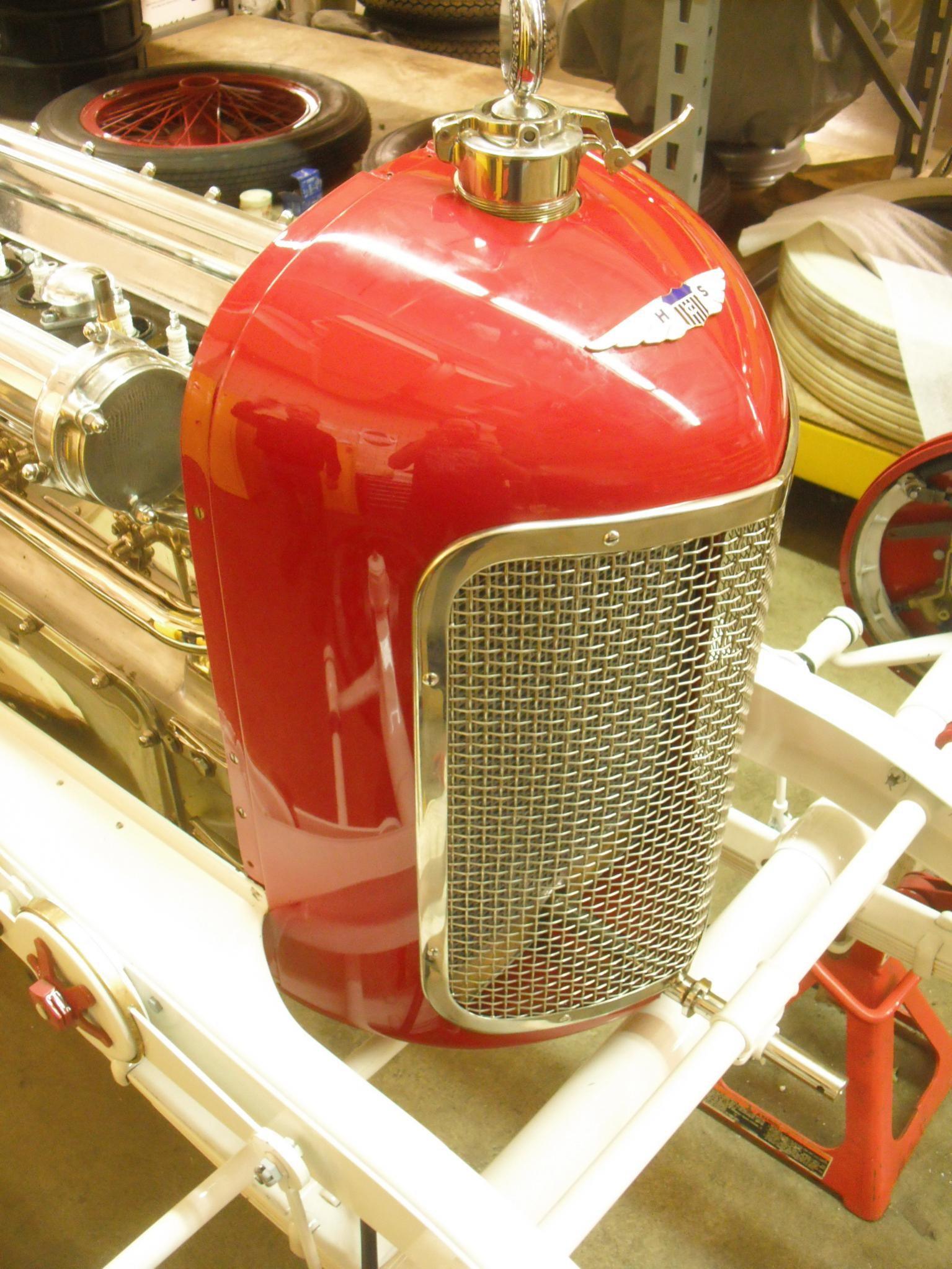

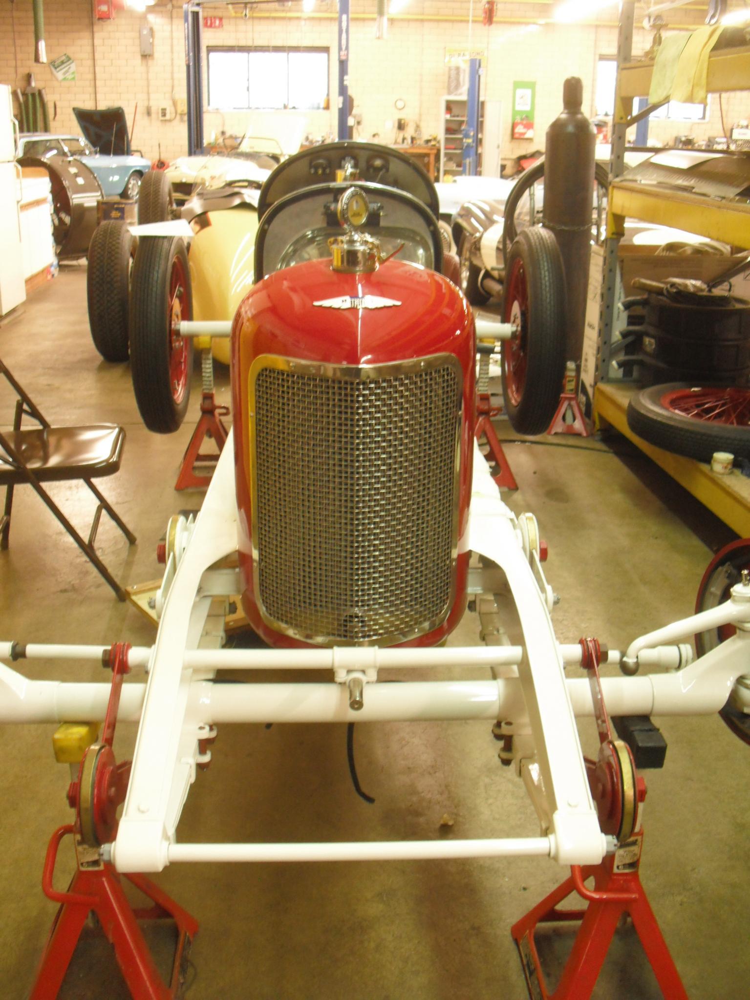

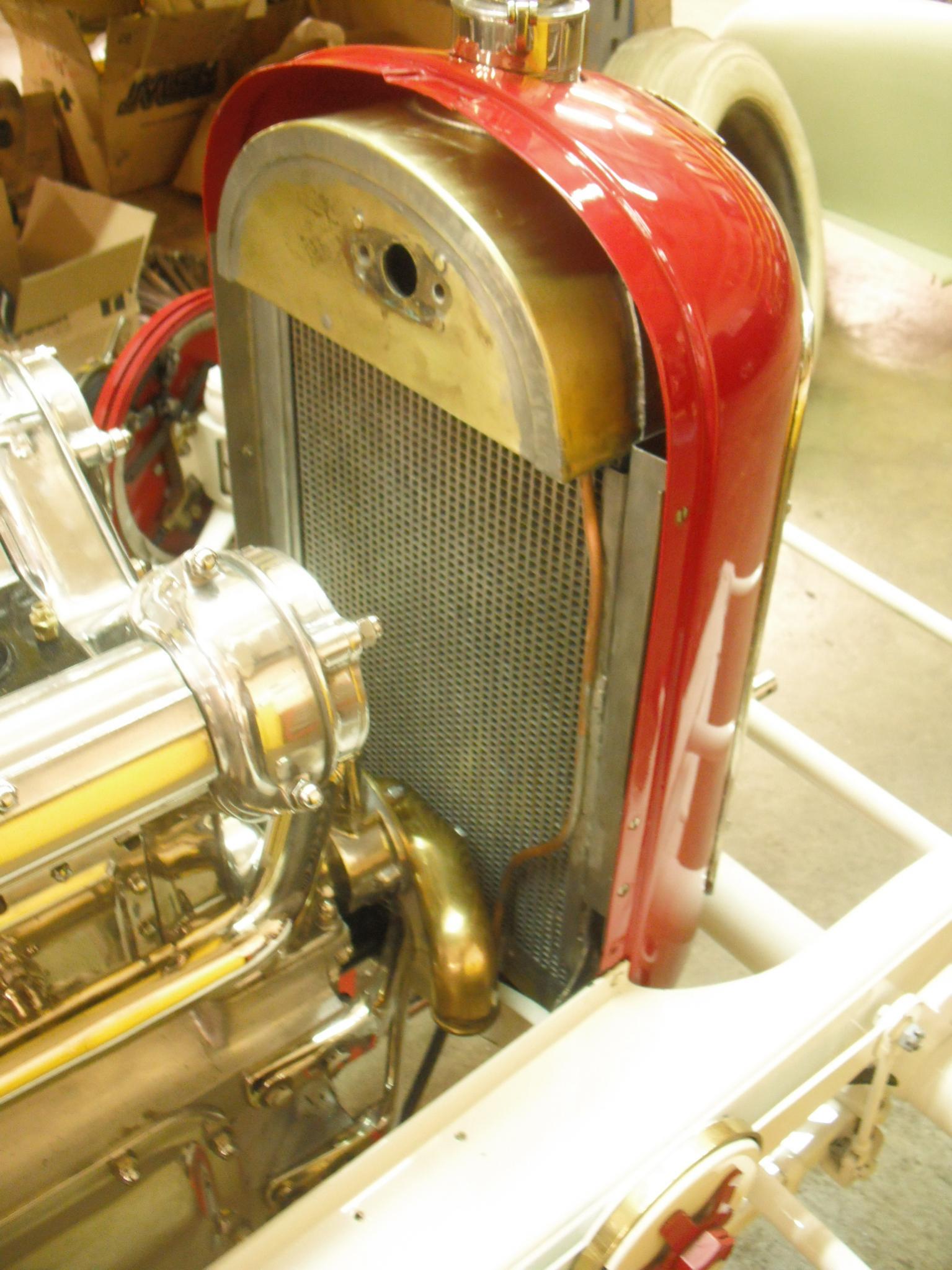

    Grille shell and Radiator fit.

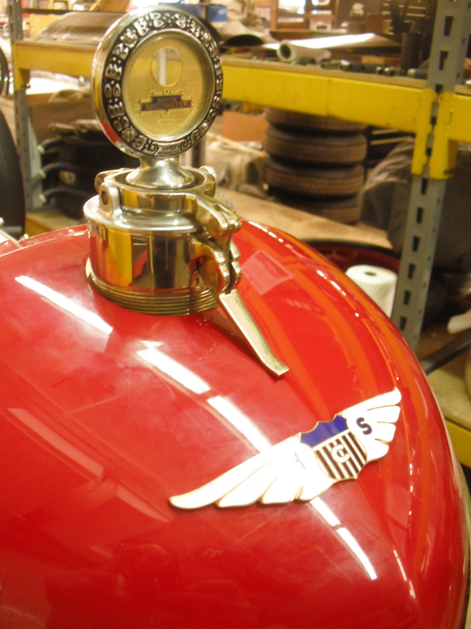

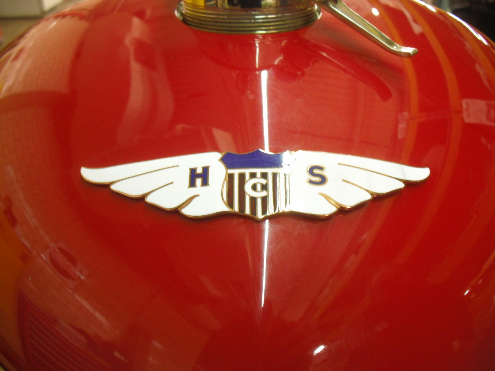

    Check out the HCS Nose badge! BEAUTIFUL!
    Radiator.
    CLOSE fit!!

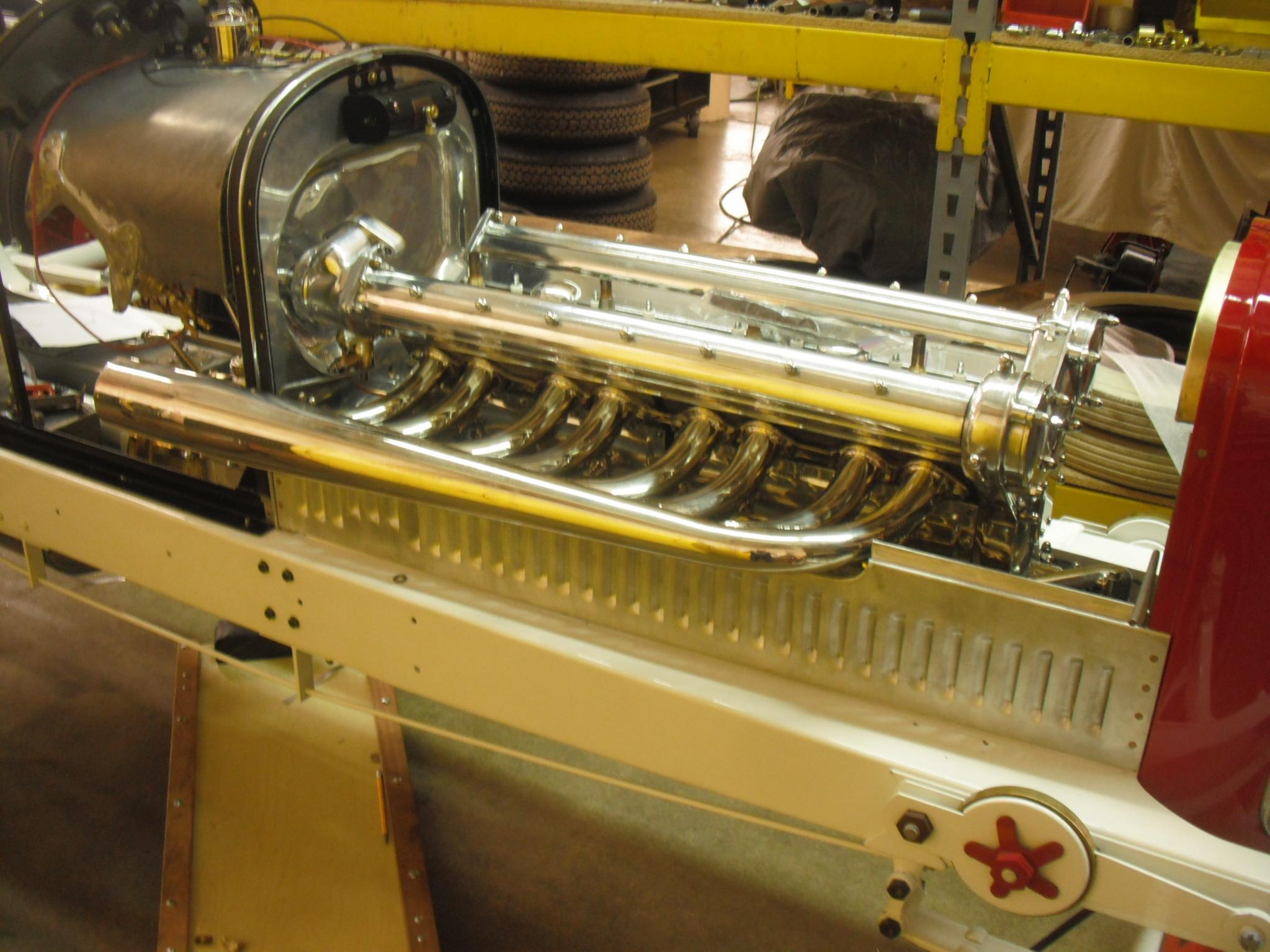

    Hood test fit.
    Header Test fit.

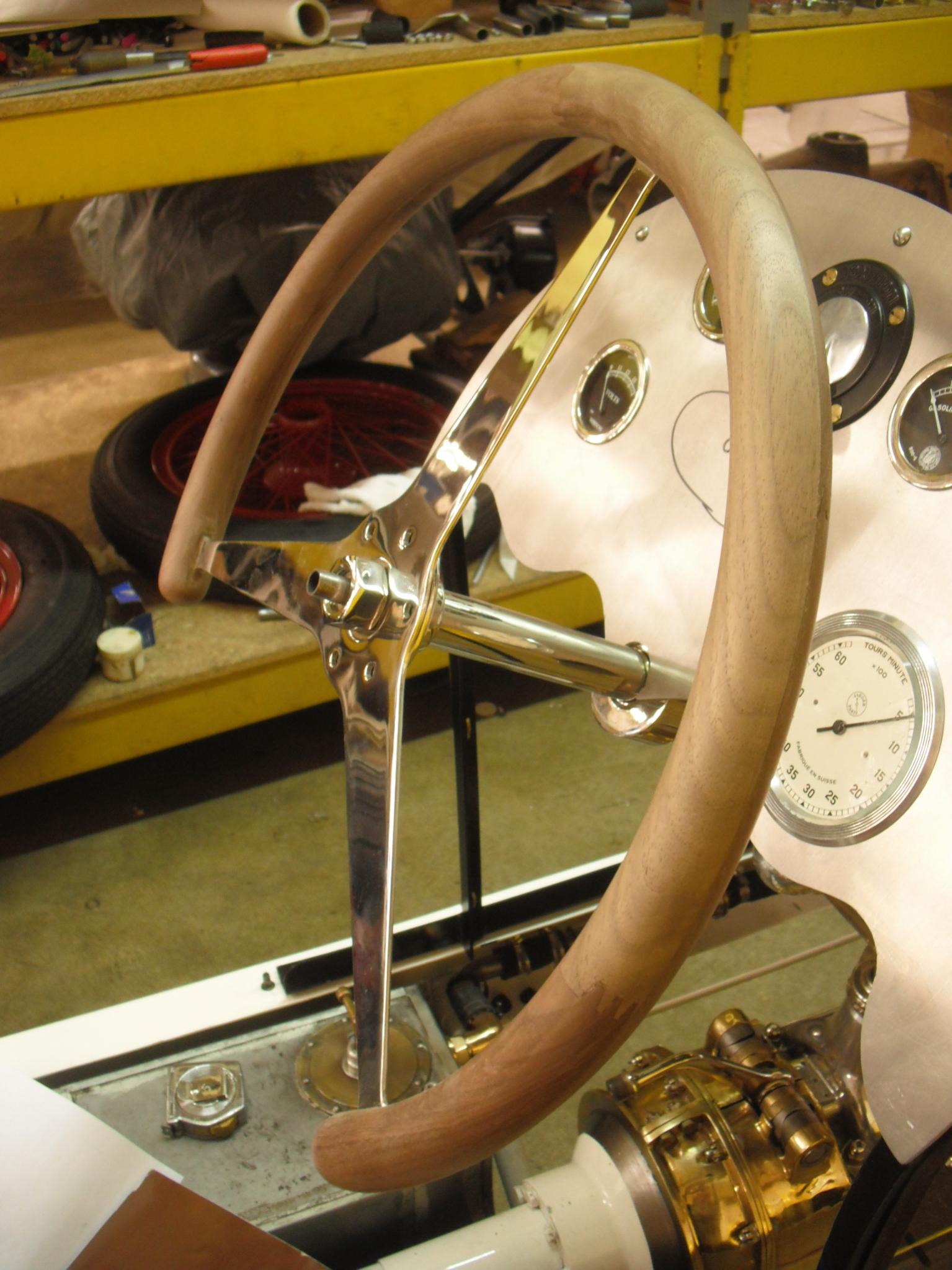

    The Steering wheel was made from scratch in house by Jim "Longname". He is the Head guy in the shop and a GREAT guy!

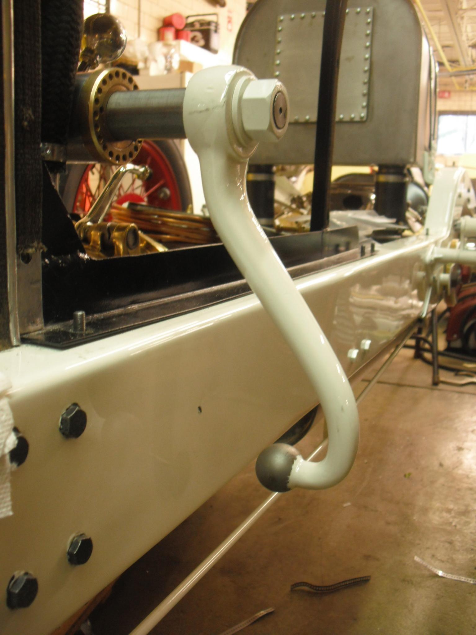

    Pitman arm.

    Very clean work Joshua, innovative idea for the battery box .
    The machined parts look very stylish truly new "old" look
    takes a seasoned machinist-fabricator to get good looks
    even when your copying.
