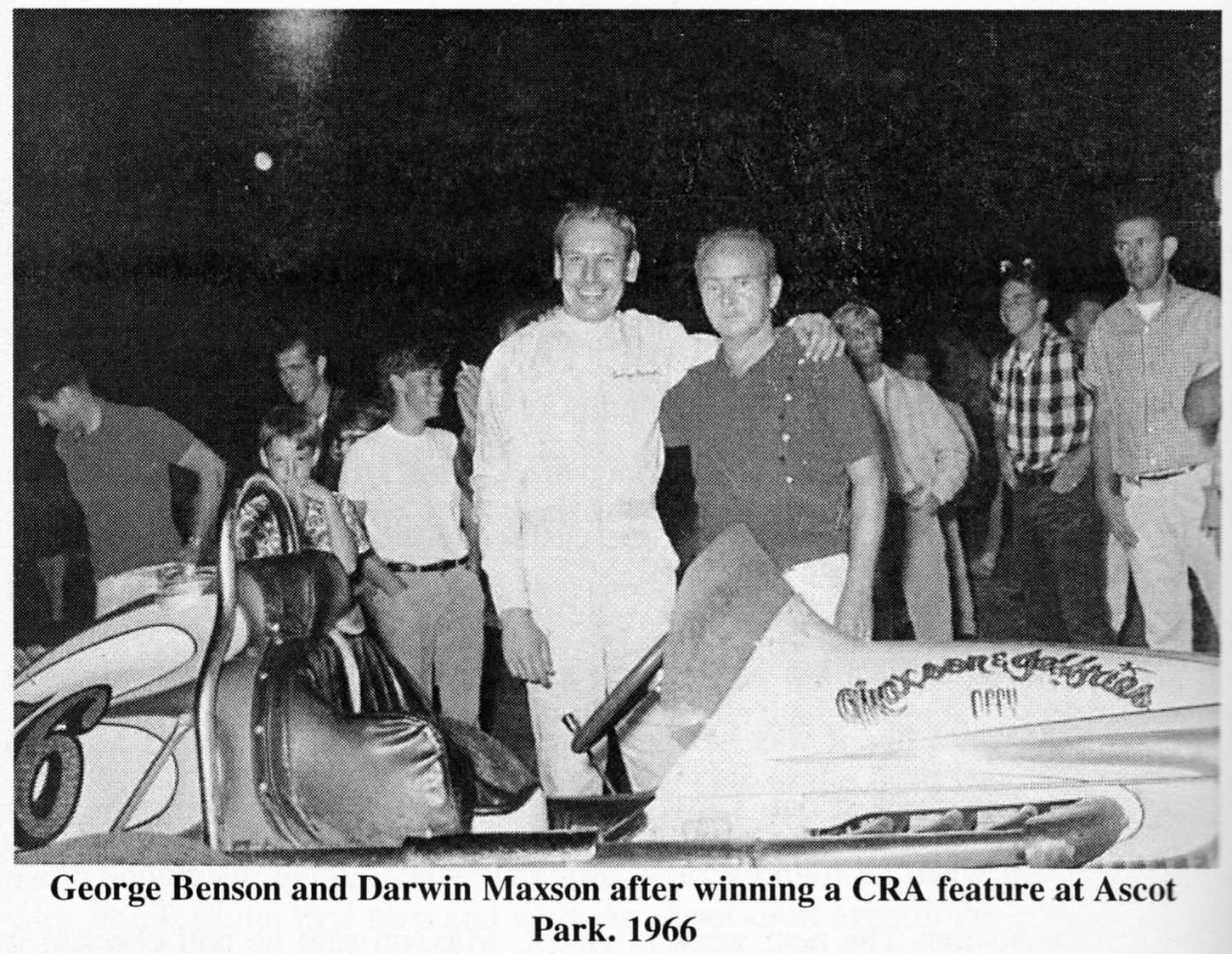

    .....'Offy220 [Bruce] mentioned George Benson: 'Thank you for that. Aside from all of his accomplishments in racing both as a driver and a car builder, he's also the author of an amazing new book. Since a recent topic was Gordon Van Liew's Vita-Fresh Orange Juice dirt car, as was noted before, George drove that car for Darwin Maxson. He also drove the Maxson-Jeffries sprint car in CRA competition (with which he won with) and Maxson's front-engined Epperley Indy car. Benson is probably just another brilliant craftsman, engineer and race car driver that will not get the credit and notoriety that he deserved. And because of his modesty and self-assurance, I'm sure that he is just fine with that!

    Little Fauss,
    Thanks for posting about his accomplishments. He has been very helpful in identifying some spare parts I have had for the last 25+ years that I bought from Judy Maxson Jeffries along with the Watson sprint car. I have some spare drive train parts/brakes/axle from the Dirt car and Halibrand wheels from the Epperly Indy car and the dirt car. I wasn't sure where these parts were from - George was and is a great help. Excellent author also!
    Since you mentioned the CRA Maxson-Jeffries Offy Sprint car - George and Billy Cantrell were some of Maxson's top drivers - along with Buzz Rose, Gordon Woolley and Paul Jones - possibly others.

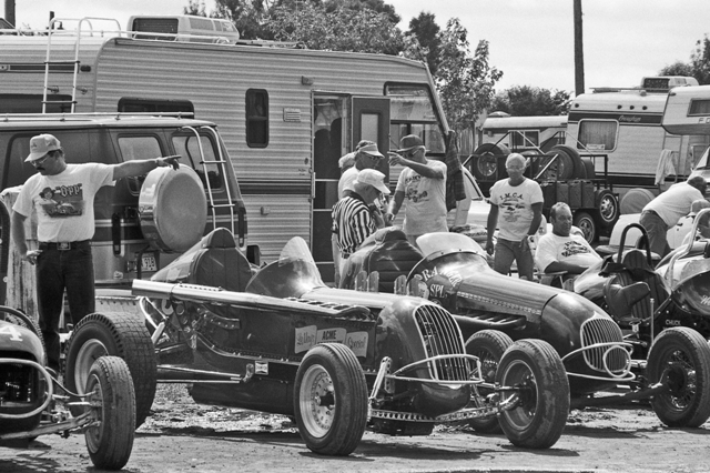

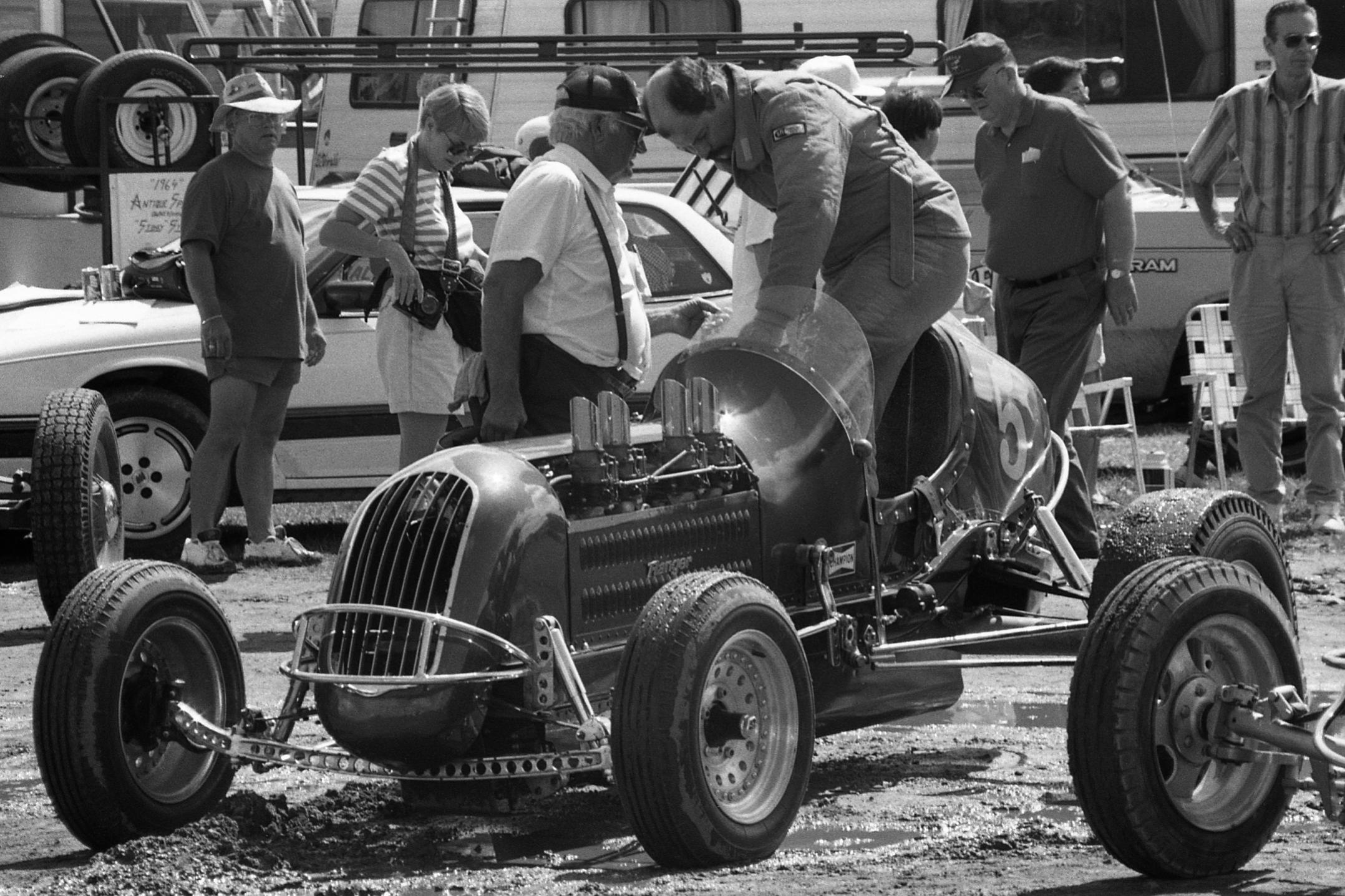

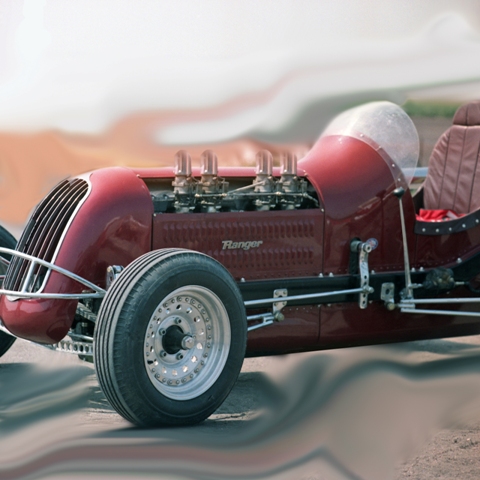

    I am just now looking at a disc of photos by Bob Ochtrup in the nineties and discovered a few pictures that should be posted such as...
    ...the George LeMay Ranger from Calgary, Alberta. that ran with IMCA.
    The car behind in the second photo is the Gene Cunningham Ranger, from Des Moines, IA, also an IMCA car.

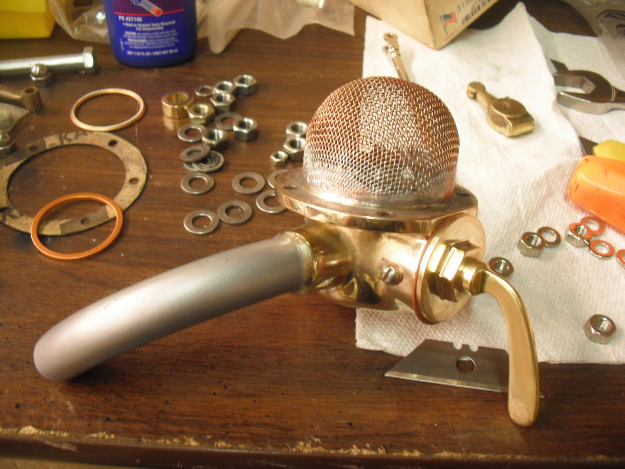

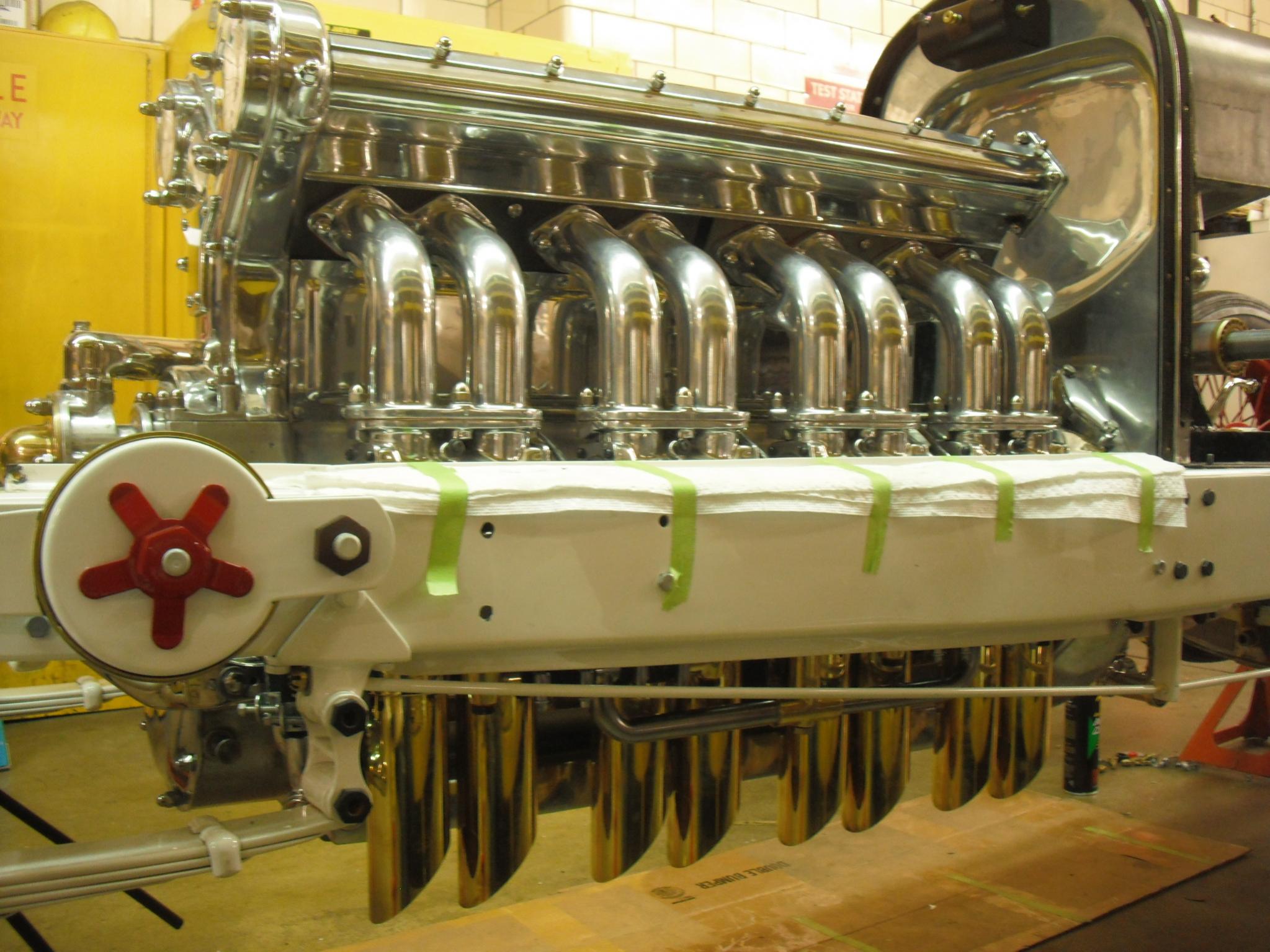

    Okay fella's.. a Quick update on my current project. It's gonna be non stop from here to INDY. It's gonna make it, but it'll take everything I got.
    Engine has been fired on the Dyno, tuned and broke-in. We plan to fire it IN the car, inside the shop towards the end of the week.
    Some of the things that were not done, that I had to do were:
    Take a box full of 3/4 Stainless tube 90 degree bends and make a fuel line by tig welding it all together, hand fileing the welds, sanding with 240, then 400, then buff and polish. No seams! (old correct Hose clamps will be switched in AFTER we run it around the test corse a few times)
    Re-mount MILLER carbs, and assemble fuel manifold rail. Had to Silver Solder all connections. (bunch of lil hoses, hose clamps, and what not.)
    Assemble and install Throttle linkage and get working perfectly SMOOOOTH!
    Build a clutch pedal return stop.
    Assemble and finish Oil valve.
    Finish Oil tank, solder everything to it, and make bracket for Hand Fuel pressure pump. (Bracket had to be made, Then LEAD coated, the solder on)
    Then test fit Cowl section, and mark, make, and shape guage panel.
    More to come..
