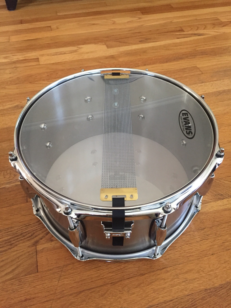

    This one is 16 ga. stainless steel rolled and a TIG welded seam . I’m using USA Gretsch parts and Remo over Evans heads. [​IMG] IMG_6911.JPG [​IMG][​IMG]

  23. The heads take to the edge OK? Not much surface for any real radius. Daylight shows relief for wires :cool:

    The edge works fine but tuning takes longer than with a 45* bearing edge. Look up Dunnett and Keplinger snare drums...they are both true metal artists, huge influence on my drum building.
