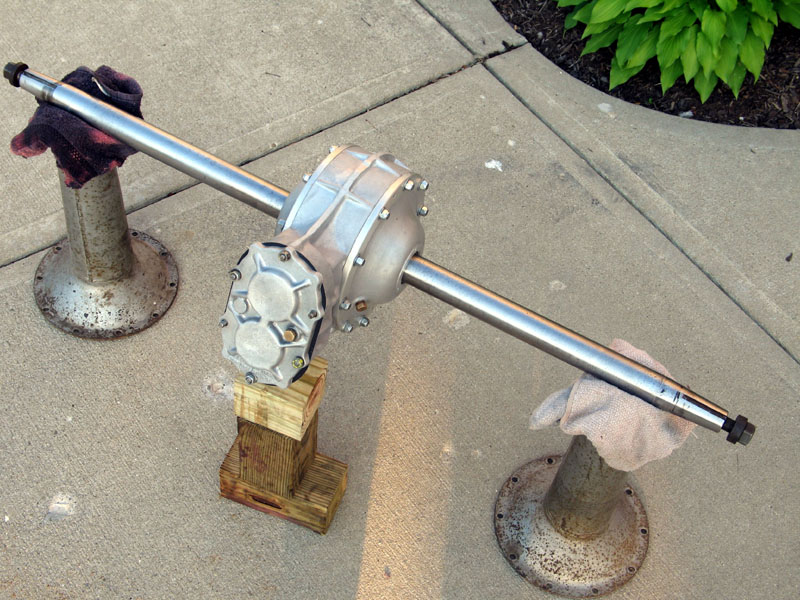

    Since I spend most of my time in FL and only work on the Edmunds CBM-7 midget restoration when I am in OH, progress is slow. But everybody likes shiney parts so I thought I would share. Just got back from the plating shop - some chrome and some polished nickel. Rear end is rebuilt and ready to go. Start preliminary build tomorrow.

    Hi,mate, Did you have Hydrogen-Embritlement Treatment done on Chrome Stressed components, ie,axles,steering components, Good luck Restoring & Enjoy .Gordon.

    Before I hurt myself or the midget, is the bolt on the end of the tapered axel left or right hand thread?

    On my Halibrand tapered rear axle the threads are right hand on both sides. Took a good impact wrench to get them loose. If you are removing the hubs, make sure you leave the bolt in place (loosened up of coarse) and a washer larger than the diameter of the ID of the hub. We had to heat our hubs to pull them off and when we applied the heat the hub shot off of the axel like a bullit.

    No I did not have the Hydrogen-Embritlement Treatment done. Don't plan to race the car. I have done all kinds of Street Rods with many chrome steering and suspension components, nothing has ever broken, of course I do not race them either.

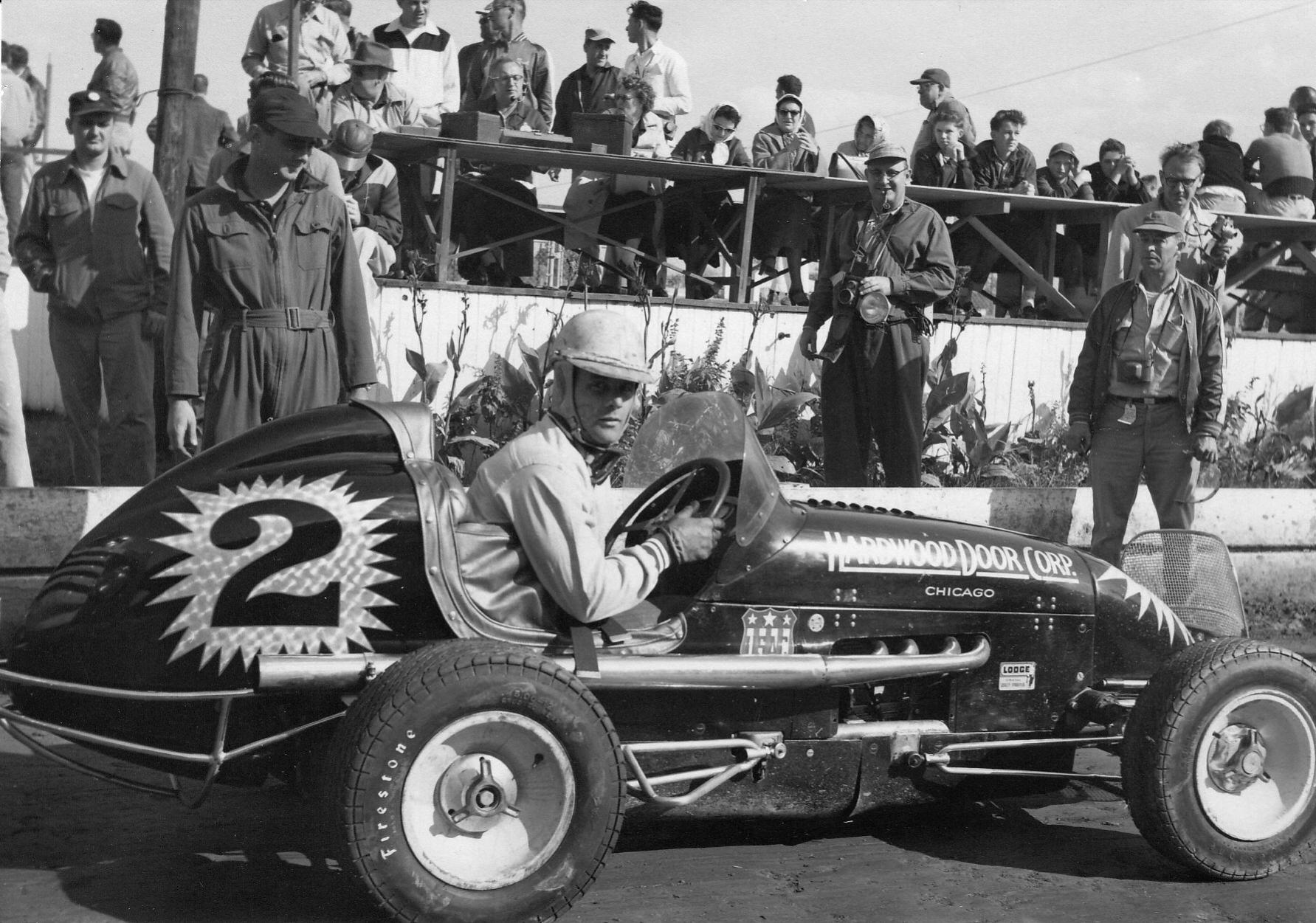

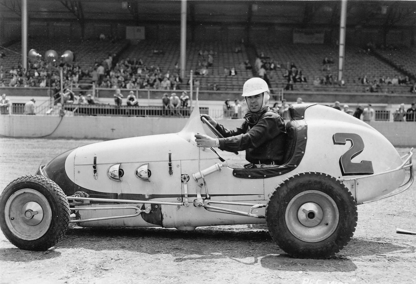

    Anyone recognize this car, and the name of the owner?

    Does anyone know who owned this car? The driver is Bob Breading.

    Weren't cars like that # 2 so good looking?

    monkaz
    from gilbert,AZ
    The Hardwood Door car did run at Flemington in September of 1956. Chuck Rodee was the driver.
  21. monkaz
    Joined: Oct 6, 2011
    Posts: 203
    monkaz
    from gilbert,AZ
    Chuck Rodee in the Hardwood Door Spl. at Flemington. Date was Oct. 7,1956.

  26. That car was owned by a gentleman named Lew Morgan who lived in Parker, Indiana. The photo is from the pit area at the Armscamp Speedway near Alexandria, Indiana which Mr. Morgan also owned for a time.

    Do you know who bought the car from Lew Morgan?
