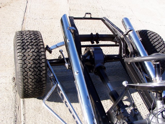

    another "what did they use back then" question for you fellow midget hamb'rs. what did they use for flooring between the frame & the belly tank on a midget back in the 1940's?
    I want to make some sort of floor to attatch to the steel ribbing that the belly pan will eventually go to on the outside, I first thought of just sheet metal but a buddy said why not expanded metal...I wasn't sure if they had that stuff back then and I want to keep it as close to period correct as possible. I have an abundance of expanded metal and I have sheet metal.
    Your thoughts on the issue...
    thanks,
    Paul
  16. Dr Dirt
    Joined: Oct 2, 2008
    Posts: 69
    Dr Dirt
    Belly pan is the floor
  17. the shadow
    Joined: Mar 5, 2005
    Posts: 1,104
    the shadow
    my midget has metal hoops that are welded to and hang below the main frame, I am going to attatch the aluminum belly pan to the frame on the outside but I do not want to stand on the aluminum belly pan when entering or exiting the car on the inside? that is why I want to put in a sub floor on top of those hoops on the inside to be able to put wieght on etc.
    so I guess it is my choice as to what material I use, I just want to know id expanded metal was used and or around in the 1940's racing community.
    Paul

    Paul, if you are a normal sized person in a normal sized midget, your floor needs to be your belly pan, period.
    In my opinion, I can't think of a place I would use expanded metal on a car of that vintage (or any vintage).

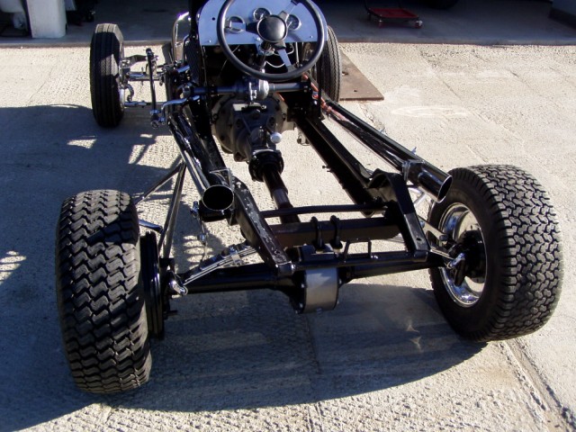

    Hmmmmm???? now I am wondering if I should cut out the framework that was installed by the last owner & just go with the bellypan as you say. I assumed that the last owner installed new ribs where the old one may have been, maybe he just added them instead. I want it to atleast look correct for the period.
    here is an old pic that shows the 2 rear ribs that were added to the frame, they are easly cut off if I wanted to (the frame is sitting on a rolling work frame)
    thanks 28dreyer
    Paul
  20. 28dreyer
    Joined: Jan 23, 2008
    Posts: 1,167
    28dreyer
    from Minnesota
    The thing that most needs cut off is that hoop and the bar stock or angle iron half way up the kick ups that it it is stuck to.
    The other horizontal angle iron between the rails looks like a seat mount.

    Here are some pictures of an old Hillagass frame and belly pan. The pan bolts to the bottom of the rails. And yes ditch the roll bar its is useless the way it is mounted. I hope this helps. You need to be signed in to see the pictures.

    Here are some pictures of an old Hillagass frame and belly pan. The pan bolts to the bottom of the rails. And yes ditch the roll bar its is useless the way it is mounted. I hope this helps. Note: Hillagass tails had the seat built into the tail section.

    For what it worth: the '65 Edmunds midget that I am restoring had a "sub floor". It was an old Speed Limit sign. It was mounted with the signage down, I just thought it was a piece of aluminum until I blew the car apart. Don't know if it was in there in 1965, but because of its' uniqueness I plan on keeping it in there.

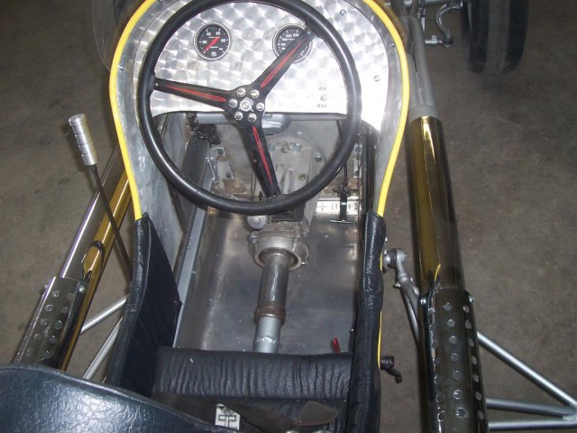

    Most of the throttle peddals and brake pedals (If they had one) were directly mounted to the motor plate. Regarding the old rail midgets most were hand brake levers on one side or the other mounted to the frame rails on the outside of the cowl. This was a drivers call and it they had a brake peddle it would have been a mid to late 40's frame or updated earler frame. I have had both, left hand lever and brake peddle.

    my midget has a hand brake on it already (manual brake), thanks for the info on the throttle pedal, I have an old spoon pedal I'd like to use I am just curious as to the mounting of it? coming off the frame rail or motor plate is not an issue I can do that.
    what I don't understand is the orientation of the pedal, should it be up and down since your foot is more parallel to the floor or angled like a conventional throttle. Seems to me that would be uncomfortable to have to pivot your foot off your heel while sitting flat foot in a midget?
    i tried to make a crude drawing of what i mean-
