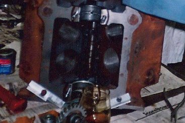

  1. Paul, The IN/Out box you have will work with the V860.
    28dryer is correct. Most of the V860 Got the back of the block cut os about 2 or 3 inch.
    We used to cut the block in a large band saw and then face it square to the crankshaft in the mill. After that was done we would drill and tap 6 bolts in the lip of the block to attach it to a ¼ thick motor plate. The top two block bolts usually needed to have a piece welded in to get enough material to drill and tap.
    Once the plate was bolted to the shortened block the In/out box would bolt to the plate. The crankshaft drive that you have needs to be made to the correct length to engage the shift coupler allowing slight end play when in gear. Then the main shaft of the Box needs to be machined to fit your pilot bushing and cut to length. This entire fitment needs to be done with the block shortened. Crank/ motor plate and in/out box installed.
    I believe that you could do the same work to the shaft and coupler without shortening the block. My only concerns would be the Long coupler hanging of the back of the Crankshaft and the overall length of the engine /In/out box.
    I have attached a couple of photos to give a idea of how much we cut off the blocks.

    thanks for the good info, I was originally going to attempt to cut my block but then changed my mind to try to keep the full bell? Now I am considering doing the cut after reading this info. I fell I can make the extending the drive coupler but I too am un-easy about the length it will be hanging out. My buddy owns a machine shop, I used to work there too doing head work for him. He hasn't seen a v8-60 since he was an apprentise machinist in the 70's! He mills modern blocks so I guess this old iron won't be to much problem? I guess I have to do some numbers crunching before I attack this problem. my biggest handicap is visualizing what needs to be done then being able to tell my machinist buddy what we are gonna do (with confidence?), I unfortunatly don't have anyone local that knows about this stuff that I can lean on or learn from in person so I count on my internet friends to help guide me LOL!
    thanks,
    Paul

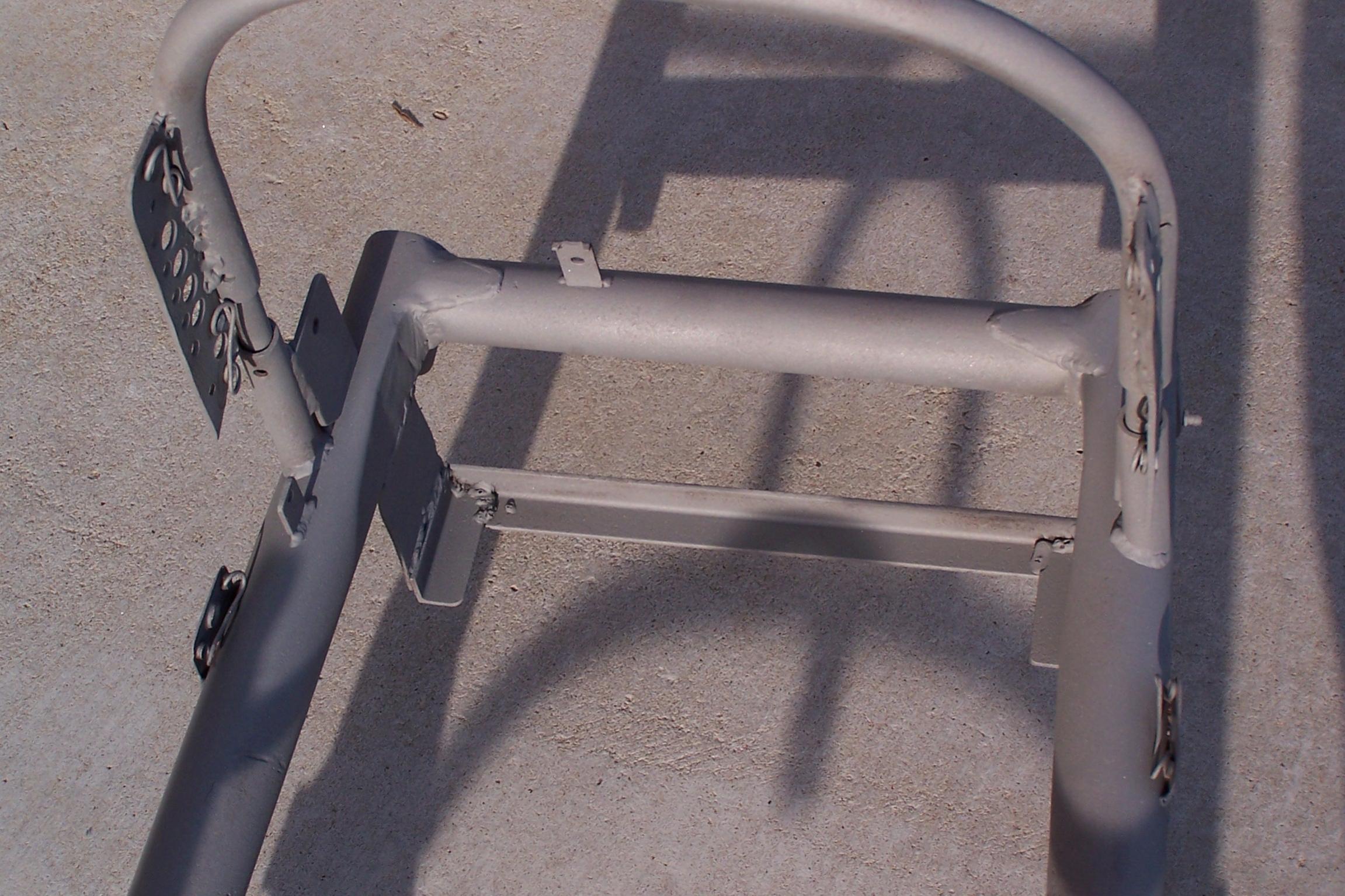

    I have this Kurtis Kraft Chassis #231. I have a interested party that requested I try to identify it. So here I am. #231 is the second known number of a 1948 KK Midget,<O:p></O:p>
    The frame is a four bar parallel bar car and from what I can tell from the original engine mounts and dry sump tank mount it could have been Offy powered at one time. There are a few very distinct modifications. I was hoping someone might recognize them and be able to give some clues on where this frame has been. One is the seat side support to keep the driver in the car, I have never seen one welded to the frame Another one is the rather heavy duty radiator cradle. <O:p></O:p>
    If anyone can be of any help I appreciate it. <O:p></O:p>
    Thanks. Mike<O:p></O:p>

    These were made of 4130 aircraft tubing. The frames were gas welded and the factory welds were indeed very nice on early post-war Kurtis frames. I wish I could say that of the add on welds. The person who stick welded those makes my welding look pretty.
    One thing I noticed is the boxy looking reinforcement on the kick ups. Does the frame show evidence of damage in the area of the fish mouths? For those unfamiliar with Kurtis frames, the kick ups were three piece affairs with the tubing deeply fish mouthed to give more area for welding these critical joints.
    Doc

    well I cut down & re-tapped the hairpins to fit to the original radious rod bracket location on my rail frame and was able to mock up the entire car yesterday. I think it looks decent the rods are not as close looking once I got them on the car,before I was just holding them up to the rail by hand and judging the distances.
    on my on goning In/out box situation, I decided to have my buddy (machinist) help me with cutting and milling the bell on the engine to make up my mid-plate mount, that will happen soon? I am trying to figure out how to use the torque tube bell that was on my midget with my new I/O box. when I went to fit them up together I found although they were both 4 bolt mounts they didn't match up? what t-tube bell would bolt to the I/O box did they have there own special mount for the tube. how can I make this work or what do I need to change?
    Paul

    As with most race car frames that are 60 years old it has had its share of add ons. Most of them have been removed to restore it back to stock configuration.
    The kick ups are nice with no signs of repairs . What you are calling a boxey area is a simple 1/4 flat gusset on end. Welded to the underside the kick up.
    This was a common reiforced area along with supports to the front and rear of the main tubes extending from the lower hoop.

    Thanks for the information. I realize that old cars end up with lots of "improvements". I kind of like the concept of the plate gussets as the age of the cars has to make this a weak area. None of the Kurtis midgets I worked on had anything like that. A couple of them were very old, indeed. I stooged on Red Marley's Drewry's Spl., after Charlie Szkendey bought it. Last I knew it was still running with outlaw groups in the Midwest with a Chevy II in it. I also stooged on Greg Flatow's D&D Heet Offy when Billy Humphreys was driving it.
    One night we we were out at Tradin' Walt Lovett's shop, we did find one thing on a Kurtis kit (or copy) that scared the bejeezus out of us. The frame looked to be well put together and very nice. When we started to strip it to repaint it, we found it was brazed, not welded. Walt built a replica and threw that frame away.
    Doc
