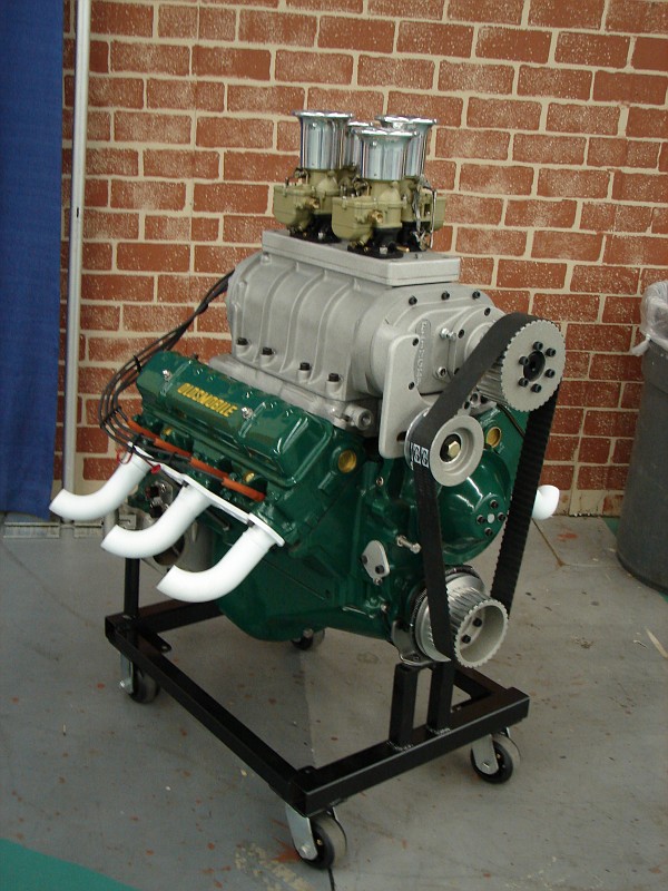

    here's some different views of a couple of the motors shown above
    the green motor isn't a 394 but the drive would be the same
    the one with the Engle sticker on the covers is in the restored Stone Woods Cook Willys

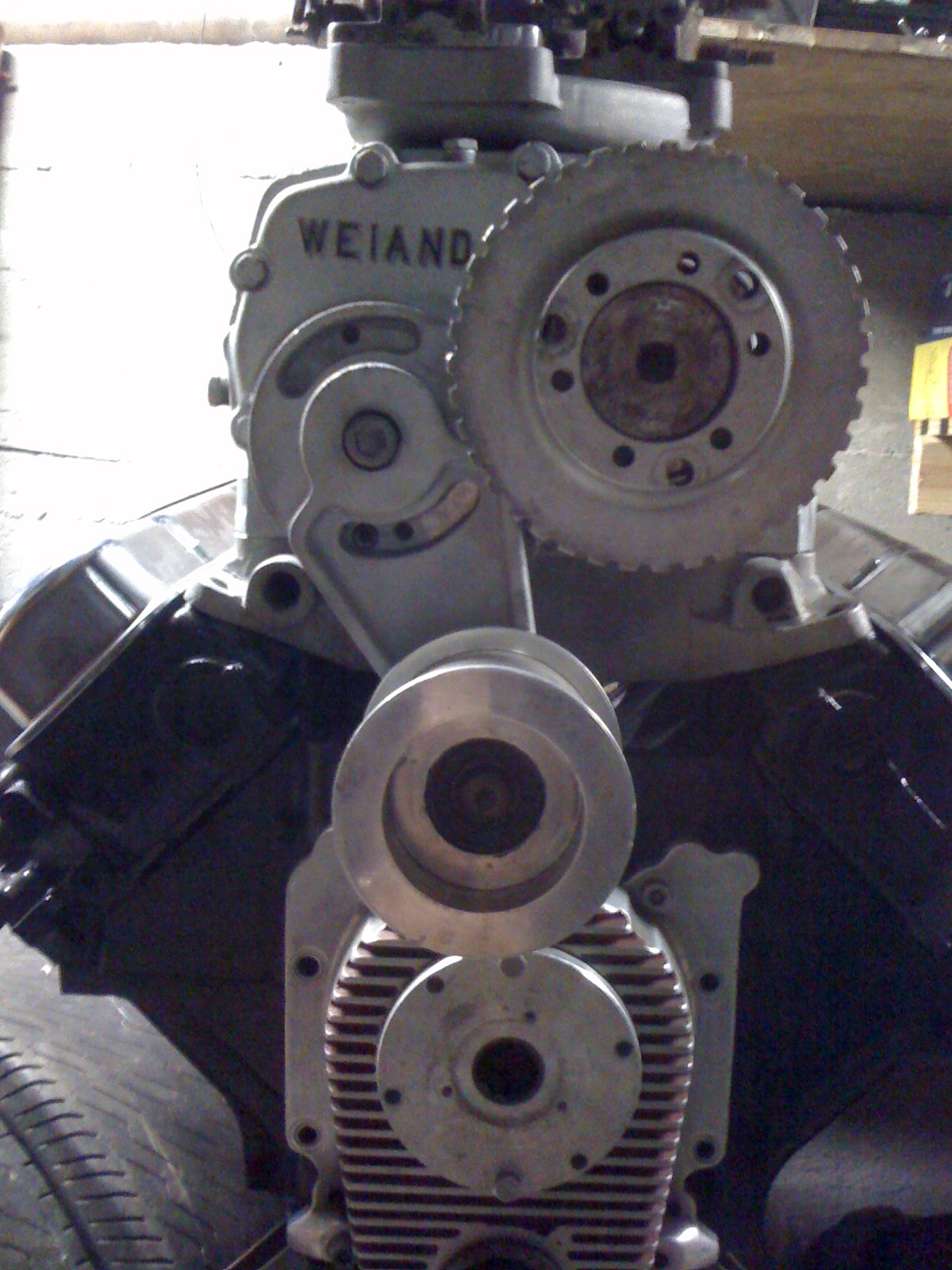

  26. backyardbeliever
    Joined: Sep 15, 2006
    Posts: 299
    backyardbeliever
    Here is my weiand swingarm on my 394 project.
    EVL401 and Deuces like this.
