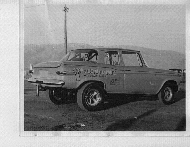

    One thing that has not come up. At the begining of the sixtys Altered ment a coup or sedan. Roadsters ran in Roadster class just like Bonneville today. Fuel roadsters ran in Hot Roadster class. Like B/HR would be B/Hot (Fuel) Roadster. Only around 64 or so that Fremont lumped roadsters and coups togeather in altered. I had a coup and didn't need topless cars in my class. Wasn't to long after that that Brackets came about. And I lost interest.

    This brings up what is Vintage? When I built the coup pictured above nobody had ever heard of a Corvair. We sure wern't using Corvair steering. Same thing for my roadster. It's Franklin streering. Dustin (above) is talking about 20 years after I gave up on drags and decided it was salt or nothing. For me that would never be vintage. For Dustin maybe I am stone age.
