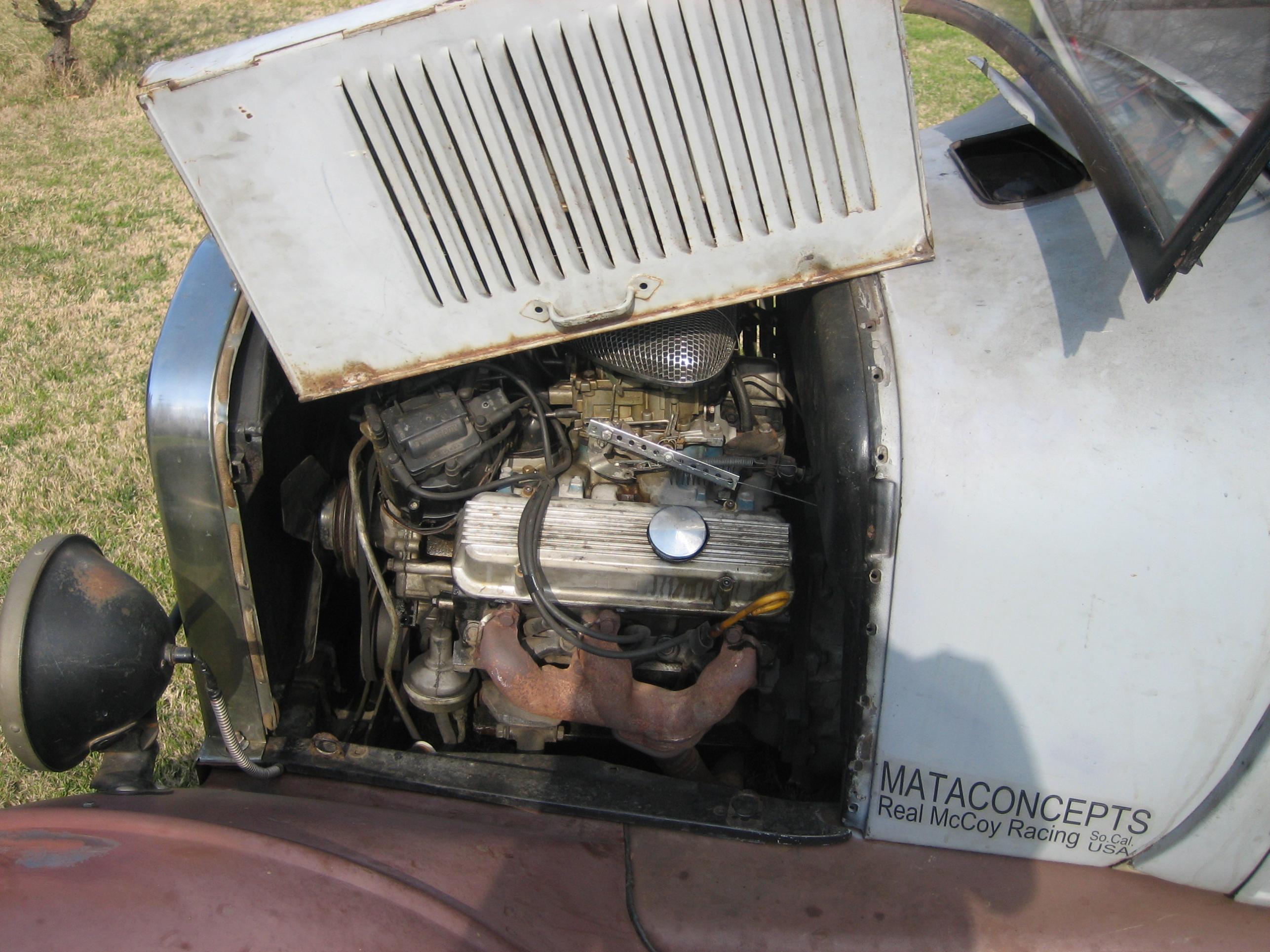

  27. MATACONCEPTS
    Joined: Aug 7, 2009
    Posts: 2,069
    MATACONCEPTS
    Another V6 option. Buick factory Regal Qjet intake manifold/ hei/ 1 wire alt. GM

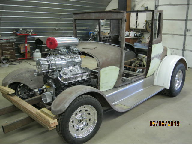

  28. 69firebird
    Joined: Dec 31, 2011
    Posts: 6
    69firebird
    from Wisconsin
    Here is a 1926 Model T coupe I am building. Do not plan to chop. I am putting a 454 bbc with an 8-71 blower in it. I did build the frame out of 2x4 steel, Jaguar rear end shortened 5 3/4" and a Heights pinched front end.
