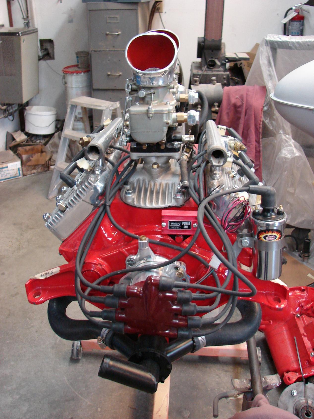

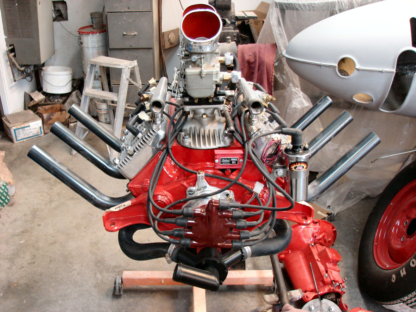

  15. If you can find and afford the piecces to build a 60 like this, you'll have plenty of power to pull a T around.

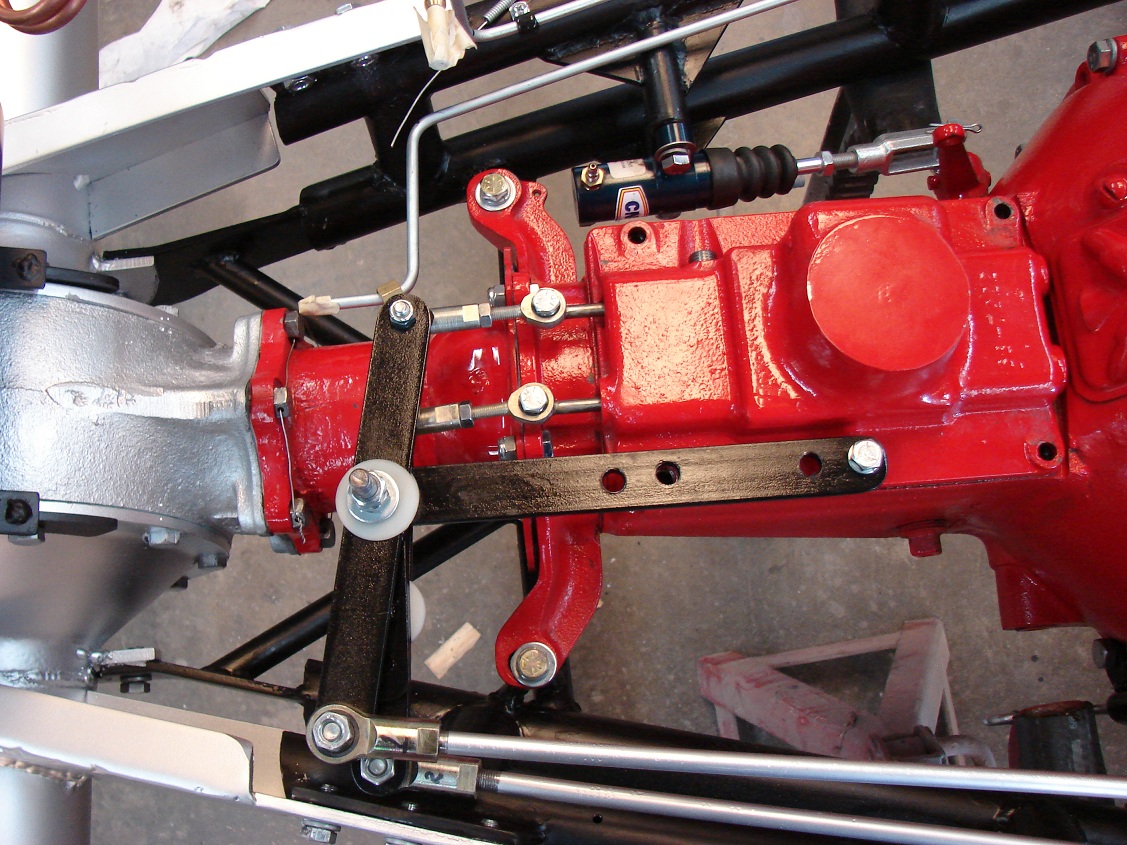

    wow, love the trans shift linkage it's TITs!
