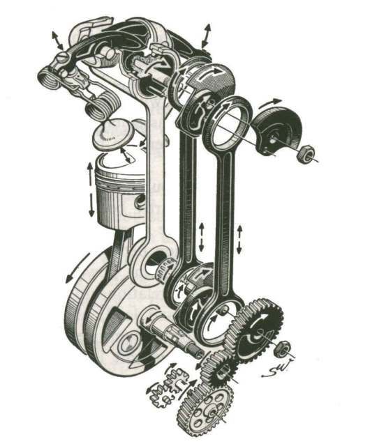

    Related is the triple-eccentric cam drive used on NSU motorcycle engines:

  22. Rusty O'Toole
    Joined: Sep 17, 2006
    Posts: 9,659
    Rusty O'Toole
    Thanks Ned, that is the motorcycle I was thinking of. Notice that the eccentric drive does rotate in complete circles. The eccentrics are not 180 apart.
    There are only 2 drivers, the 3d rod is a distance piece to keep the bearing a constant distance apart in spite of heat expansion.
    Bentley dealt with the expansion problem with stacks of washers. They were bolted together loosely and oil took up the spaces in between while allowing the rod to grow longer or shorter as necessary.
    You wouldn't need any expansion compensation in a steering box.
    I still think it would be best to design a proper steering mechanism, second best would be chain, 3d best would be a 3 gear drive, eccentrics would come last.
