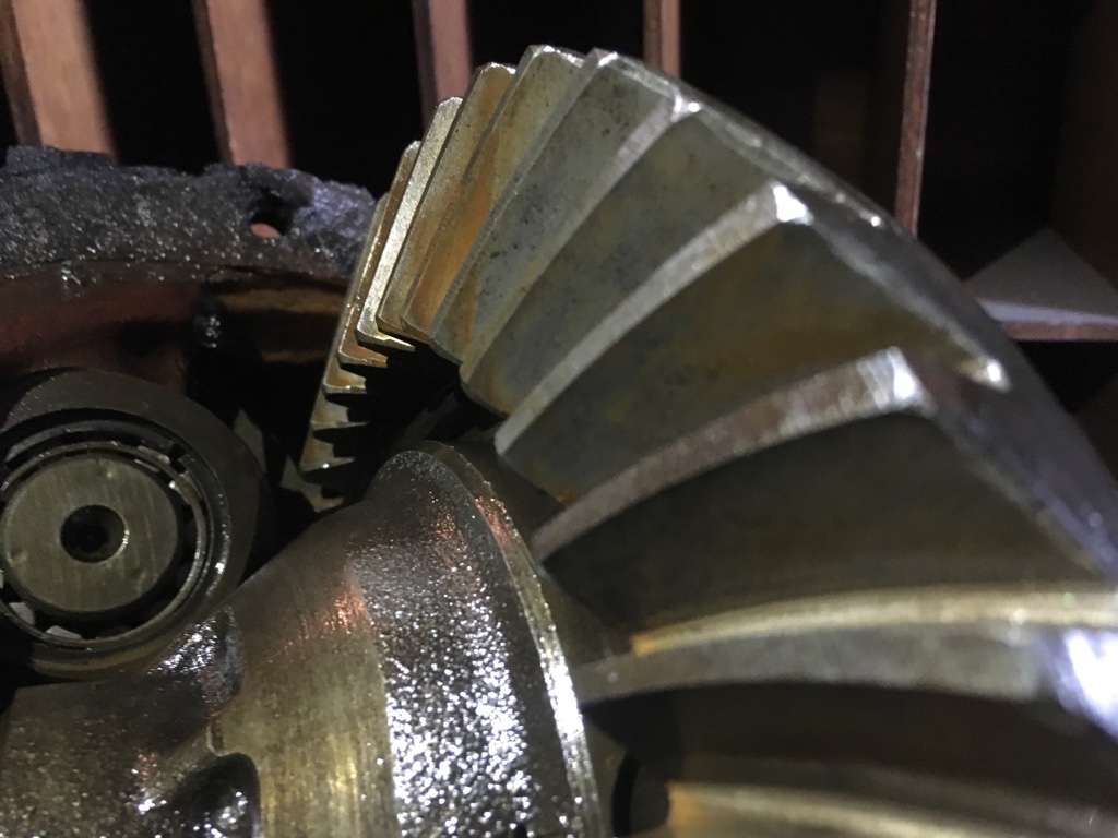

    My buddy is an electric motor mechanic and he brought over his dial indicator. We measured three different teeth around the ring and two were at .008 and one was .009.

    ZakBradshaw
  15. squirrel
    Joined: Sep 23, 2004
    Posts: 56,085
    squirrel
    If that's the worst of the rust, it should be ok.

    I just half assed clean the gear up to take the measurements. The red on the gear is old fluid and was caked on everything. I didn't see any rust on it. The inside of the housing is a little rusty but mostly caked with the same brownish red gunk. What is the best way to check the bearings in the third member to see if they are still good?

    The pinion support Bearing inside the housing needs to be checked very well for Cracks. Ford used Several Different housings depending on Application and year's. This was a weak Spot in the lighter 9"s.
  23. In the second pic, you can get a good look at the pinion support bearing. It has rollers missing.
    I would be extremely suspicious of the gearset being noisy, even after a correct reassembly.
    I was taught by the experienced gear builders I worked with, that if you disassemble an older unit, let's say to replace the bearings, the odds of getting it back together exactly the same is lessened, and most likely it will noisy. The combined experience of those 4 pro gear builders is over 100 years.
