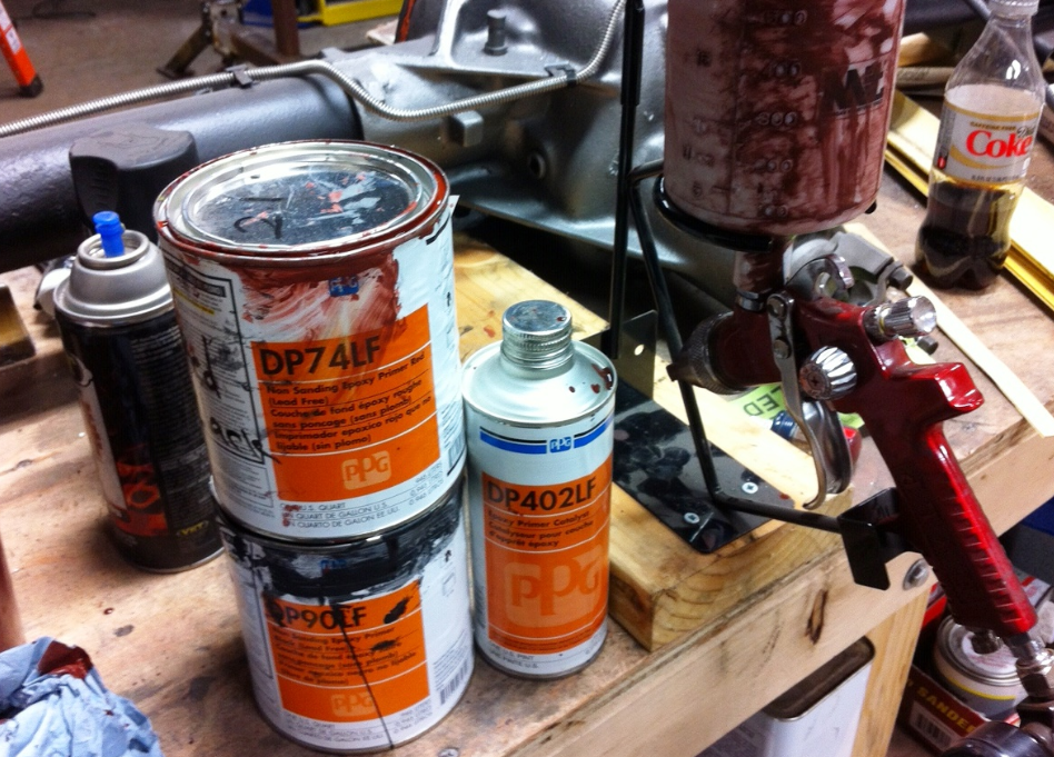

    I use this stuff on the bottoms of 2nd gen F bodies to mimic the factory GM color. I mix 50/50 DP90 black and DP74 red PPG catalyzed epoxy primer.
    Beats the hell out of pink!

  18. Bandit Billy
    Joined: Sep 16, 2014
    Posts: 7,043
    Bandit Billy
    I think I thinned it too much and put too many coats on :cool:. I ended up killing it a bit that last time with some VHT semi flat clear which is in that rattle bomb in the first picture.
