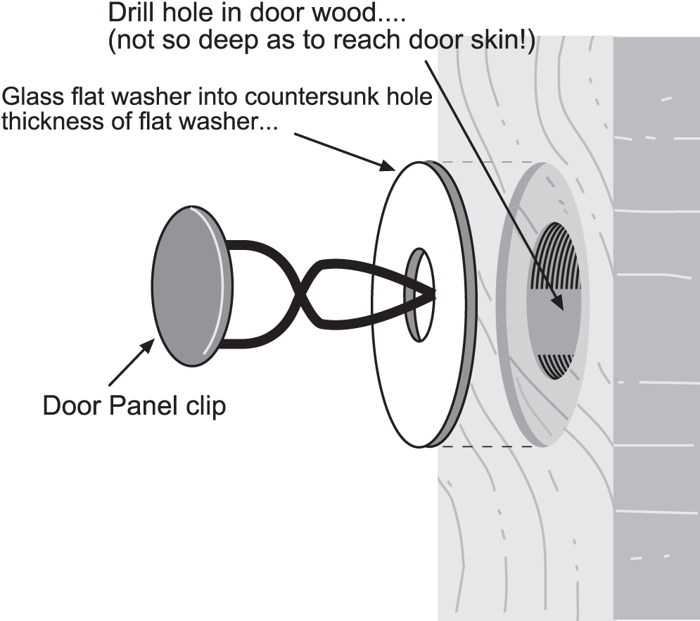

    Here's one way I've used in the past, hope the diagram is clear enough. With a cardboard shape of your door panel, mark where you want to attach it to the wood frame with a pencil or sharpie, transfer it to the wood with an awl or nail. Carefully drill a hole deep enough not to interfere with a door panel clip depth. Then, either glass a flat washer over the hole or countersink it the thickness and diameter of the washer.

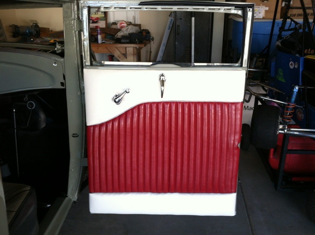

    I used clips but they didn't mount very flush. But looked good. The self tapping chrome screws look traditional.. ImageUploadedByH.A.M.B.1389328931.634981.jpg the above was clips. Bit had a gap between the panel and the door. I don't have a pic of the self tapping screws but they looked just fine...
